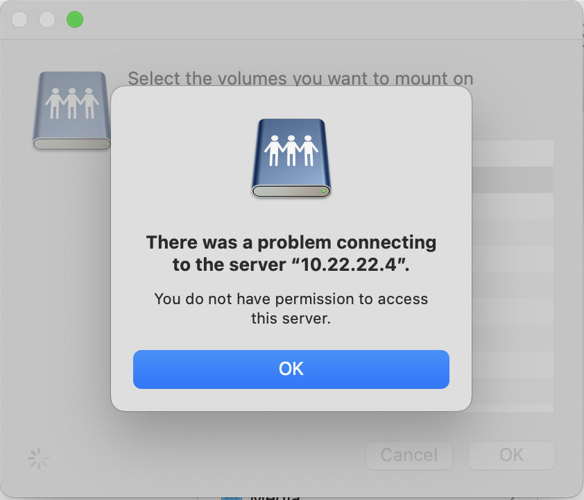

Sorry if this is addressed in one of the other postings about permissions, but I've tried reading through those and troubleshooting, but am still stuck.
I've upgraded from 6.9.2. to 6.10.3. As far as I can tell, everything as far as Dockers (PLEX, PiHole, etc) works fine. It's just accessing the files themselves through the server on the network (using SMB either through Mac OS 12.4 Monterey or Windows 10). I disconnect as the user, reconnect, same error.
Each time I get "You do not have permissions to access this server". I've stopped and restarted SMB. I've run Tools > Docker Safe New Permissions. I've run Tools > New Permissions.
If I downgrade to 6.9.2, I'm back in business and everything works fine, but I'd sure like to use some of the 6.10.x features.
As far as I can tell my directories/ files have the correct owners/ permissions... but I am at a loss.
Attached are a few screenshots and diagnostic files (Tools > Diagnostics).
Thank you in advance.

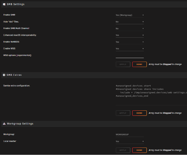

This is what comes back in the SMB settings, but I suspect that it should be there:
#unassigned_devices_start
#Unassigned devices share includes
   include = /tmp/unassigned.devices/smb-settings.conf
#unassigned_devices_end

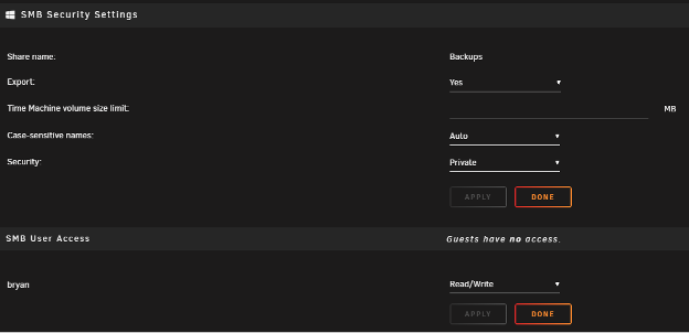

and I tried it with the shares set to both "Public" and "Private" (with user my username having read/ write permissions granted when set to private; I even tried the user 'root'); all the same result unfortunately indicating that I don't have access. Similar results on my Mac.
When I subsequently downgrade to 6.9.2, it all comes back up and I have access again without making any changes to the shares.

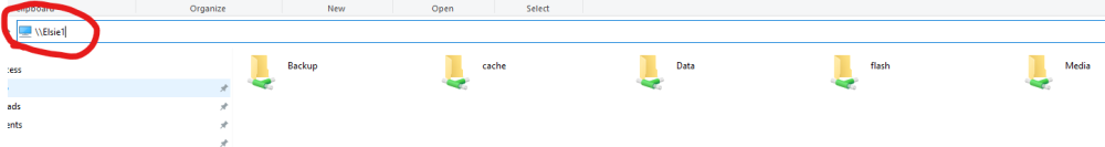

Try using    \\Server-Name    in the Address panel of Windows Explorer  (Windows 10's File Manager)  and see if you get an error message from that.  What should be displayed is all of the SMB Shares that you have exported as folders.  It probably will look something like this:
I have circled where to put the Server-Name.   Appearance may vary depending on the Windows Explorer View settings...

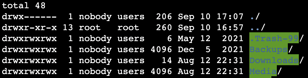

JorgeB, here's the output you requested
To compare:
This is 6.9.2. (6.10.3 is below)
root@bryNAS:~# ls -la /mnt/user
total 40
drwx------  1 nobody users  206 Sep 21 09:48 ./
drwxr-xr-x 13 root   root   260 Sep 21 09:38 ../
drwxrwxrwx  1 nobody users    6 May 12  2021 .Trash-99/
drwxrwxrwx  1 nobody users 4096 Dec  5  2021 Backups/
drwxrwxrwx  1 nobody users   14 Aug 12 22:31 Downloads/
drwxrwxrwx  1 nobody users   36 Aug 12 22:31 Media/
drwxrwxrwx  1 nobody users    6 May 12  2021 Sync/
drwxrwxrwx  1 nobody users   48 Jul  7  2021 Time\ Machine\ unRAID/
drwxrwxrwx  1 nobody users   28 Aug 26  2021 Téléchargements/
drwxrwxrwx  1 nobody users 1018 Jul 27 16:50 appdata/
-rw-r--r--  1 nobody users  619 Mar 15  2020 cert.pem
-rw-------  1 nobody users 4089 Mar 15  2020 config.xml
-rw-------  1 nobody users   33 Mar 15  2020 csrftokens.txt
drwxrwxrwx  1 nobody users  216 Jan 10  2022 domains/
-rw-r--r--  1 nobody users  623 Mar 15  2020 https-cert.pem
-rw-------  1 nobody users  288 Mar 15  2020 https-key.pem
drwxrwxrwx  1 nobody users    6 May 12  2021 index-v0.14.0.db/
drwxrwxrwx  1 nobody users 4096 Dec 25  2021 isos/
-rw-------  1 nobody users  288 Mar 15  2020 key.pem
drwxrwx---  1 nobody users  166 Sep  6  2021 nextcloud/
drwxrwxrwx  1 nobody users   48 Jul  6  2021 system/
root@bryNAS:~#
This is 6.10.3
total 40
drwxr-xr-x 13 root   root   260 Sep 21 15:25 ../
root@bryNAS:~#

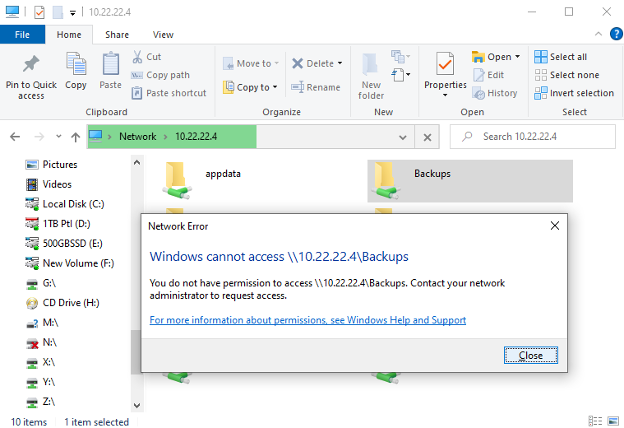

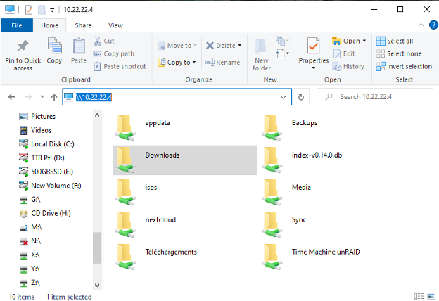

I then go through explorer on Windows 10 and put in the server address as \\10.22.22.4
Which brings up all the shares that are 'exported'; mainly I've been playing around with Backups and Downloads (and then Flash when it was exported as SMB as we previously discussed, which was accessible).
Now, trying to select to go into Backups I get this:
I double checked my WORKGROUP settings and it appears to be correct:
In addition, between all of these attempts to get in, I've rebooted both my unRAID server as well as my Windows machine, re-ran the "net use * /delete" command, and lastly have tried toggling between Public and Private (each with the net use command as well as reboots for good measure).
Scratching my head over this one.

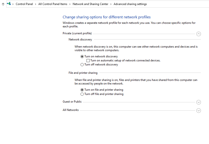

On that Win10 PC, open up the following and lets see what your settings are:
Note that the network profile is set to private.  Make sure your computer is set to private and the "Turn on network discovery" radio button is selected.  If the current profile is not "Private",  see here for how to switch it:
      https://www.groovypost.com/howto/change-network-profile-public-private-windows-10/

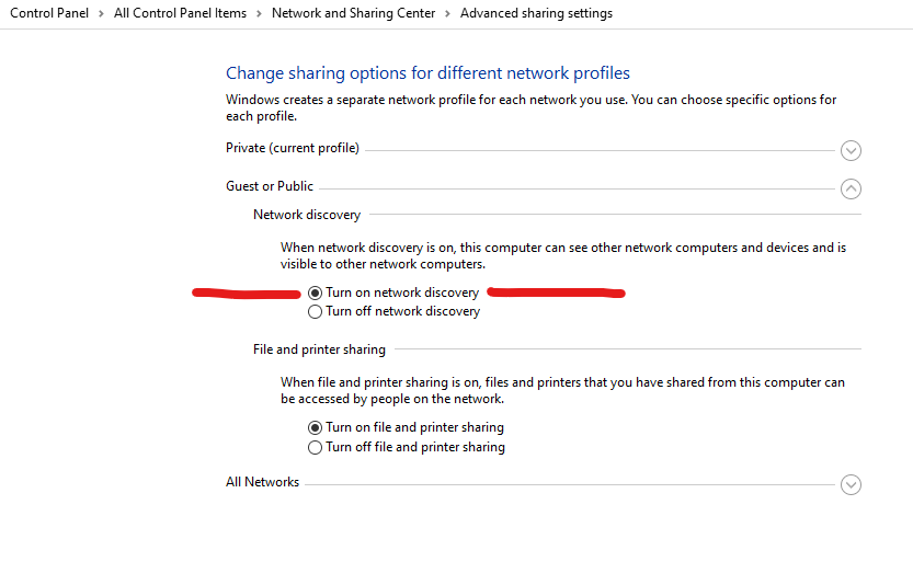

to connect with a Public or guest account, I believe you have to make changes here:
/mnt/user permissions are wrong, don't ask me why they work with v6.9, but they are still wrong, type
chmod 777 /mnt/user
reboot and try again.
chmod 777 /mnt/user
@JorgeB, GREAT catch!  IF I remember how permissions work on directories that should fix it.
As to the question why 6.9.2 worked when 6.10.3:
  • 6.9.2 has   samba: verson 4.12.14
  • 6.10.3 has   samba: version 4.15.7
I would guess that one of the CVE that were incorporated had something to do with tightening up the access to the file system.  (I never have quite figured out how the permissions applied to the various SMB users work with the underlying Linux permissions.)
Edited by Frank1940
I just triple checked. That's exactly how mine sits. ;) Nice Catch
ls -ls
0 drwxrwxrwx  1 nobody users 173 Sep 20 11:14 user/
GASP.
That was it!
Thank you thank you thank you both for stepping through this with me and thank you for your great catch and instructions, JorgeB!
Went from this:
total 40
drwx------  1 nobody users  206 Sep 21 16:46 ./
drwxr-xr-x 13 root   root   260 Sep 21 16:36 ../
to this...
total 40
drwxrwxrwx  1 nobody users  206 Sep 21 16:46 ./
drwxr-xr-x 13 root   root   260 Sep 21 17:19 ../
