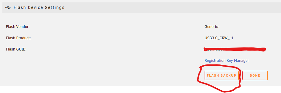

EDIT:  For @LakersFan and others who are making a backup of the Flash Drive to the array.   This is like storing the combination to a safe inside of the safe.  When you need it, you can't get to it.   Make a backup of your flash drive by clicking on the 'Flash" on the Main tab
Then click on "FLASH BACKUP"
This will save the backup to your PC (or whatever device you are accessing the GUI from).

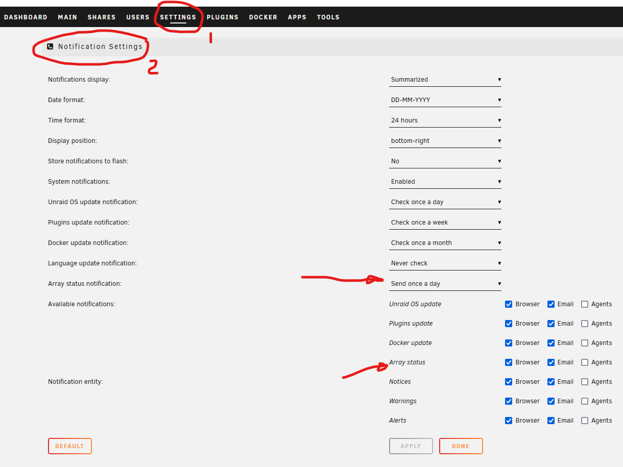

Where would I find the array status report?
In a notification sent to another device.  It is setup here:
