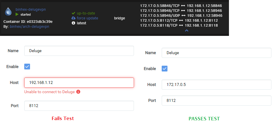

Sonarr / Radarr stopped working with the HOST IP of deluge and jackett last year.  (from what i experienced and read on the forum)
i used to have sonarr/radarr setup referencing deluge and jacket with 192.168.1.## (host IP of the server) for 4 years.  it worked great until it didnt. it stopped working last year when sonarr/radarr changed to V3
following instructions on this forum, i had to change the IP address to the internal IP addresses to get sonarr/radarr talking to deluge and jackett again.
if you know of a better way, i would love to know.

so i tried moving Deluge and Jackett  over to the proxynet network, so all 4 dockers that need to interact are on the same custom network "proxynet"
went into sonarr/radarr and tried chaning the IP address to HOST ip. 192.168.1.12
does not work.
