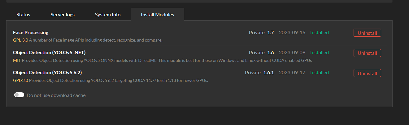

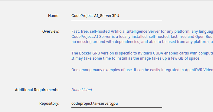

October 6, 2025Oct 6 On 10/5/2025 at 8:08 AM, crusemm said:These are the only options I have. How do i get the others?What repo are you using?I am using this one as I have a Tesla P4. Post a pic of your container config to compare.
October 8, 2025Oct 8 2 minutes ago, crusemm said:I loaded the :cuda12_2 repo and that solved my problem thank you.Oh nice. Have fun with it
December 30, 2025Dec 30 Hello, I am trying to use CodeProject.AI_ServerGPU in combination with AgentDVR. Unfortunately, this causes issues with my Nvidia 5060 TI (I guess, I am running into this issue: https://github.com/codeproject/CodeProject.AI-Server/issues/337).Is there any chance to get the CodeProject.AI_ServerGPU from the Unraid CA running with my GPU? In case that's not possible: I have found this post https://ipcamtalk.com/threads/new-codeproject-ai-object-detection-yolo11-net-module.83611/page-3#post-957933 and there seems to exist a solution for linux on docker hub that is working with the 5060 ti: https://hub.docker.com/r/mikelud/ai-server/tags . Is it (easily) possible to use that docker in unraid instead of the CodeProject.AI_ServerGPU from the CA?Thank you for your help!
