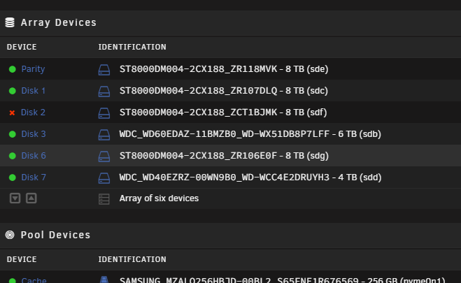

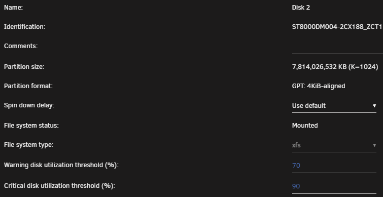

September 13, 20224 yr Ive spun it up, down and stopped the array, restarted it... Swapped the SATA cable, etc. Cant seem to figure out whats going on. When I first discovered the issue, I couldnt perform a SMART check, so I shut everything down, swapped the SATA cable, it seems to respond now (I can perform a SMART check, etc) but it will not re-integrate with the array. It also shows mounted under the file system status.. Im lost. Something weird seems to be going on with this that Im missing. Any help would be greatly appreciated. System and SMART logs are attached. gaia-syslog-20220913-2028.zip gaia-smart-20220913-1329.zip

September 13, 20224 yr Community Expert Several things about your configuration that are less than ideal. We can discuss after you get your array stable. Disable Docker in Settings until then. Emulated disk2 is mounted as you indicated. Nothing assigned as disks 4,5, is that correct? Why? Makes me wonder how you got to this point. 26 minutes ago, SVThuh said: Unraid hard crashed Let's try to deal with that before trying to rebuild anything.

September 13, 20224 yr Author 1 minute ago, trurl said: Several things about your configuration that are less than ideal. We can discuss after you get your array stable. Disable Docker in Settings until then. Docker is now disabled. 1 minute ago, trurl said: Emulated disk2 is mounted as you indicated. Nothing assigned as disks 4,5, is that correct? Why? Makes me wonder how you got to this point. I have removed drives over the past year (consolidating with 8tb drives vs the small drives I had in there before. I didn't want to mess with the drive assignments too much in the configurations because I didn't want to mess anything up with the linking to the current shares. 1 minute ago, trurl said: Let's try to deal with that before trying to rebuild anything. I think it was actually a power supply issue. All the fans and HDDs just stopped spinning and the system went dark. Wouldn't restart until the main switch was cycled. Likely my fault for pushing a cable away from a fan while it was on (new config, no side panels yet)
