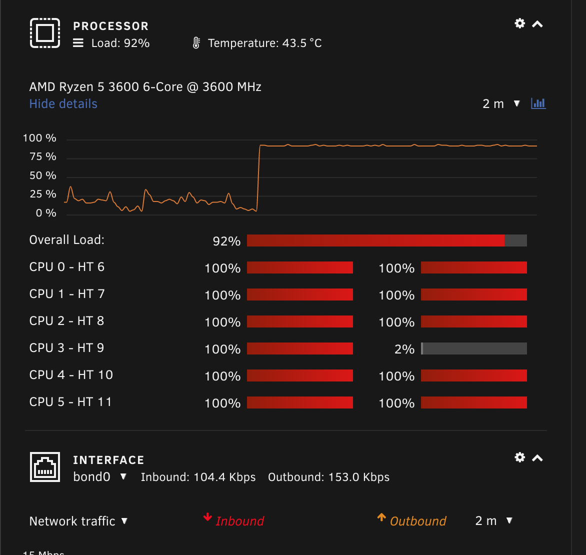

I logged in around 7.45am and noticed my CPU was almost pegged at 100%, I checked my dockers but nothing seemed to be using it, I checked HTOP but in there, HTOP was the highest CPU usage at 30% (I think, I'm not 100% sure how to read HTOP)

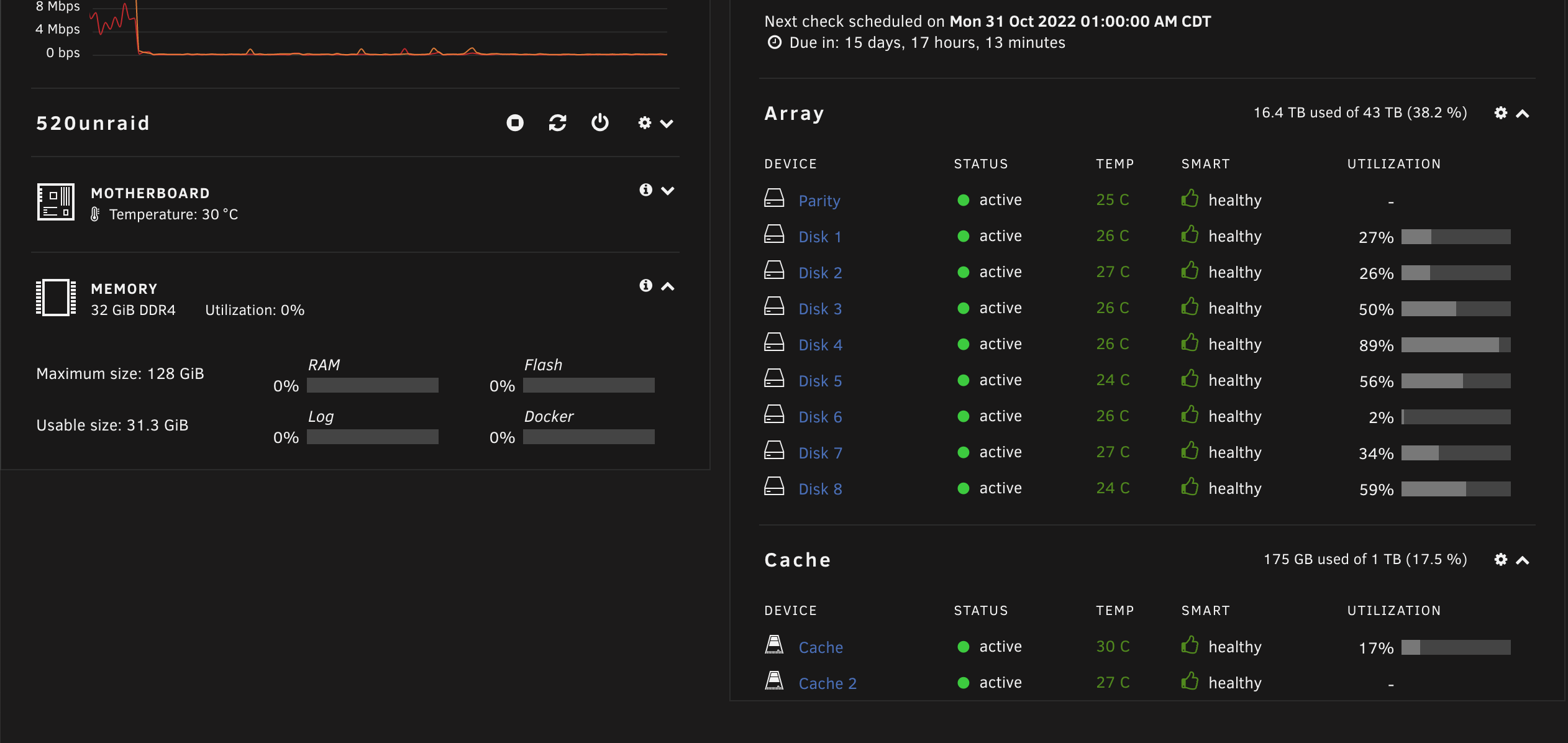

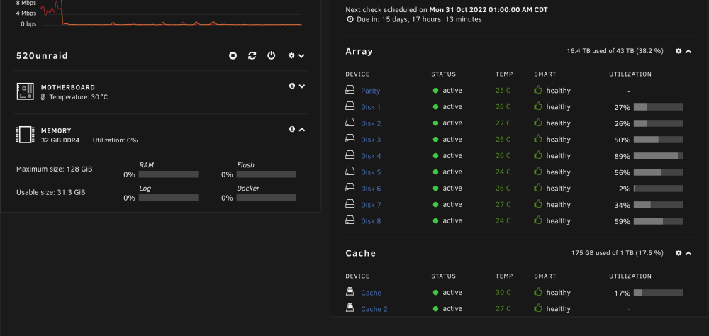

One odd thing I noticed was that my ram utilization was reporting 0gb. Here are a few screenshots.

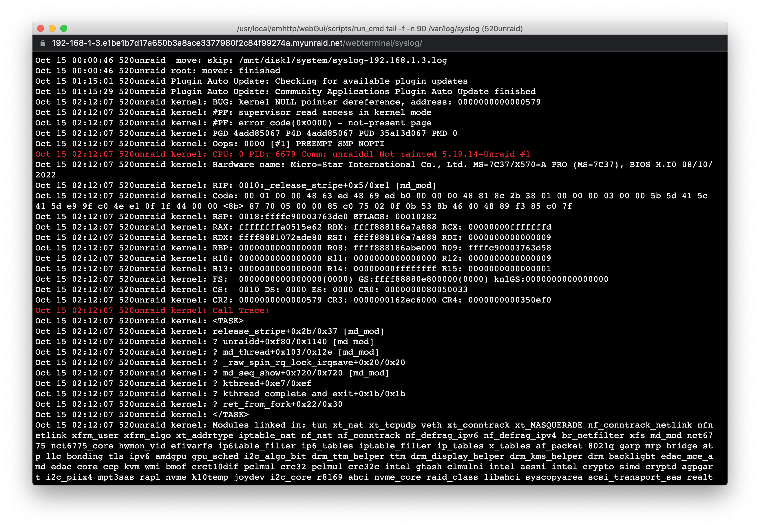

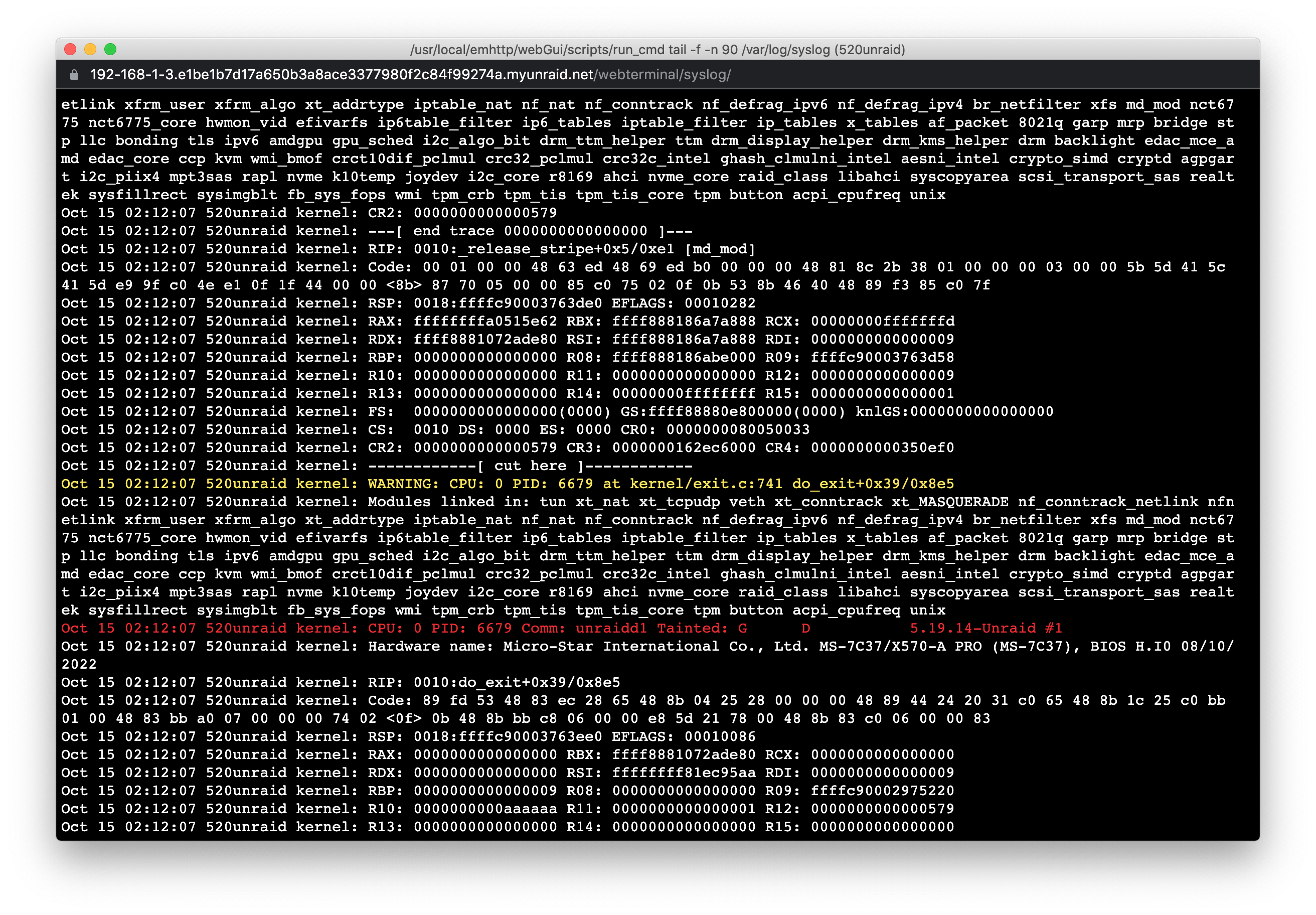

I checked the syslog and this is what I see:
1283806282_ScreenShot2022-10-15at07_48_47.thumb.png.8359dfb88c6cb30507ff17610a5c5773.png795249892_ScreenShot2022-10-15at07_48_53.thumb.png.a6b86a182196f447d36031d6e0edbb8e.png

Screenshots show the Unraid driver crashing, to me that still points to some hardware issue.
