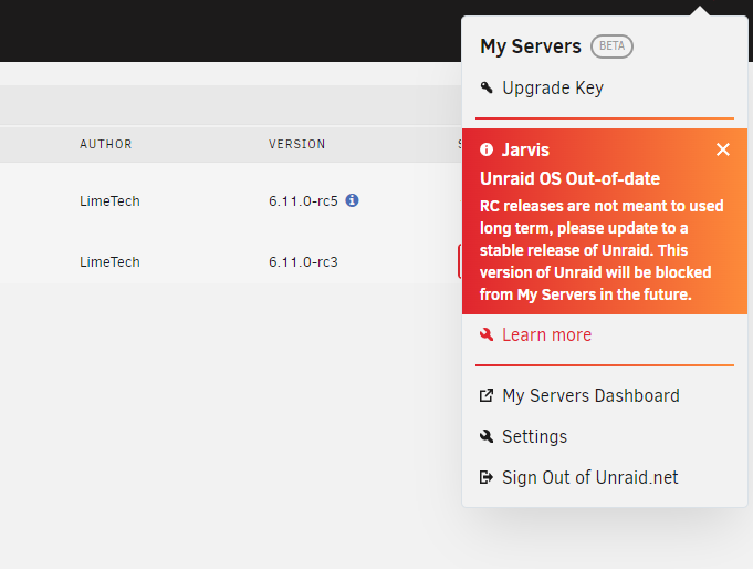

October 6, 20223 yr Really at a loss here - any idea how to prevent this rather annoying message from showing - FYI I have never been out of date, it just started showing for no reason even though I'm on 6.11.X
October 6, 20223 yr 6.11.0 stable has been released for while now. You should update. The message which you're seeing is 100% correct.
October 6, 20223 yr Okay did a reboot and finally 6.11.0 stable is showing as an optional update - before both stable and next releases were showing as "up to date" without an upgrade option - even when manually checking for updates.

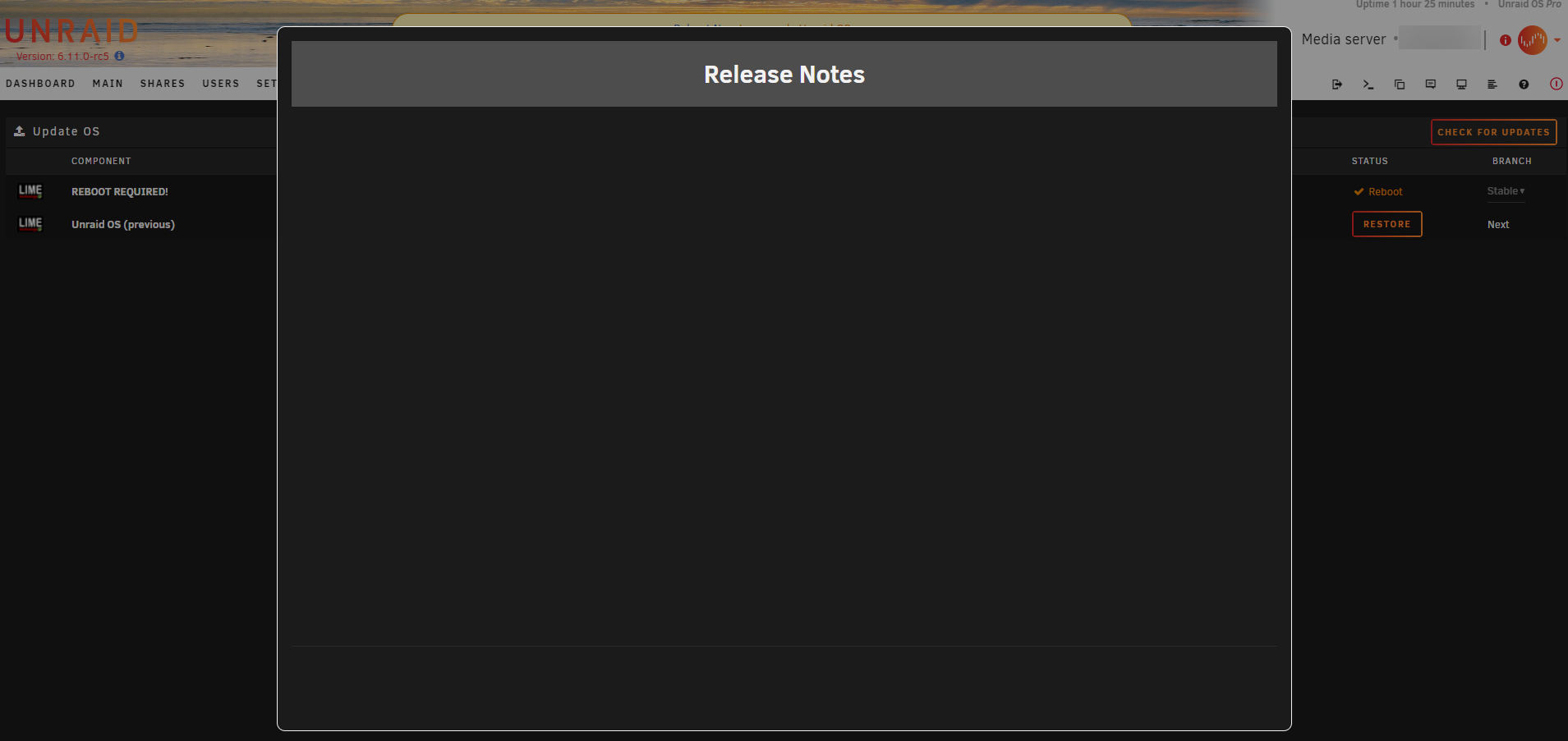

October 7, 20223 yr I have to say I'm not a fan of the way that the available updates are shown. I have been on 6.11.0-rc5 for quite a while as I didn't know the stable 6.11.0 (let alone 6.11.1) had been released. I'm just now updating to 6.11.1 as a result of this warning appearing for MyServers. I've also noticed that Release Notes often won't load for me and I have to refresh the page. Edited October 7, 20223 yr by Naed
October 7, 20223 yr Community Expert 20 minutes ago, Naed said: I've also noticed that Release Notes often won't load for me and I have to refresh the page. This issue should be fixed on v6.11.1
