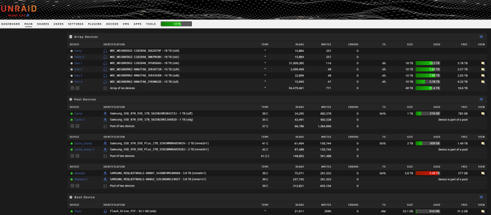

Seem to be connection problems with both cache (sdf,sdg)
How are these connected?

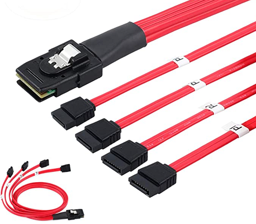

I have a PCIe card installed that has 4 mini SAS connectors with a mini SAS to 4 SATA cable on Each.
I've swapped what connectors and even replaced the SSDs to no avail.
Issue could be power related, also look for an update for the LSI firmware, or try connecting the SSDs to the onboard SATA.

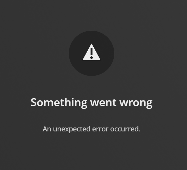

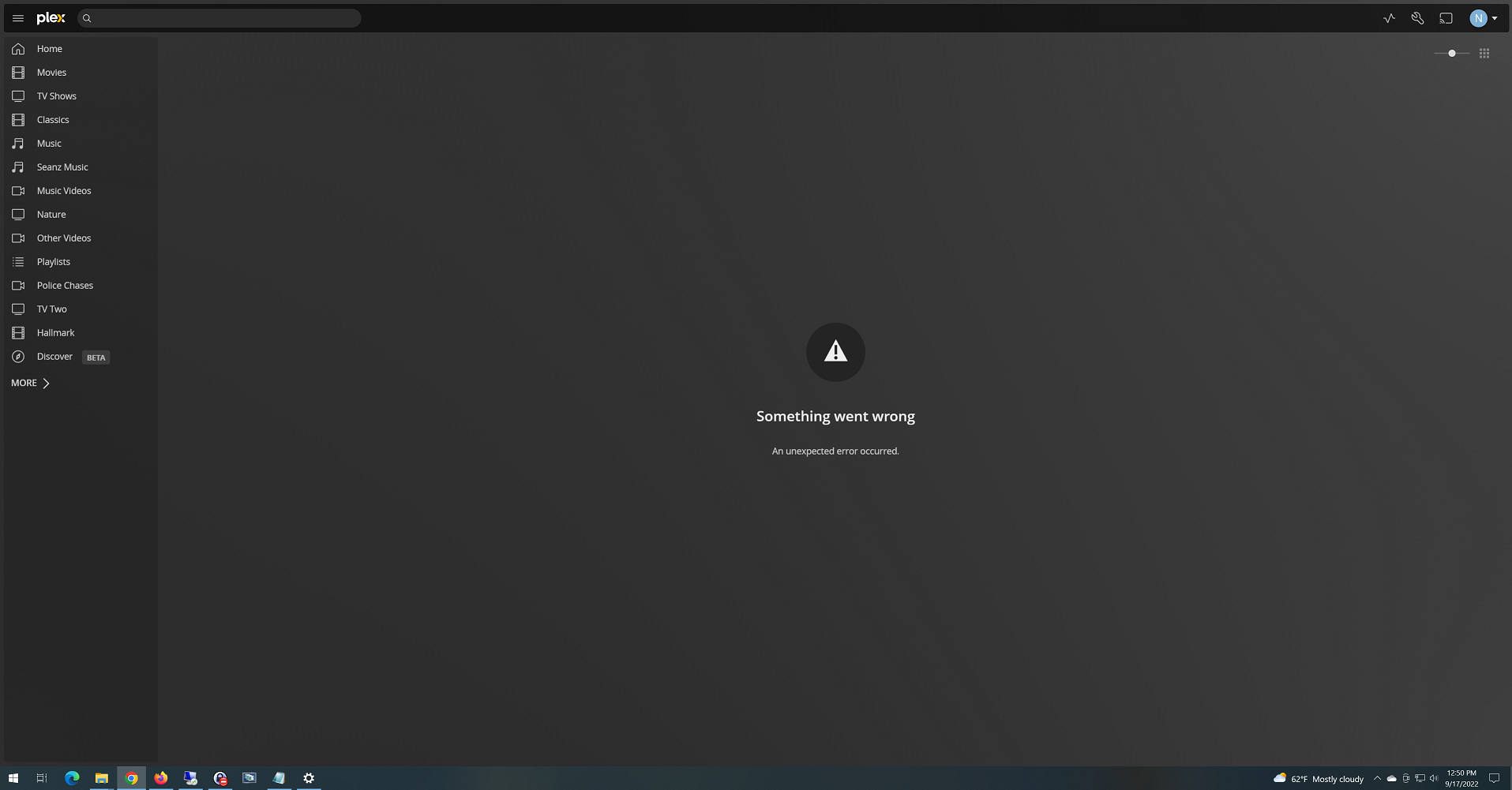

After 12:02 PM Plex will only show this error, the Unraid docker button will hang, fix common problems will hang and the 'reboot' button will not work either.
After a hard reboot the machine will work for until 12:00 PM the next day.

I started a movie this morning at around 11 AM and it quit at 12:02 PM as if on a schedule. I have not reboot yet today so nothing much will work until I do. I did that screen grab at 12:50 PM today.
