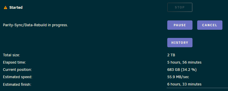

Currently, it's rebuilding the data on the hot spare and having the issue. GUI is rebuilding the drive fine but the CLI says the drive is offline.
Those screenshots show the disk is invalid, because it is rebuilding. Diagnostics show disk7 is mounted and 78% full. In what way is it "offline"?
That's the problem. The GUI and logs all say the drive is perfectly fine and responding but...
