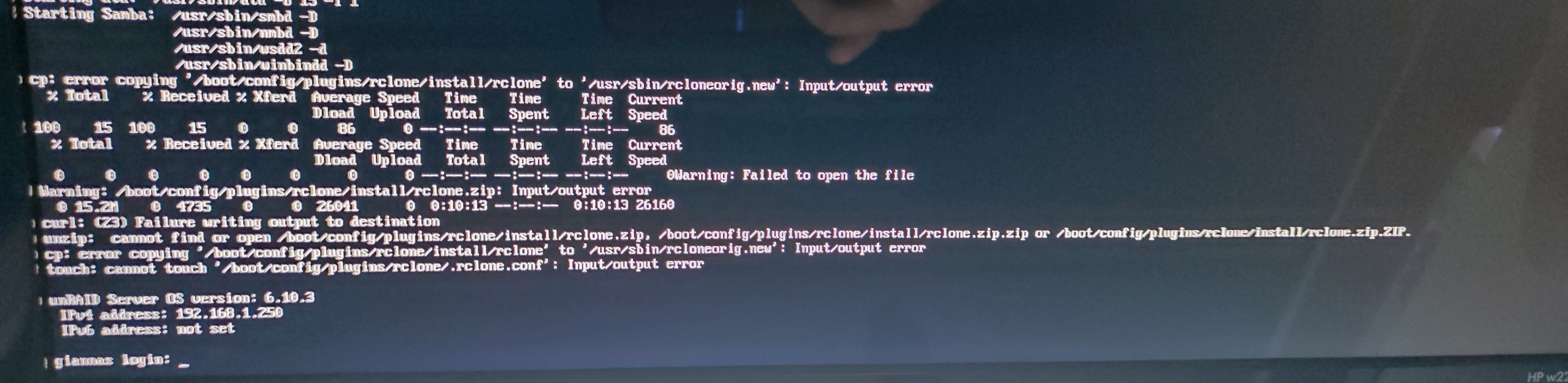

I have prepared a new flash drive with the backup and I have started unraid but I cannot access the gui. The server responds to the ping and by connecting the monitor to the nas I can log in, but typing the ip address in chrome is unreachable.

I rebooted in safe mode without loading the plugins and I can access from chrome, so the problem is caused by some plugins. How do I know which one?

Yes, but if I go to Unraid Web Interface it is not reachable
After several tests removing and replacing the plugins I found the problem and it is caused by rclone. Removing this plugin will start the gui. Is there any way to fix it? or do I have to delete it and redo all the rclone configuration?
Fixed by changing with a new flash drive
