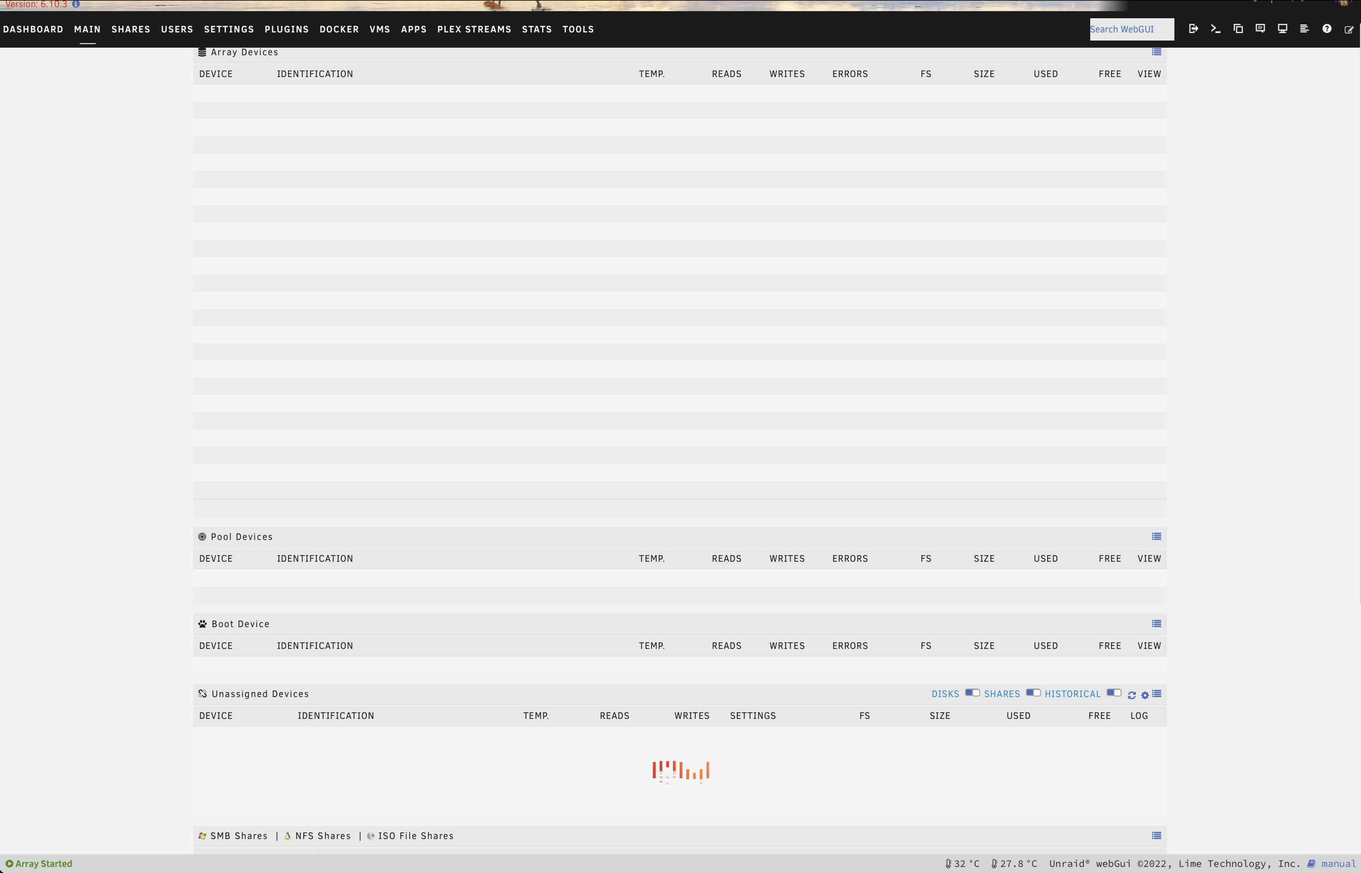

Array & cache is all blank / not loading but share's still work...
Not sure what's happened as was all working fine yesterday.
The main page is just the headings with a large space.
There's no drives showing for anything, array, cache, boot, unassigned etc.
Have rebooted 3-4 times & I tried safe mode as-well and same result.
Have I been hacked or something or is my USB key playing up again?

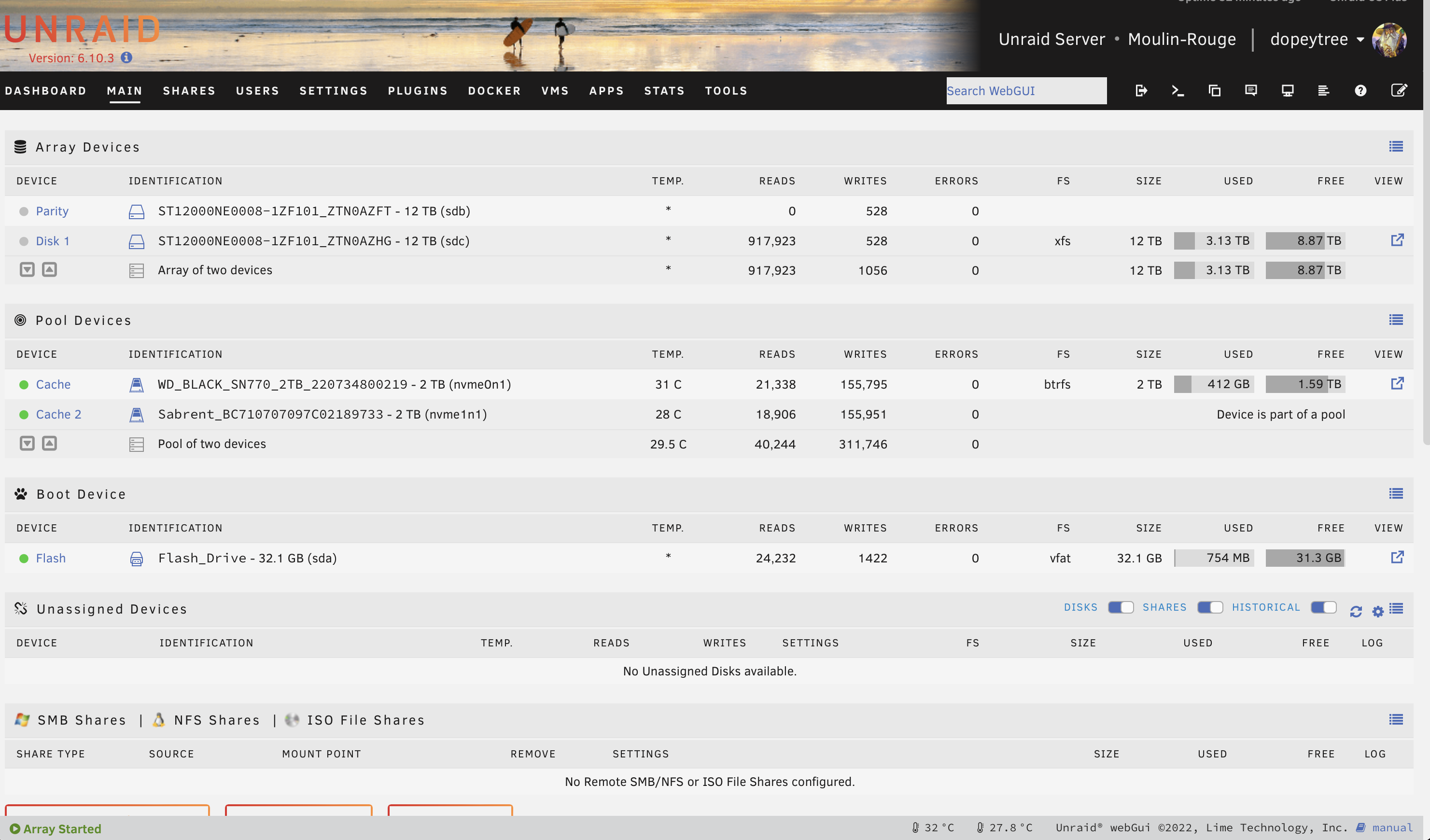

ok... all is ok if I visit the hostname.local
wonder why it suddenly changed as have been accessing all morning on the ip address rather than hostname.

All seems to be ok now so imagining it's something to do with SSL on ip address? if I go to server hostname.local it displays the main array & cache fine...

There were no drives showing see attached photo. Was displaying the unraid 'loading' logo.
192.168.33.2
VS
moulin-rouge.local

Clear browser cache, whitelist server in your adblocker.
Thanks for your speedy help - yes looks like a problem with Nord's threat protection and the self certifying SSL certificate.
Have turned Nord's threat protection to LITE so only works when connected to a nord VPN rather than the blanket catch all.
