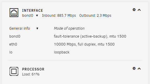

Hitman Posted September 19, 2022 Share Posted September 19, 2022 (edited) I have a Unraid with dual Samsung 850 Cache pool and a mix of 16TB and 18TB drives. I have it running on a VM in ESXi. It has a 10GB NIC and another VM has a 10GB NIC. Moving a single files is only hitting ~600MBits/s. I have a JBOD HBA directly attached within the VM and that's how all HDDs & SSD Are connected. I noticed that the SSDs are not being written to and even if it it direct to the drive, i would expect it to hit higher while using the drive cache, and even writing direct once drive cache is full. I have a old dell with a few externals on it and that can saturate the 1GB link with this same one file to a single external 16TB drive. So I'm confident this should be getting equal or better performance. I've notice that the device is not using cache, but even direct to disk it should be able to handle this as the drive can hit over 120/MBs for a synchronous write. I've noticed that when I use another machine to transfer a single file, which looks to be hitting a different disk, it still only hits 600-700Mbps. Is there something wrong with the setup? unraid-diagnostics-20220918-2320.zip Edited September 19, 2022 by Hitman Add more info. Quote Link to comment

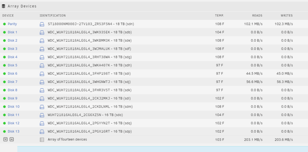

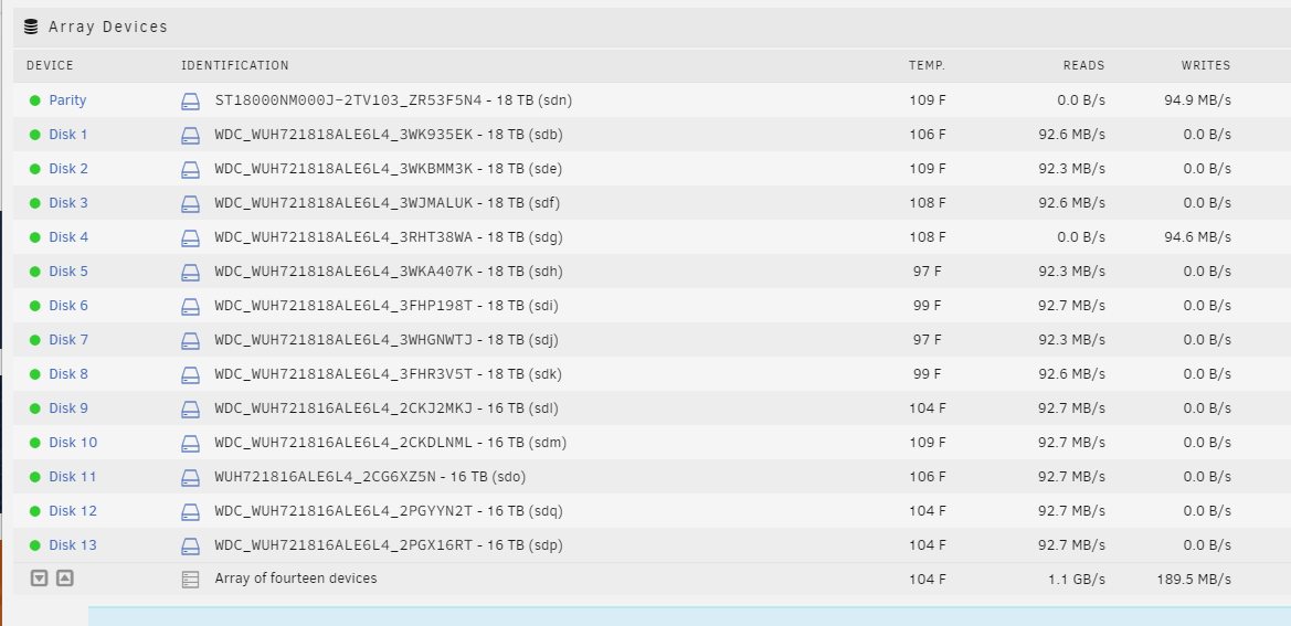

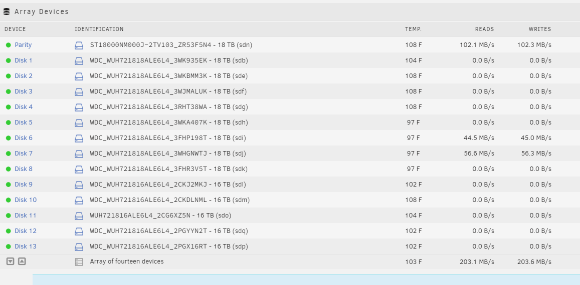

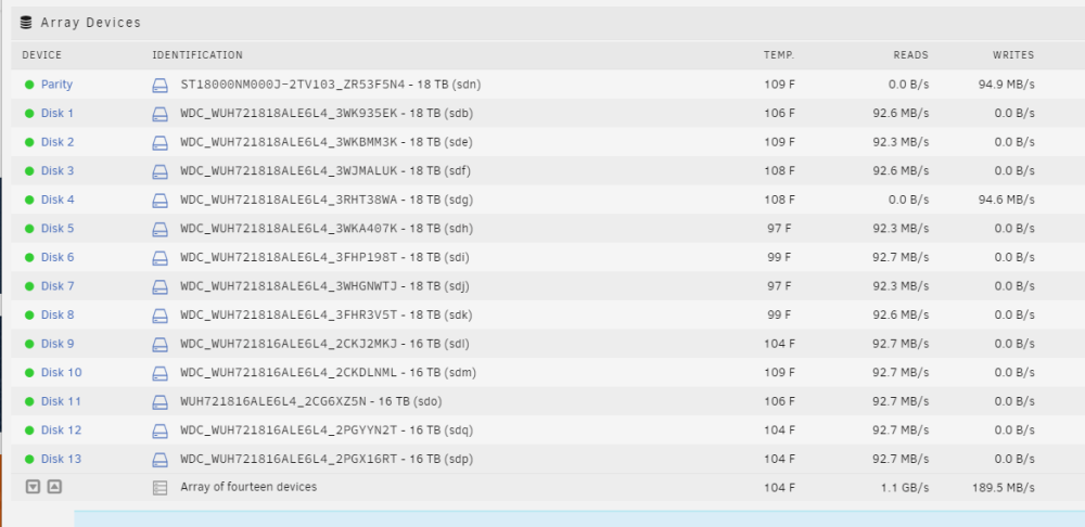

Hitman Posted September 22, 2022 Author Share Posted September 22, 2022 (edited) I will say the community support is great so far. Thanks for all the responses and feedback. Quote This will disable "turbo write", keep writing one file only. I got it. I have two machines writing, so that isn't quite possible. Quote Won't that low for mid-high grade NVMe. What I means is once a SSD fills, wont it write directly to the disk? Quote Also apply to Unraid if you use software RAID by pool / UD. How does this work? Quote This won't happen, array throughput won't over single disk throughput, so for spinner disk usually in 140MB/s - 90MB/s. If you have enough RAM cache, then network transfer to RAM will saturate the 10GNIC ( 1GB/s ) and it will "slowly" writing to array. So If If I give the device more RAM, I will see better speeds? My goal is ~150-200MB/s with two device writing and one device reading. Quote Require all drives be the same size, and if you lose more than parity can recover you have lost it all. I understand, I went with UNRAID to save 16TB, but seeing the speed is making me think I might want to take the hit. Quote Unraid is not RAID, you'll never get same speeds as other solutions that stripe drives, you can have fast pools, array will always be limited by single disk speed. What are Fast Pools? To add, with one write, I still am not hitting the ~145MB/s one drive is capable of: Edited September 22, 2022 by Hitman Quote Link to comment
JorgeB Posted September 22, 2022 Share Posted September 22, 2022 1 hour ago, Hitman said: What are Fast Pools? A pool with one or more SSDs, or just a single fast NVMe device. 1 hour ago, Hitman said: To add, with one write, I still am not hitting the ~145MB/s one drive is capable of: You are virtualizing Unraid, depending on how you are doing it might have a performance impact, or there is a controller bottleneck, post the output of: lspci -d 1000: -vv Quote Link to comment

trurl Posted September 22, 2022 Share Posted September 22, 2022 3 minutes ago, Hitman said: 2 x 250GB SATA drives, RAID 1 for cache pool, but do not have it enabled as the files that are being written are 100GB each. So I don't believe it will keep up with it writing to drives after written to cache. It is impossible to move from fast cache to slow array as fast as you can write to fast cache. Mover is intended for idle time. If you need to write more than cache can hold at one time, don't cache. For the initial data load, you can overcome the parity performance hit by not using parity until the initial load is complete. Quote Link to comment
JorgeB Posted September 22, 2022 Share Posted September 22, 2022 12 minutes ago, Hitman said: LnkSta: Speed 5GT/s (ok), Width x32 (ok) x32 is bogus, likely virtualization related, run the diskspeed docker to test total controller bandwidth. Quote Link to comment
Hitman Posted September 24, 2022 Author Share Posted September 24, 2022 I took the advise of removing parity, as I didn't actually know this was an option. I now have the speed i was hoping for. Thank you! I'm now hitting over 250MB/s on a single transfer to a single drive. Quote Link to comment
JorgeB Posted September 24, 2022 Share Posted September 24, 2022 That's a good ideal for the initial load, and you can transfer to multiple disks without performance loss, assuming multiple source disks, or a fast device/pool, but it also suggests you do have a controller bottleneck. Quote Link to comment
