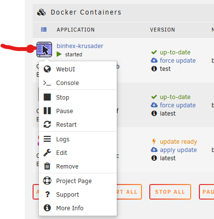

I am going to post up a screenshot of the Krusader Docker to show how to launch its GUI.
You left-click on the icon to open this menu.  Hope this helps!

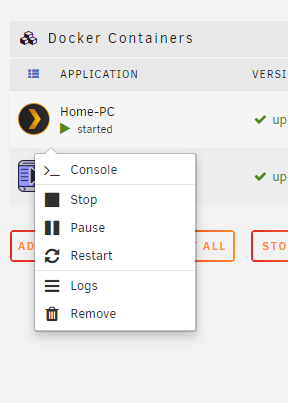

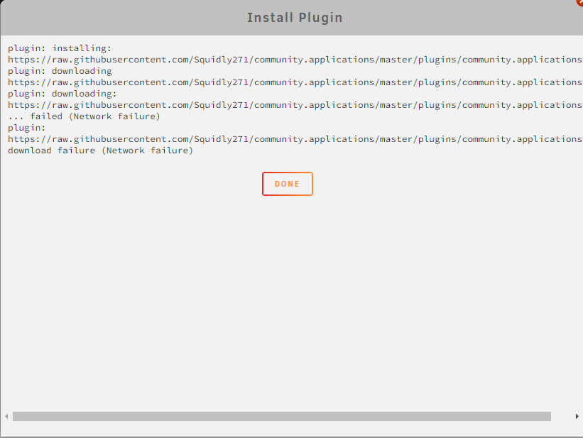

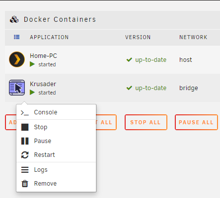

Below are screen shoots of the error I get when trying to install the Community Application, and the menu I see when I left-click on Krusader and Plax
If you look at the screen shot for my hexbin-krusader Docker, you will find a support link  in the dropdown menu.  I don't see one in yours.  If you installed it from the APPS tab, there should be a support link in the listing for the version you are using.  Ask there about where the Krusader GUI is.
If you don't find the answer, you could consider switching to the Docker that I am using...
Open the GUI terminal Window (the    >_   icon on the right of the toolbar).  Type type the following command
ping 8.8.8.8
A Control-C will stop it.  If that works, try this command:
ping cnn.com
IF these two both work, you have full Internet access from your server.  Try the install again.  (It is not summons that these servers will be down.)
The ping did not work.  However, the server is connected to the network and the activity light is flashing
Below is the network status from the dashboard
IPADDR="192.168.68.111"
NETMASK="255.255.224.0"
GATEWAY="192.168.681.1"
Note that the gateway is wrong (x.x.681.x)
