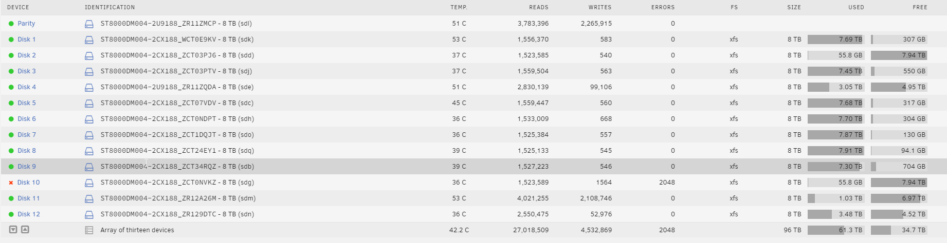

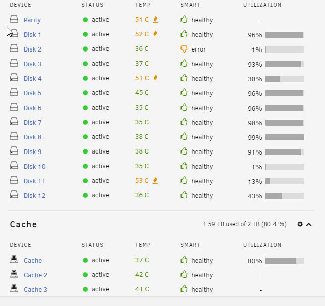

Does that screenshot showing SMART warning on disk2 correspond to the diagnostics you posted earlier, or is that after the (pointless) swap of disks 2 and 10?

What is this latest screenshot about? I thought you were rebuilding parity without disks 2 and 10.
