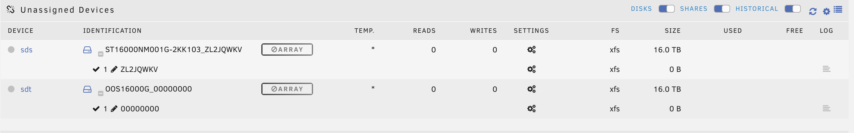

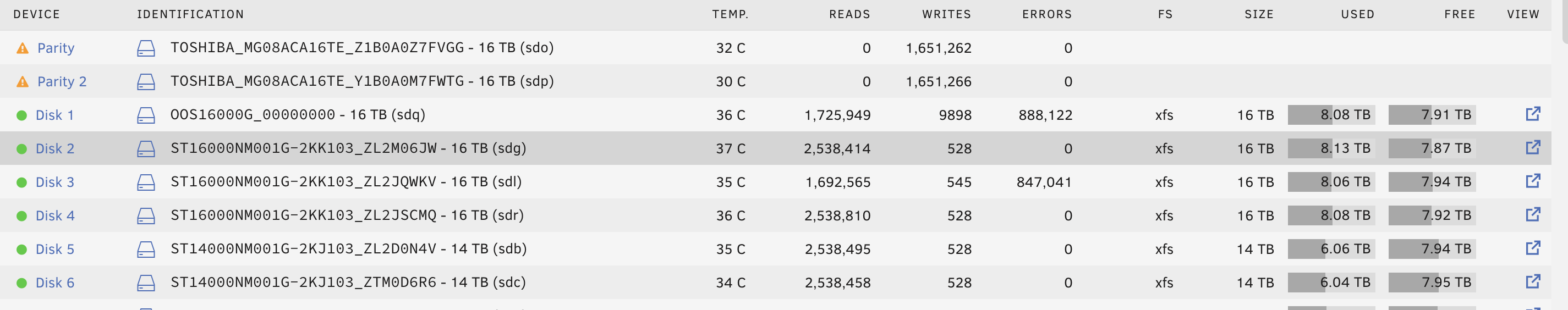

September 21, 20224 yr Hi, Can any one help me?. Suddenly my server shown as disk disabled and the same disk (sdn) is shown in Unassigned with different Name (sds). I just restarted the server then it shows as 2 disks missing and both shown in unassigned. I did new config and assigned the devices as before (Parity drives) and data disks. Now its says errors on the 2 disks . Can some one help me why it happened. netplex-diagnostics-20220921-1628.zip
September 22, 20224 yr Community Expert Might as well cancel parity rebuild. Shutdown, check connections including power. Reboot and post new diagnostics
September 22, 20224 yr Community Expert Looks more like a power/connection issue: Sep 21 16:26:33 NetPlex kernel: pm80xx0:: mpi_sata_completion 2455:IO failed device_id 18439 status 0xf tag 95 Sep 21 16:26:33 NetPlex kernel: pm80xx0:: mpi_sata_completion 2490:SAS Address of IO Failure Drive:50000d1109b27a9e Sep 21 16:26:33 NetPlex kernel: sas: sas_to_ata_err: Saw error 135. What to do? But not familiar with these controllers and their errors.
