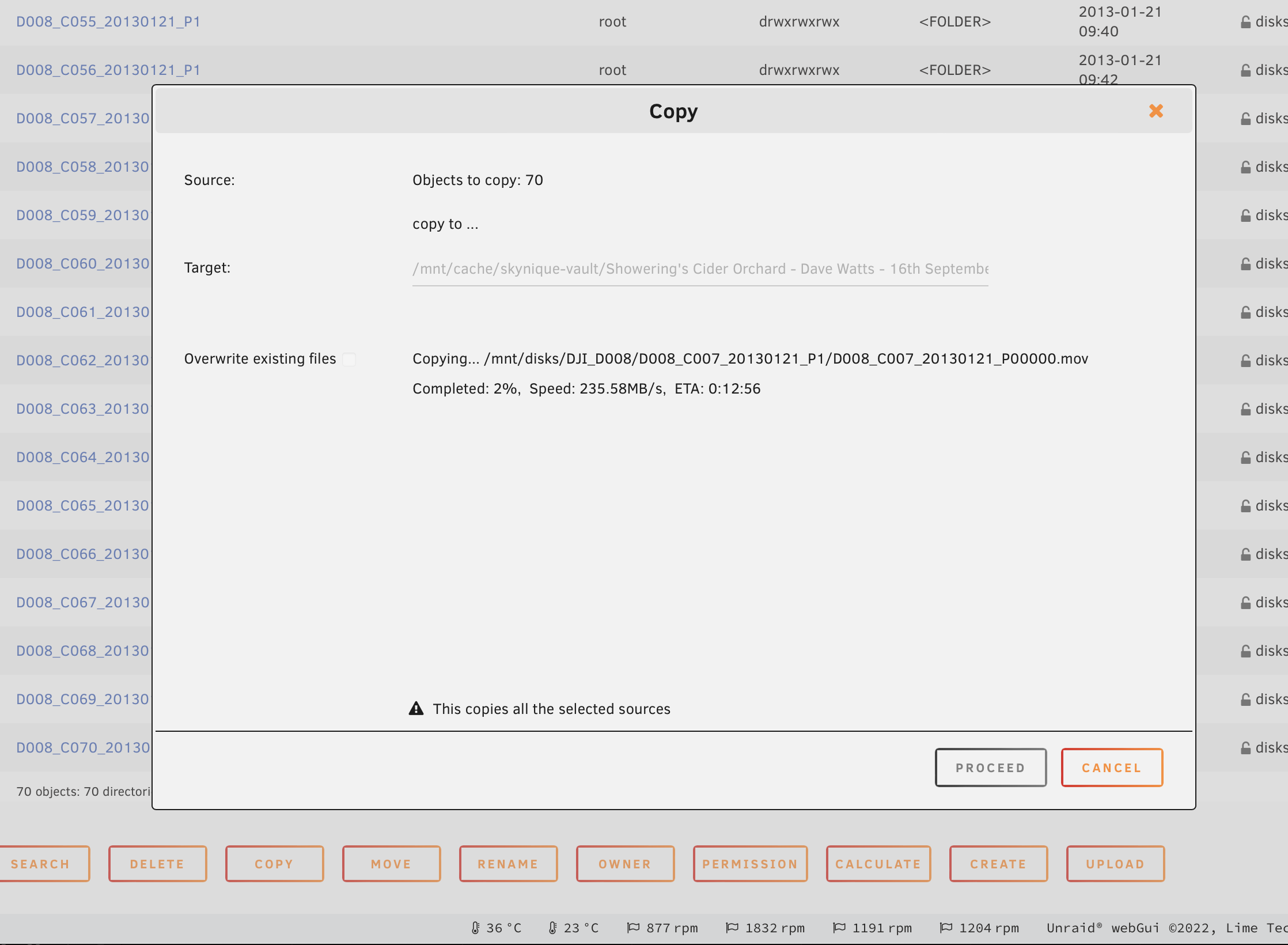

Slows 235MB's - Copying from external usb3.1 NVMe SSD to internal cache drive also NVMe (gen4)
Copying from usb3 external NVMe ssd to cache drive NVMe so why is it so slow?
Is there a problem with speed if you use a cache pool mirror?
I have 1x gen4 NVMe & 1x gen3 NVMe on the motherboard as a cache pool - so the gen4 is mirrored to the gen3.
When I use diskspeed test docker both SSD drives are around 2300MB/s.
It shouldn't be touching the array disks. The share is set to use Cache. But anyway I am copying direct to cache rather than the user share.
The array drives test around 240MB/s down to 108MB/s.
My understanding is USB 3 provides up to 500MB/s read & write. ( Dependent upon encoding overhead )
And USB 3.1 up to 1200 MB/s read & write. ( Dependent upon encoding overhead )
Edited by dopeytree
Solved by Vr2Io

Anyway even internally avoiding USB & Sata seem to get slow copy's even just NVMe to NVMe.. any ideas I should explore?
Update - fixed this slow copy issue by installing the Auto Turbo Write Plugin!!! Everything is now insanely fast.
