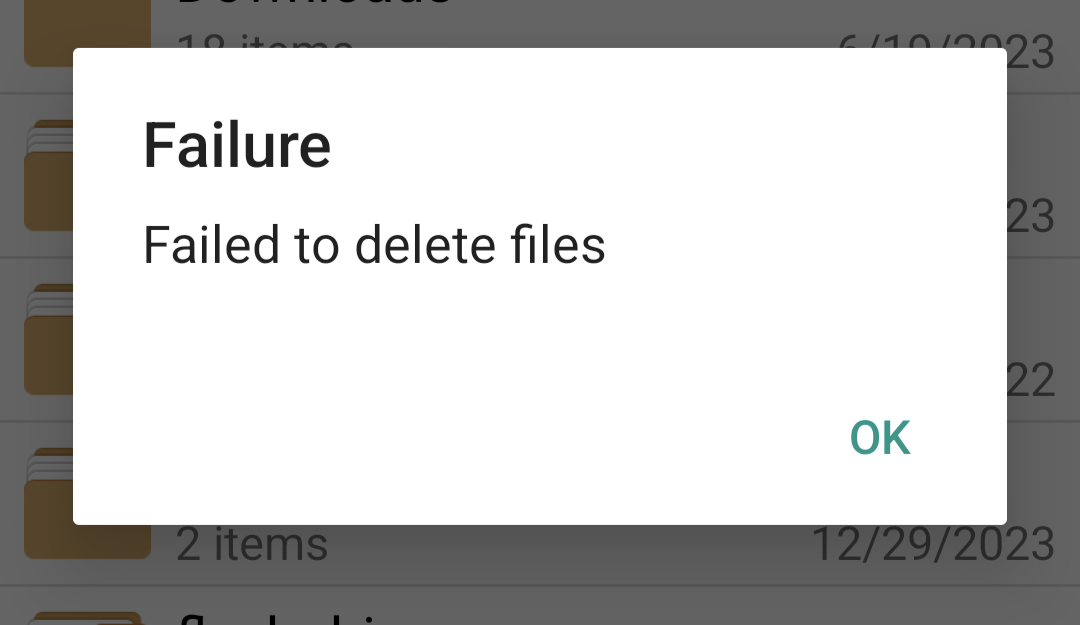

Permission errors in 6.11.0 when deleting files from phone with android file managers

I hate to beat a dead horse, but has Lime Tech resolved this issue yet? I used to use Solid Explorer on Android all the time to manage files on my shares. Every since 6.11, I have also been experiencing failures when deleting directories with files. I've tried all of the file managers listed in this thread and none of them work. I'm sure I'm not the only one with the problem and it would be great if the devs prioritize this.

However, if I comment out the min client directive in the Samba config (essentially enabling SMB1) and set the protocol to SMB1 in Solid Explorer, everything works. Seems to be an issue with SMB2/3 support in Unraid or the Samba version in the apps is incompatible.

Not being able to use file explorer in your phone is very frustrating. I really wish somebody has the solution for it.
This issue started after Samba was updated from 4.16 to 4.17, so likely some Samba change, if you can, use SMB1 since according to a post above it still works, another option if it's possible for your use case, is to use disk shares (or exclusive shares) since those are not affected.
Thanks @JorgeB for quick reply. Yes I am using MiXplorer with SMB1 setting and it works with no issue.

I've done some testing and found out Samba is crashing:
[2024/03/14 09:07:19.329402,  0] ../../source3/smbd/fd_handle.c:39(fd_handle_destructor)
  PANIC: assert failed at ../../source3/smbd/fd_handle.c(39): (fh->fd == -1) || (fh->fd == AT_FDCWD)
[2024/03/14 09:07:19.329435,  0] ../../lib/util/fault.c:178(smb_panic_log)
[2024/03/14 09:07:19.329442,  0] ../../lib/util/fault.c:179(smb_panic_log)
  INTERNAL ERROR: assert failed: (fh->fd == -1) || (fh->fd == AT_FDCWD) in smbd (smbd[192.168.1.) (client [192.168.1.188]) pid 22564 (4.19.5)
[2024/03/14 09:07:19.329447,  0] ../../lib/util/fault.c:186(smb_panic_log)
  If you are running a recent Samba version, and if you think this problem is not yet fixed in the latest versions, please consider reporting this bug, see https://wiki.samba.org/index.php/Bug_Reporting
[2024/03/14 09:07:19.329451,  0] ../../lib/util/fault.c:191(smb_panic_log)
[2024/03/14 09:07:19.329464,  0] ../../lib/util/fault.c:192(smb_panic_log)
  PANIC (pid 22564): assert failed: (fh->fd == -1) || (fh->fd == AT_FDCWD) in 4.19.5
[2024/03/14 09:07:19.329708,  0] ../../lib/util/fault.c:303(log_stack_trace)
This is with samba 4.19.
I seem to have found a get around, but I'm baffled right now about why this works.  Install the recycle bin plugin and be sure it is running.
In my testing it looks like file deletes work.  Deleting directories works but an error is displayed and the Android app does not show the directory as being deleted until closed and re-opened.  The directory delete also crashes samba.  Since the recycle bin plugin is for deleted files through SMB, there is something the recycle bin vfs is doing that prevents the file deletes from failing in this situation.
Because samba is crashing it looks to be an issue that the samba team needs to fix.  At this time, I don't see any way through samba settings we will be able to fix this on the Unraid side.  It could also be an issue with the Android app, but I doubt it.
In doing some research, there is a samba bug here that might solve the issue.
