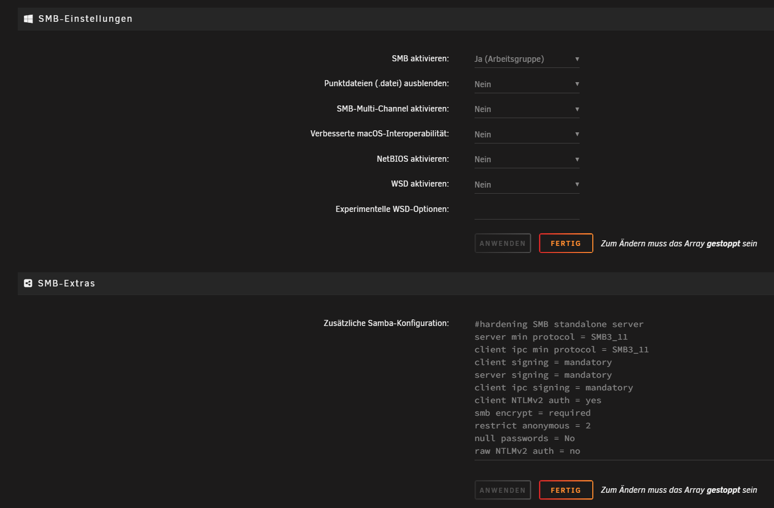

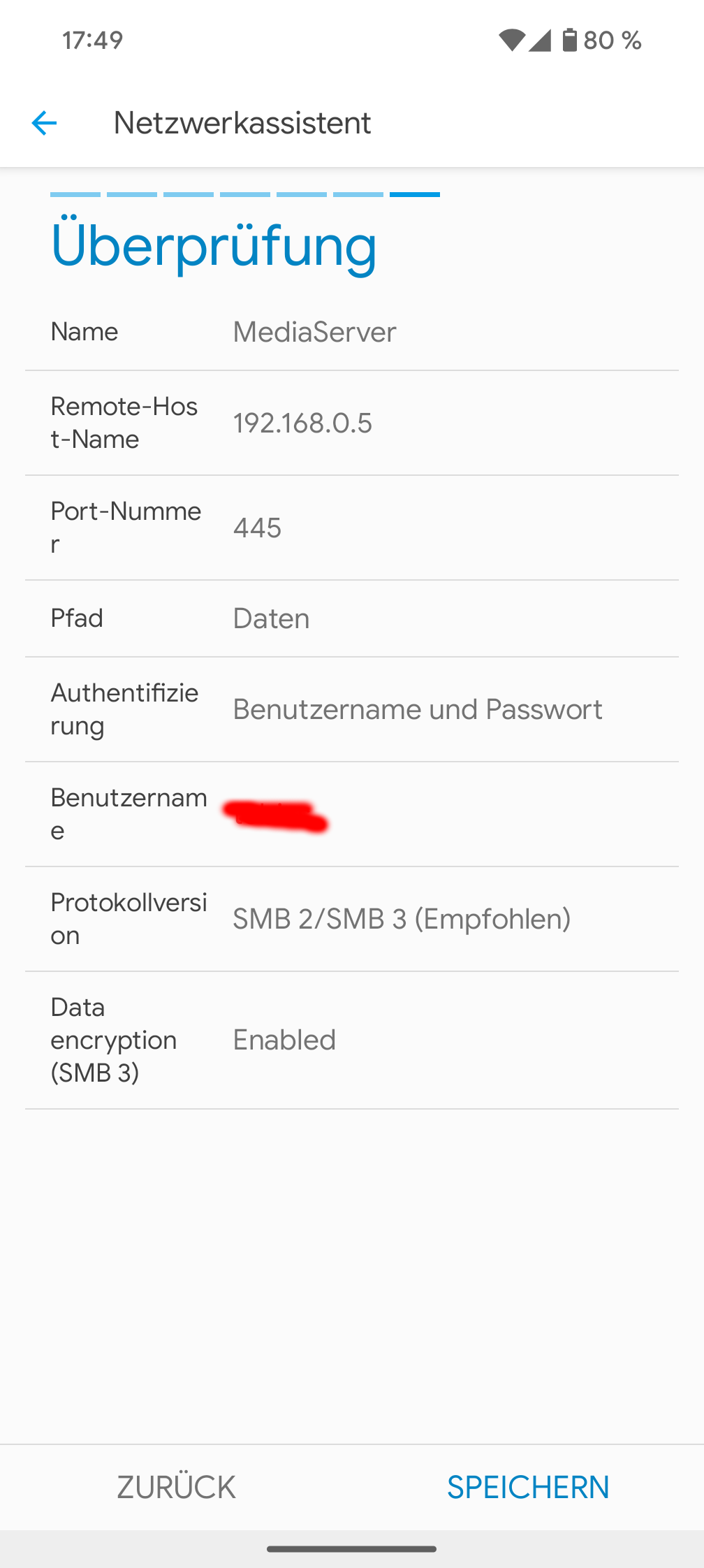

Here are my solid explorer settings:
And the unraid settings:
Advanced settings (for hardening):
#hardening SMB standalone server
server min protocol = SMB3_11
client ipc min protocol = SMB3_11
client signing = mandatory
server signing = mandatory
client ipc signing = mandatory
client NTLMv2 auth = yes
smb encrypt = required
restrict anonymous = 2
null passwords = No
raw NTLMv2 auth = no
but also without any advanced settings i can delete files without an issue with solid explorer now.
null passwords = No
