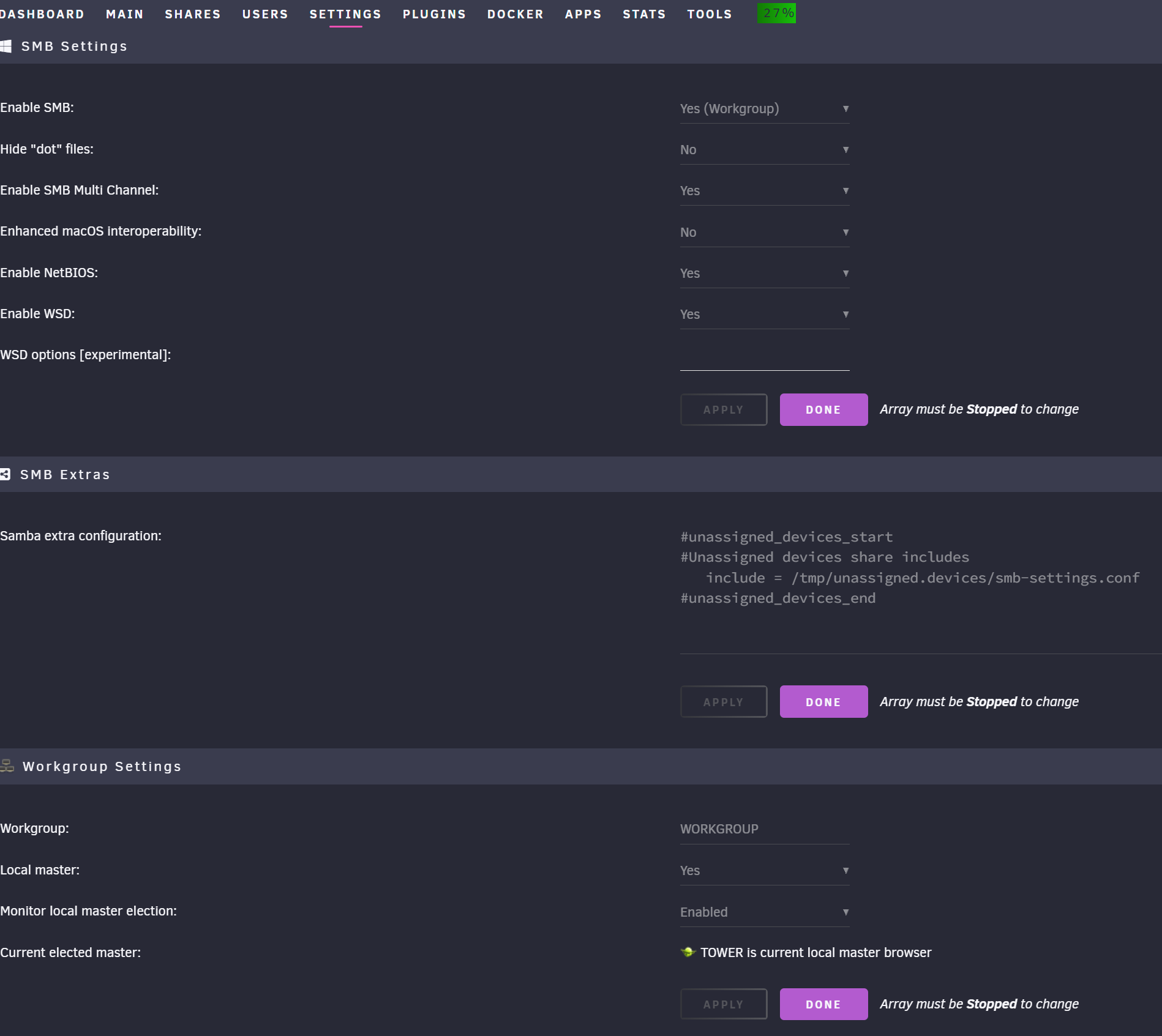

  • Add this to "Settings/SMB/SMB Extras/Samba extra configuration"   ntlm auth = Yes   Please report back if this solves connectivity issues.
  • Wish i could say it worked, it did not.

I think you may have a conflict in the Master Browser election.  This might cause SMB server lookup issues.  Remove the Master Browser plugin and see if it makes a difference.
Edit: Your router may also be trying to be the Master Browser.

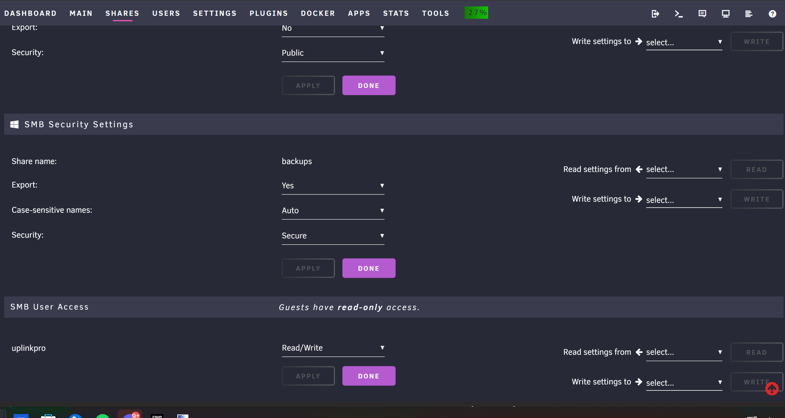

Review your SMB share settings for each share.  Alll your shares are set for Public access.  Your flash device should not be set to Public.  Set it to Private and then set desired user access.
Did you intend for all your shares to be Public?  If you did, you should set up users in Unraid and the set user access for each share you want them to access.  Only set Public access for things that make sense for Public access.
I'm wondering if your flash has some issues.  I'm seeing some strange entries in your smb-shares.conf.
The flash drive is pretty new as well thats kinda crappy, but what you say makes since about the public access, i dont have it set for that if you see in the gui, this is how they are set
15 minutes ago, dlandon said:
Try Private instead of Secure for "Security".
Swapped it all and rebooted it changed the output but still cannot access it.
Just now, dlandon said:
Can't browse to shares, or credential issues still?
credential issues, i click tower it asks for login, i type the IP in and its the same. I tried root and the user i added and both fail.
