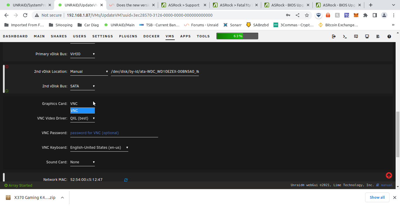

well i've updated the bios and now the VM cant boot and none of my 2 GFX cards are listed as options, just VNC  😕
Haven't tried updating unraid
Did you check that the Virtualisation options are enabled after the bios update as likely to have revierted to default.
I think it is SVM for AMD?
and maybe this for IOMMU
Advanced --> AMD CBS --> NBIO --> there should be an Option for IOMMU.
Edited by SimonF
I can see the GFX cards in SysDevs but it says none available
Cant see anything in the bios that need changed for Virtualisation but i'll check again, most be something like that.
thank you for the reply
SVM is Enabled
NBIO was Auto i've changed to Enable but still not listing any GFX cards in the drop down
Looks like i'll maybe need to try downgrade the BIOS
Hold on
Found another sub menu under NBIO and gotten IOMMU Enabled so the cards are back in the menu 🙃

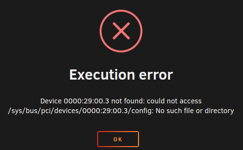

Getting an error when booting VM now
I'll have a look at that and let you know
Have you checked that any vfio bindings are still correct?    Either of the OS or the Bios upgrades could lead to them changing IDs
