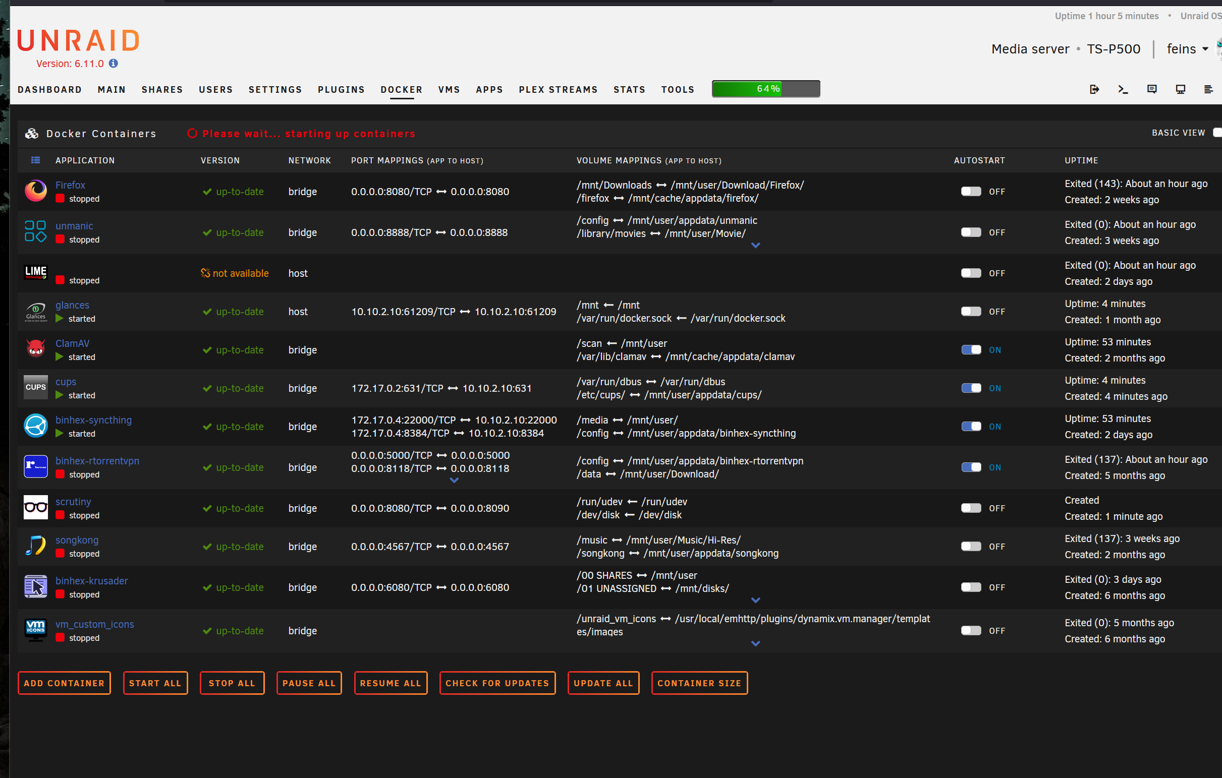

After the server boot up i notice all the container and VM are not been display at the Dashtop and when i click on the Docker Tab it toke 5min to just load the Docker and i notice that the Docker are still on Startingup status even after 20min of waiting.

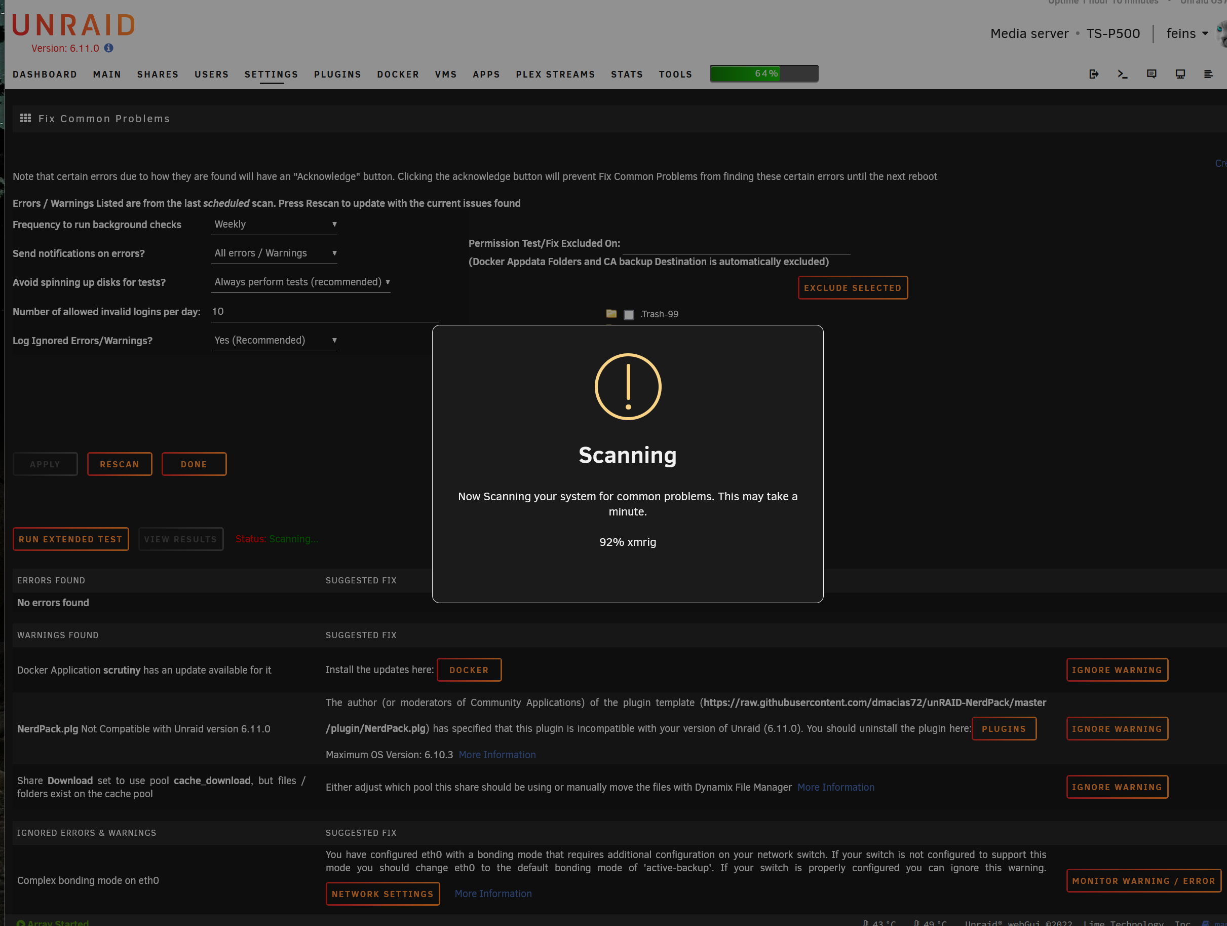

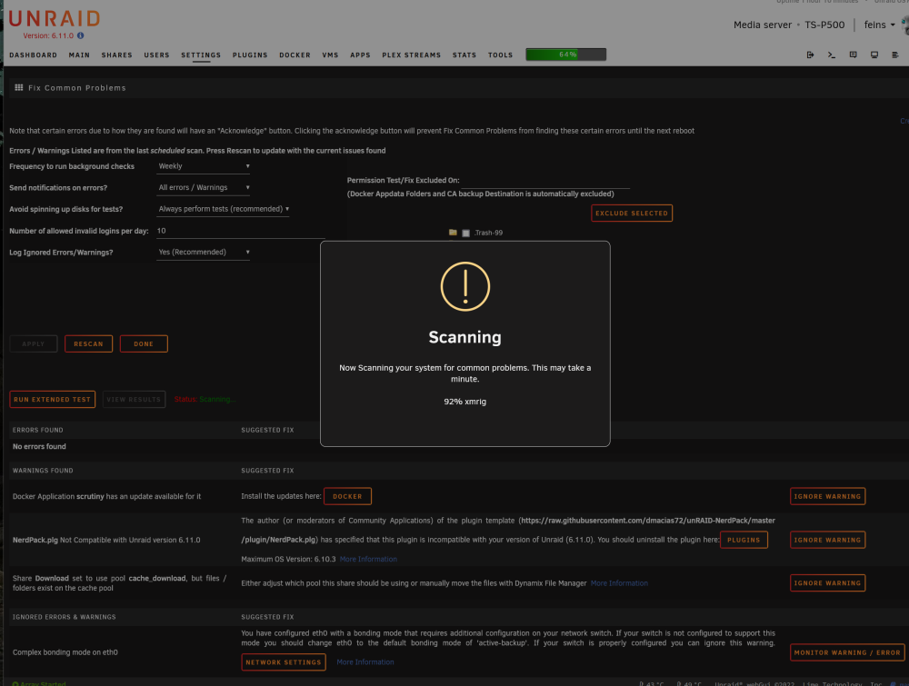

Try to do a Fix Problem Scan and notice the scan toke a long time and wont be completing even wait for 20min.

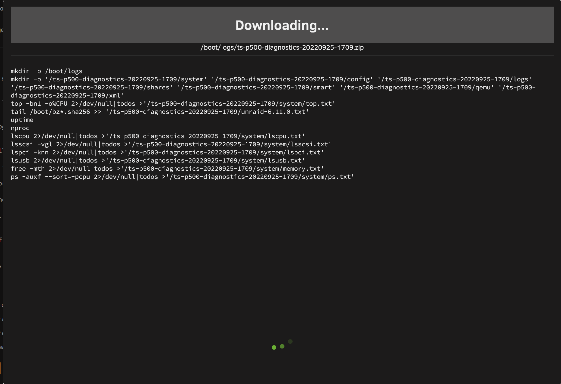

Trying to generate Diagostic also take way longer that use and been waiting for long time still in process like the attach picture.

If the diags didn't finish get the syslog:
cp /var/log/syslog /boot/syslog.txt
