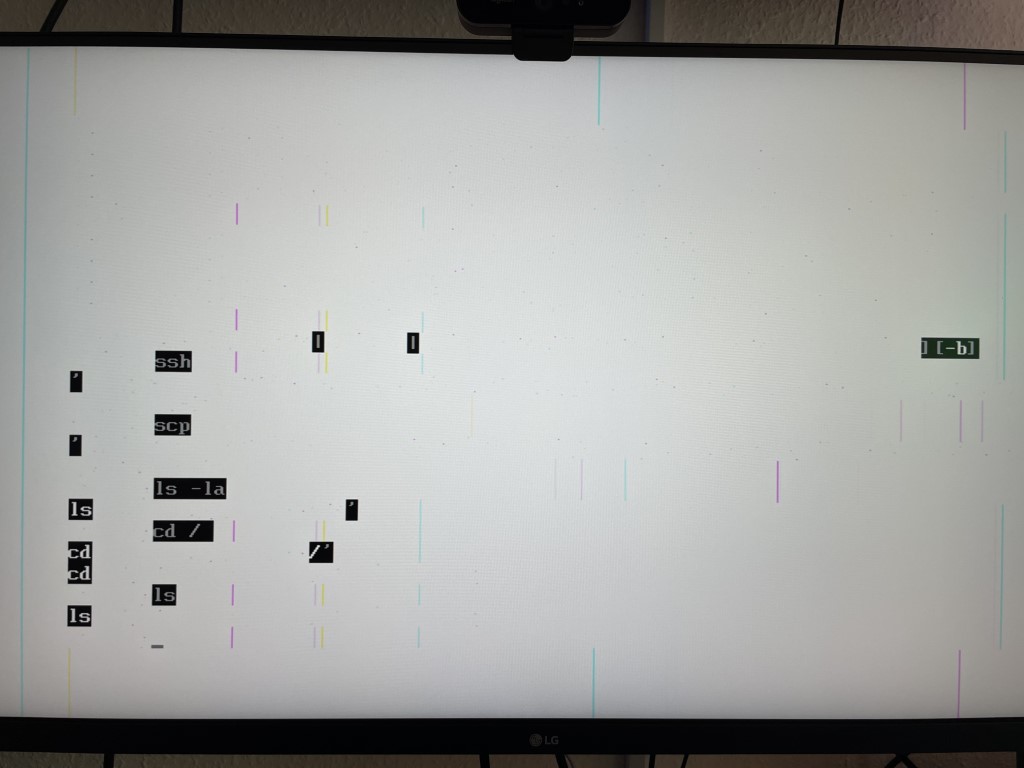

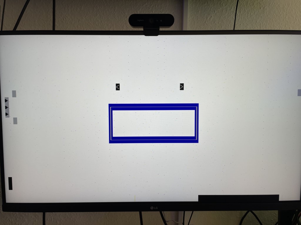

after VM creation (tried Windows and Linux) and clicking on start, it fails to start the VM. It is stuck on starting. I once got it to start the VM and the output was just glitchy, see screenshot.

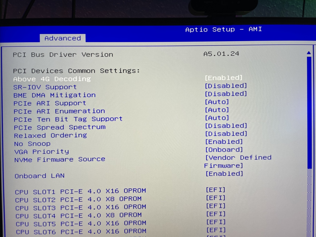

I tried playing with the PCIe settings, but without getting different behaviour.
