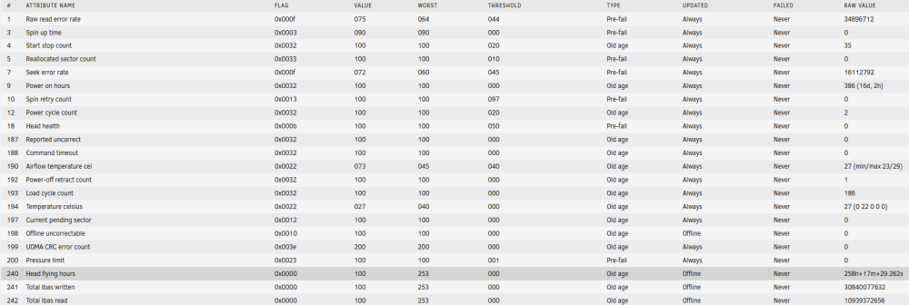

2) The hard drive that this occured on is a Seagate 14TB Exos drive.  I just "installed" it into the server about 2-3 weeks ago.  Should I be concerned that the file system was corrupt on a newly installed HDD (and brand new HDD).  There are no smart errors that are triggering:

Disk looks fine, parity check should find no errors, assuming it was in sync before, and assuming the server did a clean shutdown.
Best way to protect against filesystem corruption and other issues is to have backups, but if you get multiple occurrences of unexpected filesystem corruption it might indicate a hardware issue, like bad RAM.
