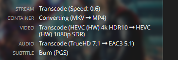

September 26, 20224 yr I have a 12600k and just updated to unraid 6.11. Using the linuxserver plex container I set up the correct passthrough parameter "--device=/dev/dri:/dev/dri" and looks like plex found the iGPU just fine. When I try to transcode It shows up as (hw) transcoding but nothing plays on the cient side. Not sure why it's not working.

September 28, 20224 yr Author I had hope for a second, but I don't get any of those errors. I am getting a segfault error that I am trying to figure out though. kernel: Plex Transcoder[12979]: segfault at 150c9a93ae48 ip 00001500a9dde818 sp 00007ffde2a81420 error 4 in libigdgmm.so.plex[1500a9d50000+90000]
