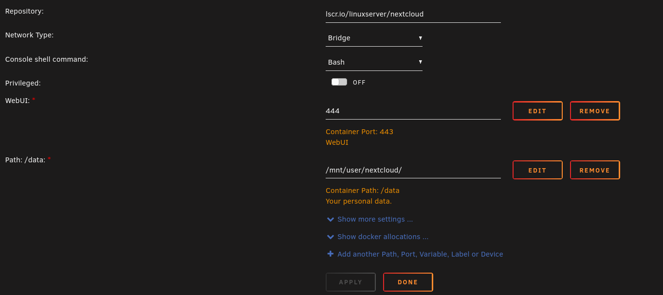

So I  have Nextcloud running on port 444.  I have port forwarding on my router to 444, I have tailscale running in a docker on unraid. The problem is when i access my unraid internally 192.168.1.56:444 everything works fine. I can log in see things all good. When I acticate Tailscale and copy the address witha  :444 I get 400 Bad request.  Anyone know what I am doing wrong?
Accessing things extermanlly with tailscale works fine for everything else ...Searching, Airsonic, etc..... so I know taiscale works. Is there something wrong with my nextcloud setup? Here is a snap of my setup for nextcloud.
Any help is greatly apreciated.
Thanks
Drezin
153319027_Screenshotfrom2022-09-2622-39-23.thumb.png.92dedd6fd25bf76f9d296f58f5807538.png
