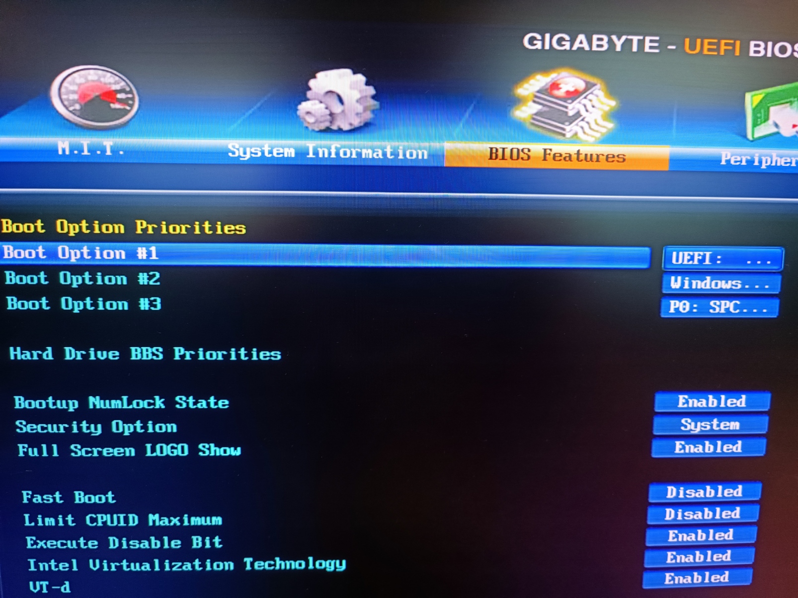

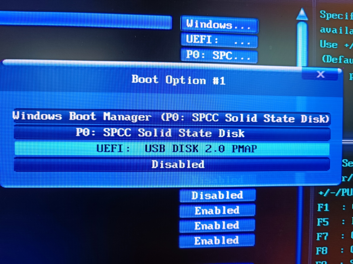

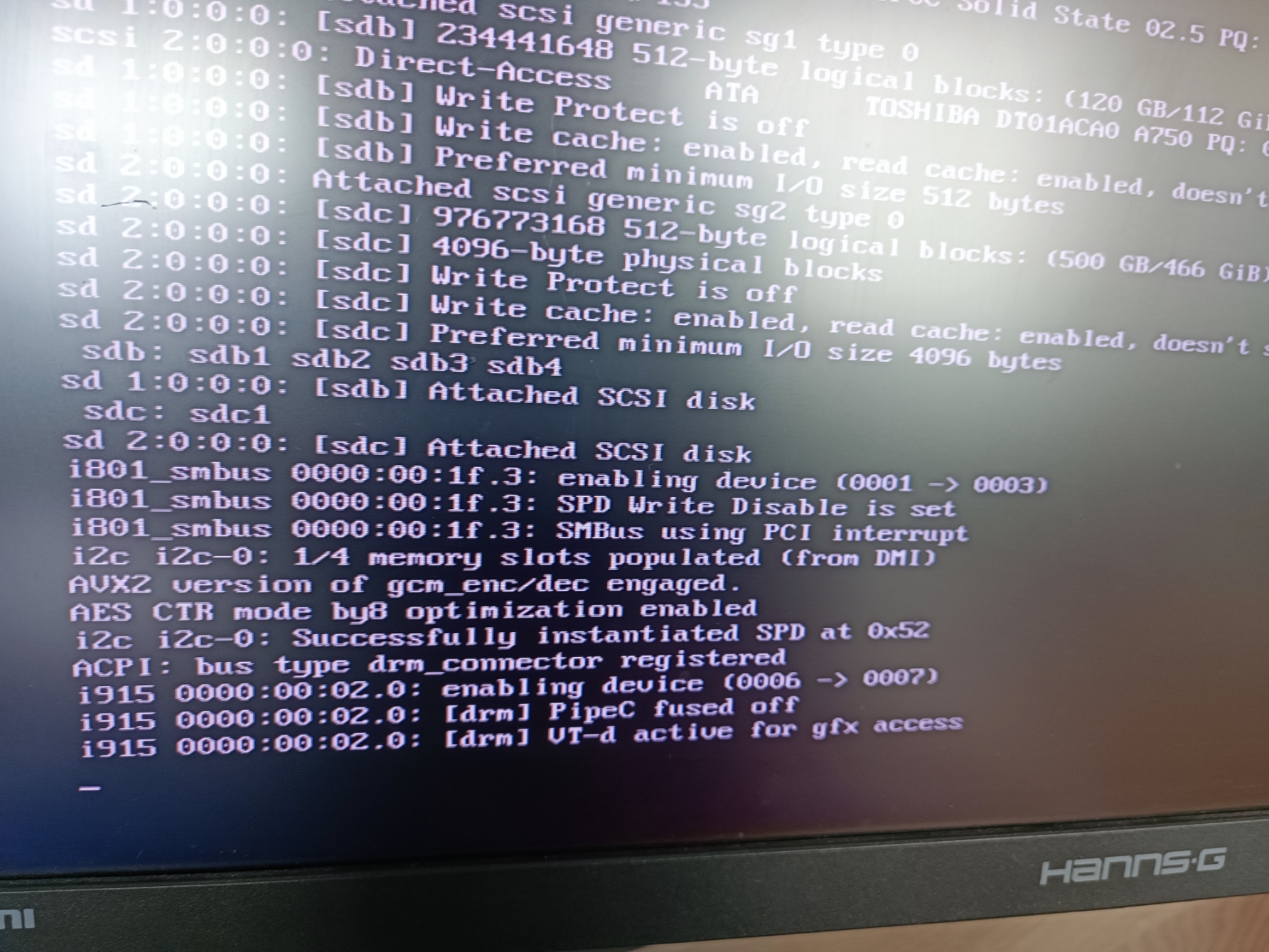

Very first post here. I am trying to boot the unRaid 6 on my tower server for the first time but after several attempts there seems to be a persistent error. Virtualization is enabled, main BOOT drive is the USB drive.
I captured a video of the whole booting process as well as a screenshot of the final screen.

Can you provide me with an assistance? If you need I will share hardware specs or any necessary info.
Thanks!

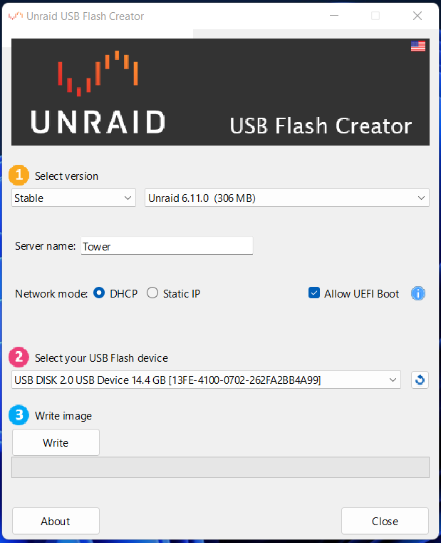

Tried three different flash drives, used three different USB port (both 2.0 and 3.0), blacklisted i915 both in /boot/config/modprobe.d/i915.conf and in /etc/modprobe.d/blacklist.conf and still got the same results. Even removed the WIndows 10 (replaced it w/ Ubuntu).

2 hours ago, JorgeB said:
Double check you're doing it correctly following the instructions linked above, you could also bind the the iGPU to VFIO-PCI, but since Unraid doesn't boot you'd need to boot with a different Linux to get the device list.
Any tips on how to bind them?
I got Ununtu installed already.
Link to comment
Type in the Ubuntu console:
lspci -nn
It will list all the devices, then note the vendor/device ID from the iGPU, example:
Then edit /syslinux/syslinux.cfg on the Unraid flash drive and add the correct vendor/device ID to the append line vfio-pci.ids=xxxx:xxxx, example
label Unraid OS
  menu default
  kernel /bzimage
  append initrd=/bzroot
Becomes
label Unraid OS
  menu default
  kernel /bzimage
  append initrd=/bzroot vfio-pci.ids=1002:515e
The see if the boots.
