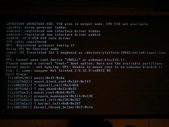

June 17, 201115 yr Ok, I’m a total unRaid noob. I’m running an old machine as a file server with windows 7. I’d like to switch it to an unRaid box. I didn’t find my motherboard in the hardware compatibility section of the wiki. So I did the compatibility test. I downloaded the previous stable ver - unRAID Server version 4.6 AiO – and put it on an old flash drive. changed the boot order in my bios and boot it up. it found the USB started to load unRaid. And then boom. Got the attached error screen. Here’s the specs on the tower MOTHERBOARD asus p5gd1-vm VIDEO CARD ati radeon x550 256mb pcie CPU p4 3.0ghz 531 1mb 800fsb lga775 CASE alienware tower POWER 480w 1.3 psu dc 441/446 RAM Corsair Value Select 4Gb (4 sticks) PC3200 DDR 400MHz Memory is there a way to figure out what piece of hardware in the system is causing the problem?
June 17, 201115 yr Since that motherboard has integrated graphics you could pull out the ATI video card and try with the motherboard graphics. Just a thought. Stephen
June 17, 201115 yr You might also try: 1. a different flash drive or USB port, I seem to recall having a problem with the first flash drive I tried 2. a different NIC card, if you have a PCI network card put it in, disable the on-board LAN in the BIOS and try again. There are a few ASUS motherboards that use NICs that the unRAID package does not have drivers for. 3. once you get to the screen that asks if you want to boot into unRAID or run a memory test, select the memory test option and let it run for a few hours Regards, Stephen

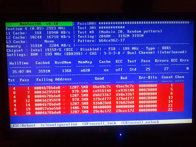

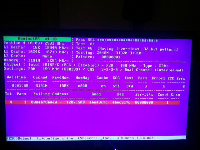

July 15, 201115 yr Author i'll try that tonight. also, i ran a mem test last night i got the attached error. do i have to replace the memory?
July 16, 201115 yr Not a good thing, looks like your RAM is bad. You can try different slots, and or the combination of only one stick.

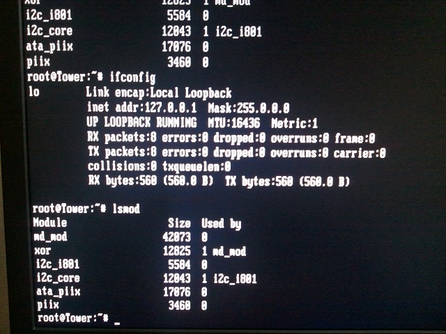

July 23, 201115 yr Author still plugging away. so i ran memory tests with different configurations with the ram till it passed with 1gb stick in slot one and 1gb stick in slot 3. so i booted to unRaid and tried ifconfig and lsmod with the results attached. network.cfg file is as follows # Generated settings: USE_DHCP=no IPADDR=192.168.1.101 NETMASK=255.255.255.0 GATEWAY=192.168.1.1 DHCP_KEEPRESOLV= DNS_SERVER1=192.168.1.1 DNS_SERVER2= DNS_SERVER3= not sure what to try next....
July 23, 201115 yr It still isn't seeing or allowing your Ethernet card to work. Changing settings won't make any difference until it does. Can we see your syslog?
