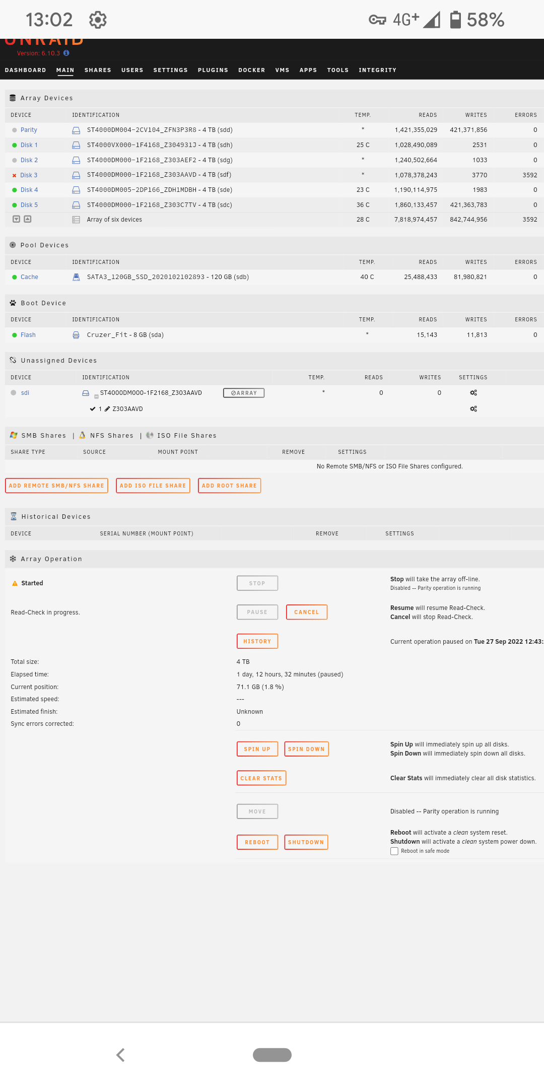

Disk disabled during parity check
Solved by JorgeB
If you cannot cancel the check type "powerdown" in the console, if it doesn't shutdown after 5 minutes o so you'll need to force it, then check/replace cables on disk3 and post new diags after array start.
Thanks Jorge,
"powerdown" command worked and shut down the system after around 2 minutes.
I've changed the cable on disk3 for a new one.
new diags attached.
Strangely, cache drive came up with crc errotower-diagnostics-20220928-1851.zipr on reboot too

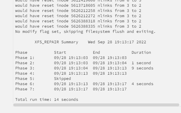

Disk looks mostly OK, emulated disk is not mounting, so check filesystem on it first.
Okay,
so ran filesystem check with the -nv option as the guide says. It has returned lots of errors (i can't see an option to export the log) but the guide mentions "If however issues were found, the display of results will indicate the recommended action to take." I cannot see any recommendations within the log?
Any suggestions on what the best options, to run the tool for real would be?
Run it again without -n, if it asks for it use -L
Great, thanks Jorge.
Run without -n. It completed without asking for -L and without error. I ran again with -n and looks all good now & no errors.
