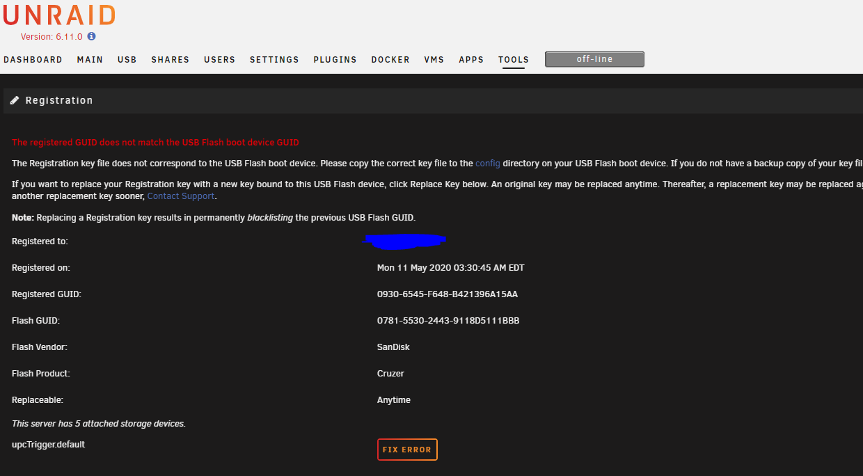

September 29, 20224 yr Hello all. Shut down my Unraid server in preparation for Hurricane Ian and then it would not reboot. Examined logs, saw kernel panics, figured out USB drive was on the fritz. Was able to get the /config folder off prior to it dying. The issue is with my new USB drive, the replace the registration key button does not show up. I tried 6.9.2 and 6.11.0 with the same issue; just says upcTrigger.default. Any tips or help?
September 29, 20224 yr Author Note this is showing up on multiple browsers (Chrome/Firefox/Edge) and multiple devices (Windows/Android). It is also happening when accessing the server from both the IP and the hostname. I've also verified that the server can reach the internet (Terminal -> ping).
September 29, 20224 yr Author OK I think I figured it out; had to install My Servers to get that page to load properly. Now it's saying I already replaced my key in the past 12 months which isn't true...
September 29, 20224 yr Community Expert Solution 21 minutes ago, bigmak said: which isn't true... And Unraid agrees: Try typing in the console: unraid-api restart If that doesn't help you should contact support and they will replace the key for you.
