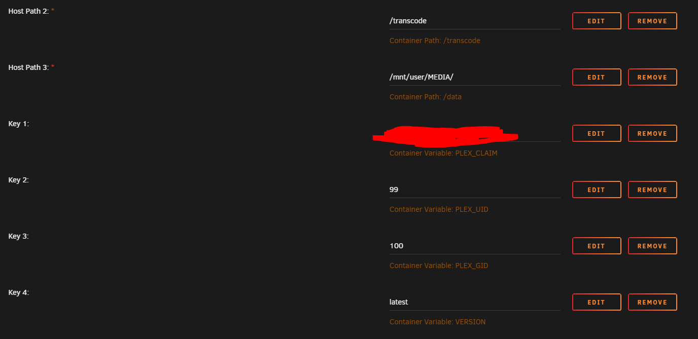

Hello,
I am having the same concern, the plex docker app does not see the media folder when set
/mnt/user/MEDIA/

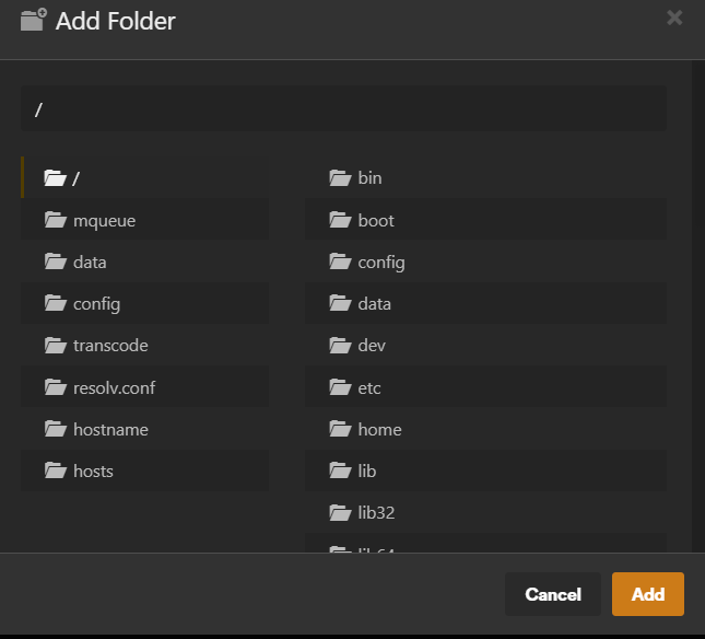

When I load the docker and try to add a library, the dir is /
which shows subfolders
Here is the docker setup
any ideas why plex is not seeing /mnt/user/MEDIA/ ?

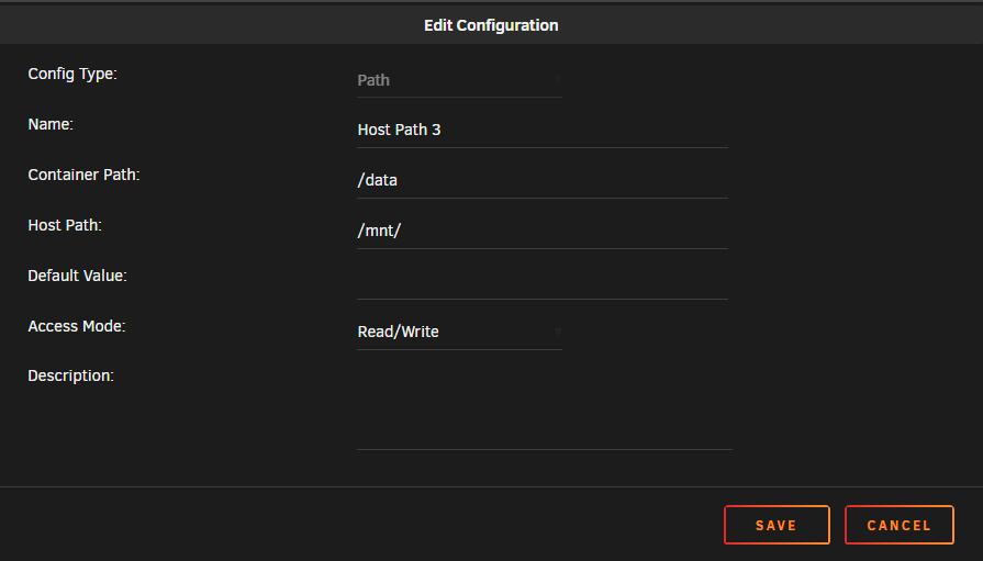

so i had to drop the DIR back to /mnt for plex to see the share ?
I don't get why I can't point to the actual share I want plex to use, and have to go trough 2 subfolders for the docker to see it?
Previously host path was
/mnt/user/media
Now set to
/mnt/
Which allows plex docker to see it, so strange
