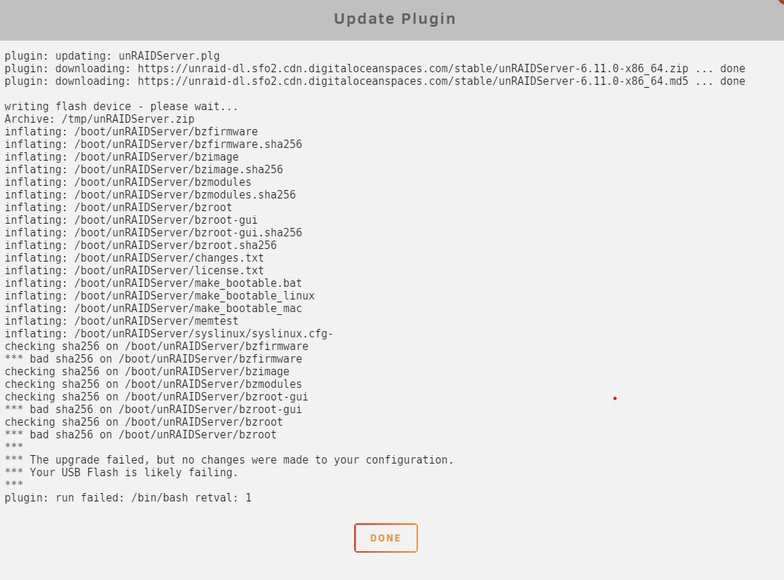

I am trying to upgrade my unraid OS and the update keeps failing...
Any tips or do I need a new USB stick?
I can also see these errors in the log:

Try doing a manual update if it still fails replace the flash drive.
