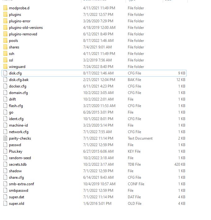

I am very sorry.  I don't know what I was looking at, but I do have a CONFIG folder.  However, I don't have a file in it called DISK_ASSIGNMENTS.TXT (see attached).
I understand the steps you have outlined with the NEW CONFIG, but what about setting up the other disks in the array basically whereever I see fit?  I thought those needed to be back in there same spot as before (i.e. Specific Western Digital Drive = Disk 5, etc.).  Are you saying that it doesn't matter where the data drives are allocated, as long as they are indeed in the array somewhere.  Obviously, you wouldn't want one to be allocated to PARITY.  Parity does need to be specific, but it sounds like the other data drives don't matter where they go as long as they are indeed flagged as data drives...correct?
I'm half inclined to just start the array as-is.  Something tells me UNRAID has it correct.  I just don't remember flagging a SEAGATE drive as parity, but it is likely I did.
As long as you have single parity, array disk order is not important.  unRAID tracks disk by serial number.  If a particular drive used to be in slot 2 for example and is in slot 4 in a new config, that does not cause any problems for unRAID as long as the serial numbers are reported correctly.  Serial numbers are usually messed up if the were previously or are currently connected to some type of RAID controller.
The only real damage that can be done by doing a new config is to assign what was an array data drive as parity.  That will wipe out the data on it.
