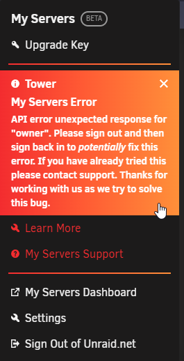

EDIT: Breakthrough! I ran cat/ /etc/nginx/conf.d/servers.conf and yoinked the server_name URL. Took me to the login screen and I'm now seeing the GUI. *However*, My Servers is still showing me as logged out. On my Unraid server, clicking on my profile in the top right pops up a scary warning.
So yeah I'm scared that if I sign out I'll never be able to sign back in. Going to try updating all my plugins and hope that's the issue...
