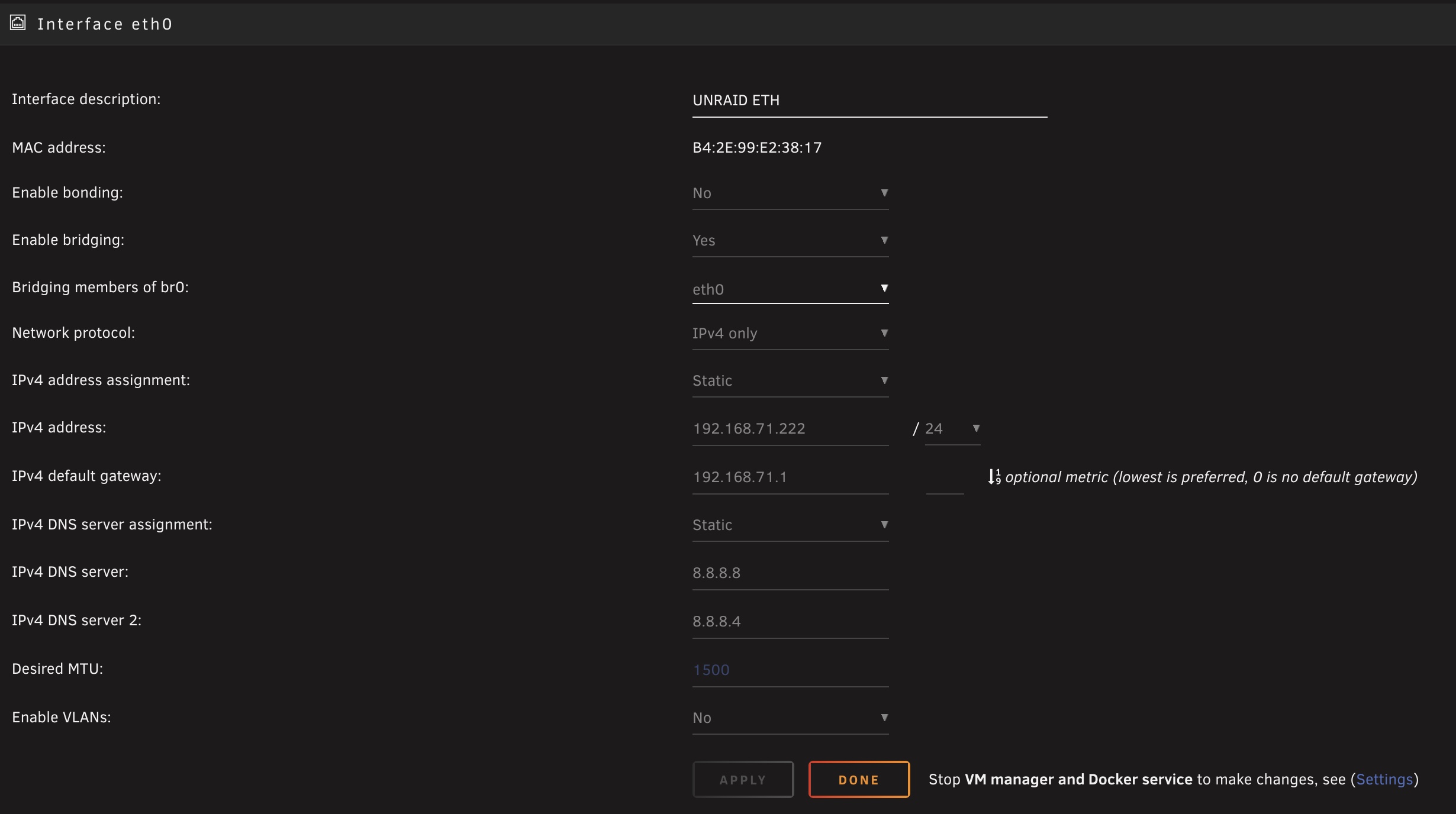

I disabled bonding and did a few boot ups.
But it still takes some time till network is up and running. Maybe a little bit faster like with bonding activated.
Maybe this is just the way it is whithout a dedicated NIC for my VM and I have to live with that.
What bothered me, was the fact, that network sometimes is there immediatly and sometimes not.
