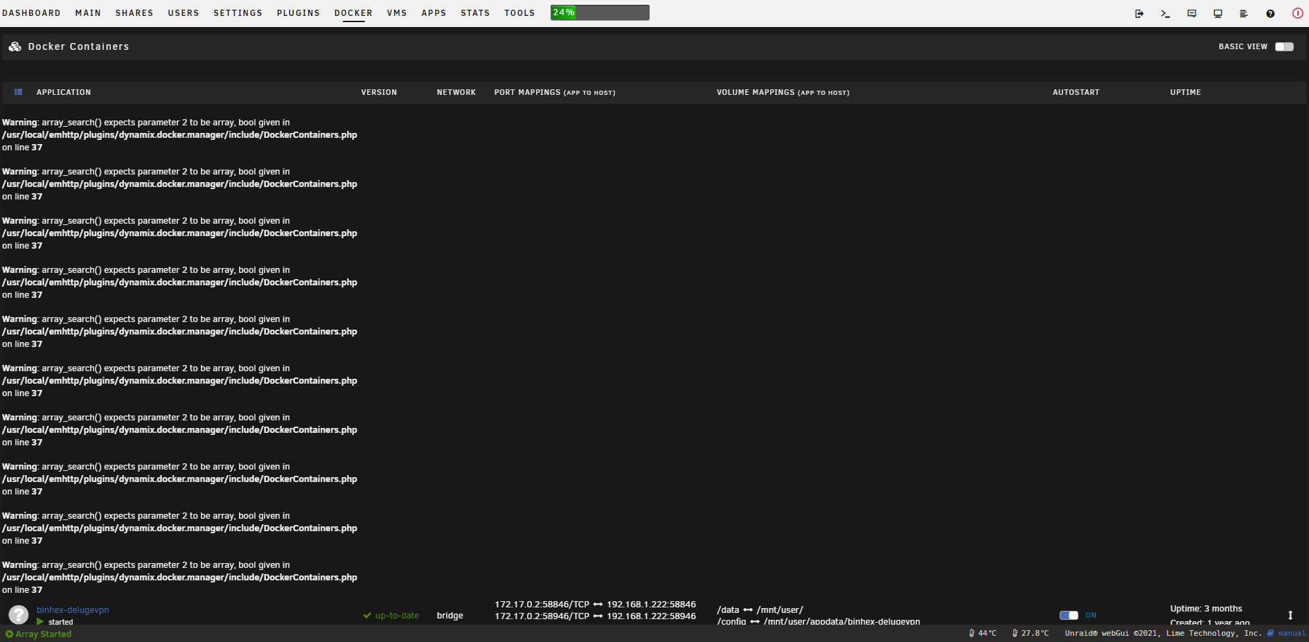

Today i've noticed some weird things at Docker tab . I also realized that at the top right corner was saying missing key (license).

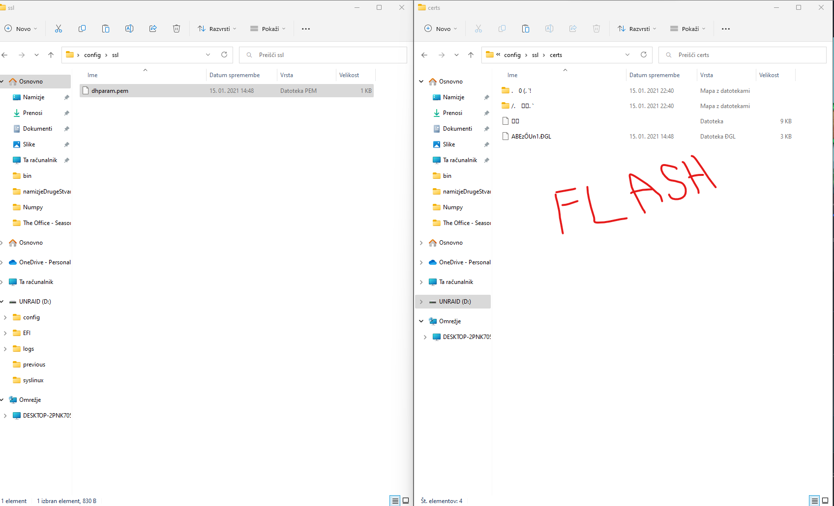

I've got flash drive back. Plugged it PC and copied everything. it failed at folder SSL. After I checked it, some wierd names are in it. I can't copy any of it. What to do?
The rest copied fine it seems.
If this USB now still works ( I dont know about this SSL ), can I put this usb flash drive back in the Unraid and use it until it dies or ?
Edited by Ziga

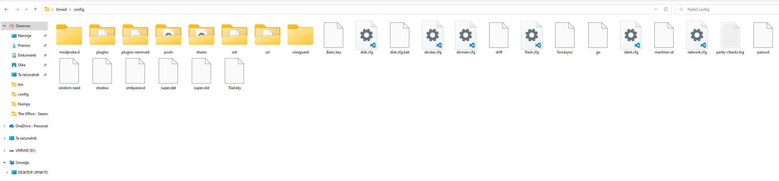

What does the rest of config look like?
Like this. I copied then again from flash drive to PC folder everything ,except config - without any problems and then config file without ssl file - without any problems. It seems that it only has a problem transfering these files/folders from SSL folder.
Since you have basic.key you don't need trial.key
Don't know if the rest of config will be OK or not without trying it.
I wouldn't attempt to reuse that same flash drive though.
Create a new install on a new flash drive, copy the config folder from your backup (without that trial.key), try to boot it up.

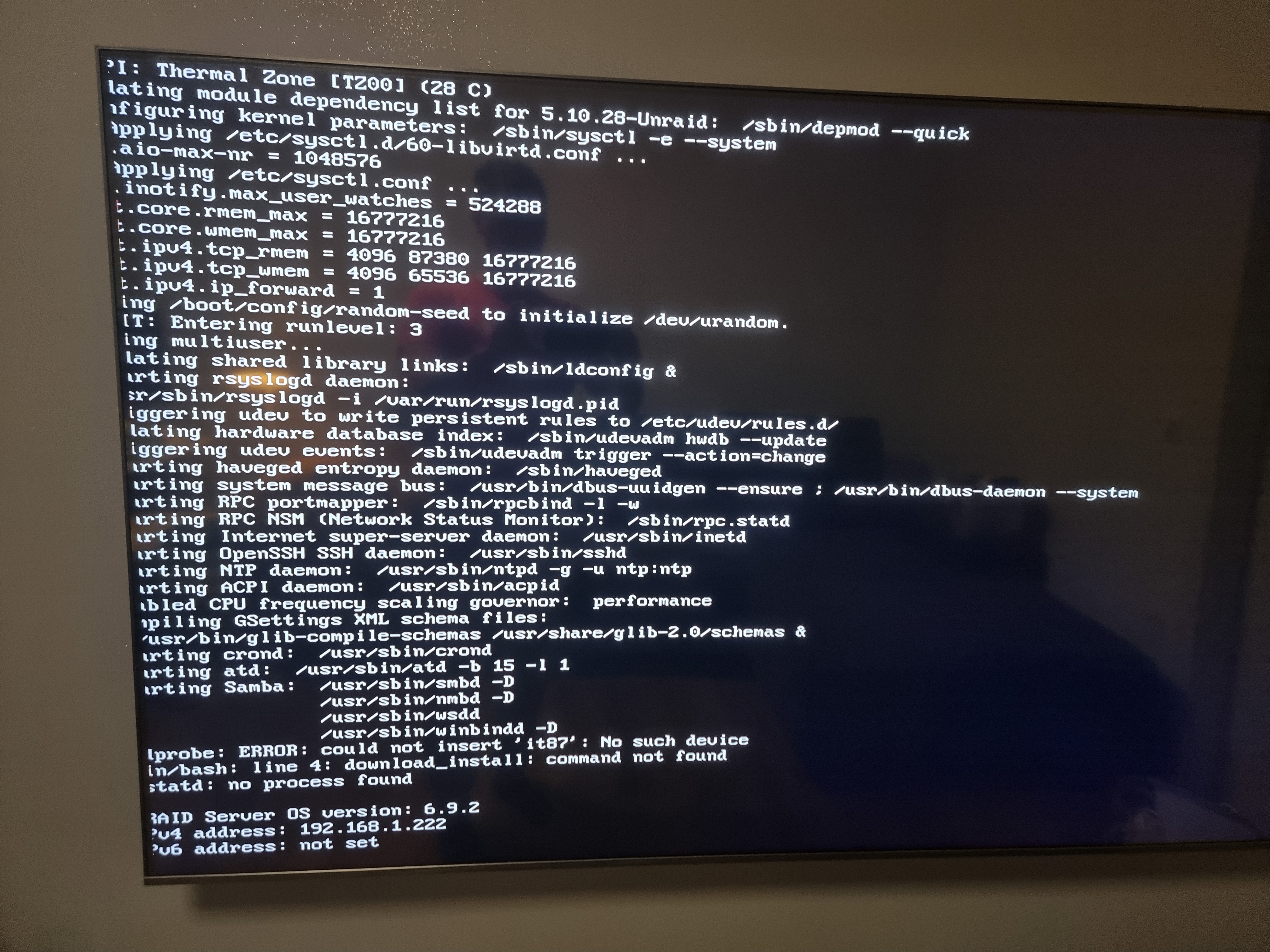

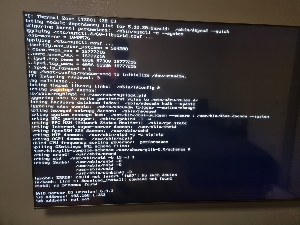

Flashed fresh unraid 6.9.2 and copied old config folder over fresh one. Thisnis what it shows on boot
16 minutes ago, Squid said:
Reboot in safe mode
I'm in! safe mode :D

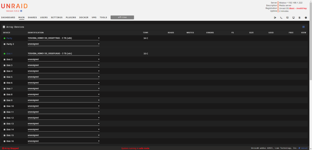

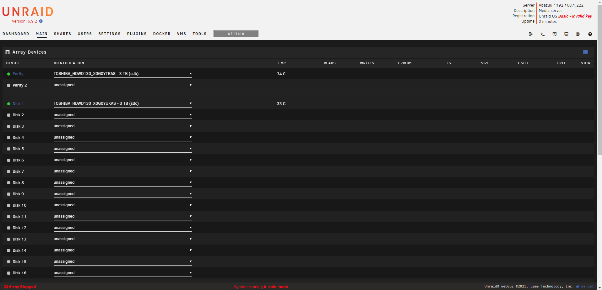

So the error is from a plugin.  OTOH network stats since it didn't show back up.  Probably harmless and can be ignored though.
Should i remove it then? Should I now start array?
I mean after I re-insert license key.
