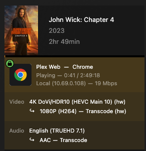

On 7/13/2023 at 3:40 PM, jaimbo said:
I'd tried this guide previously without any success but I've just given it a go now for 6.12.2 and it seems to be working perfectly! I can see the A380 in intel_gpu_top:
I've passed through /dev/dri/renderD128 to my Plex container and can select the Arc card in Plex for HW transcoding:
and I can see Plex is HW transcoding and HW tonemapping as well:
Amazing, very happy :)

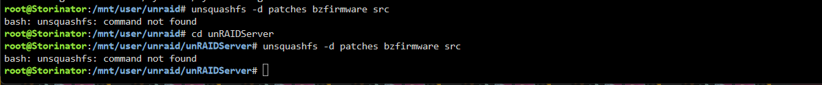

I'm trying out the linked guido to make my own custom kernel, I'm just using 6.12.16 like the guide says but at the point where I have to do the following commands (Using terminal on the server)
wget https://unraid-dl.sfo2.cdn.digitaloceanspaces.com/stable/unRAIDServer-6.12.2-x86_64.zip
unzip unRAIDServer-6.12.2-x86_64.zip -d unRAIDServer cd unRAIDServer
unsquashfs -d patches bzfirmware src
cd ..
cp -r unRAIDServer/patches/src/linux-*-Unraid/. linux/
I strand on the "unsquashfs -d patches bzfirmware src"  step it says command not found what am I doing wrong?
Error message: bash: unsquashfs: command not found
cp: cannot stat 'unRAIDServer/patches/src/linux-*-Unraid/.': No such file or directory
Edited by DeadDevil6210
cd ..
I think you are simply in the wrong directory.
I got the same issue.
Go down one directory and check for the presence of the unRAIDServer folder.
That should be 2 separate commands:
cd unRAIDServer
Edited by BRiT
I attached a screenshot of terminal, What ever I do the Unsquashfs doesn't do anything?

On 2023/7/17 at AM1点42分, DeadDevil6210 said:
我附上了终端的屏幕截图,我做了什么,Unsquashfs 没有做任何事情?
I virtualized a ubuntu to compile the kernel. In ubuntu, you can apt-get install the corresponding package(unsquashfs). In unraid, you cannot use apt-get install.

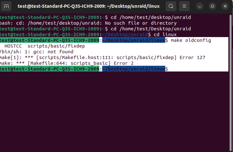

Thnx alot and now I have another problem, By following the guide, I'm at the last step of preparing went through everything flawless after your tip. But now the make oldconfig doesn't work. I was hoping the guido would give some more troubleshooting tips. for newby's like me.
Looks like you need to install the development tools like GCC (gnu c compiler) and possibly others in that Ubuntu vm.
unsquashfs is part of the squashfs-tools package. You'll need to install that and you should be good to go.
