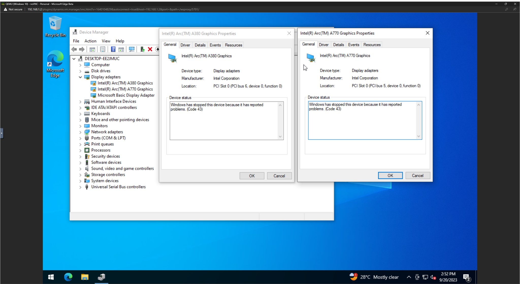

389267825_Screenshot2023-08-01at22_53_03.thumb.png.314e57aa17bd875cf4c2ab69e22acac6.png

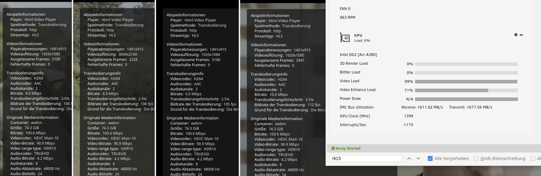

I've now run a few test with my Intel ARC A380 on a custom built Unraid version and these cards are fast, really fast (keep in mind that the official 6.12.x release doesn't support ARC) :
I haven't tested the power draw yet because this was not my main goal, it was just to investigate what's needed to get them running on Unraid back then. I saw that there where reports about high power draw in Idle but there is already a fix out there (I think).
Please keep also in mind that this is more or less a feature request thread and where people can communicate about their Intel ARC experience and custom Kernels, they are not really interested in Nvidia cards because they most certainly already have a ARC GPU on hand and don't want to buy a new one. :)
Hope you get my point and answered most (or hopefully all) of your questions.
