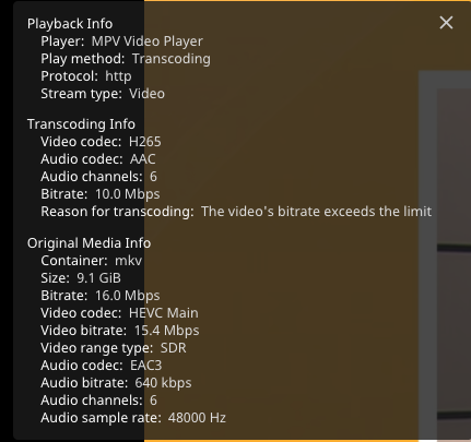

Transcoding works wonderfully, Jellyfin 10.8.9 stable:

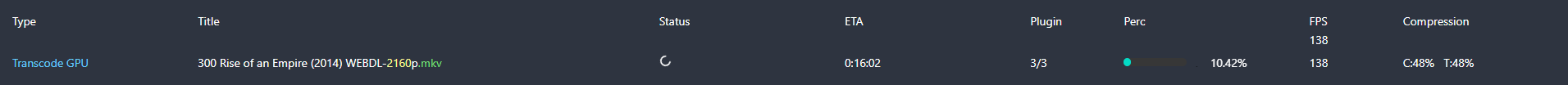

I've used the A770 inside a VM for Handbrake which could transcode 4k h264 mp4 video at around 85 fps. My RTX3080 gets similar numbers. I have a GTX1660Super that averages around 60fps.
Using Tdarr I've seen it hitting several thousand FPS on the A770 so maybe I've just been using Handbrake wrong?

I've got the GPU doing full decode and encoding work now at around 140 fps. Attached image of the Intel GPU working within the Tdarr Docker in Unraid.
my apologies for answering so late, I was on a business trip. I am glad you got it sorted and I am even happier that it works as expected now.
