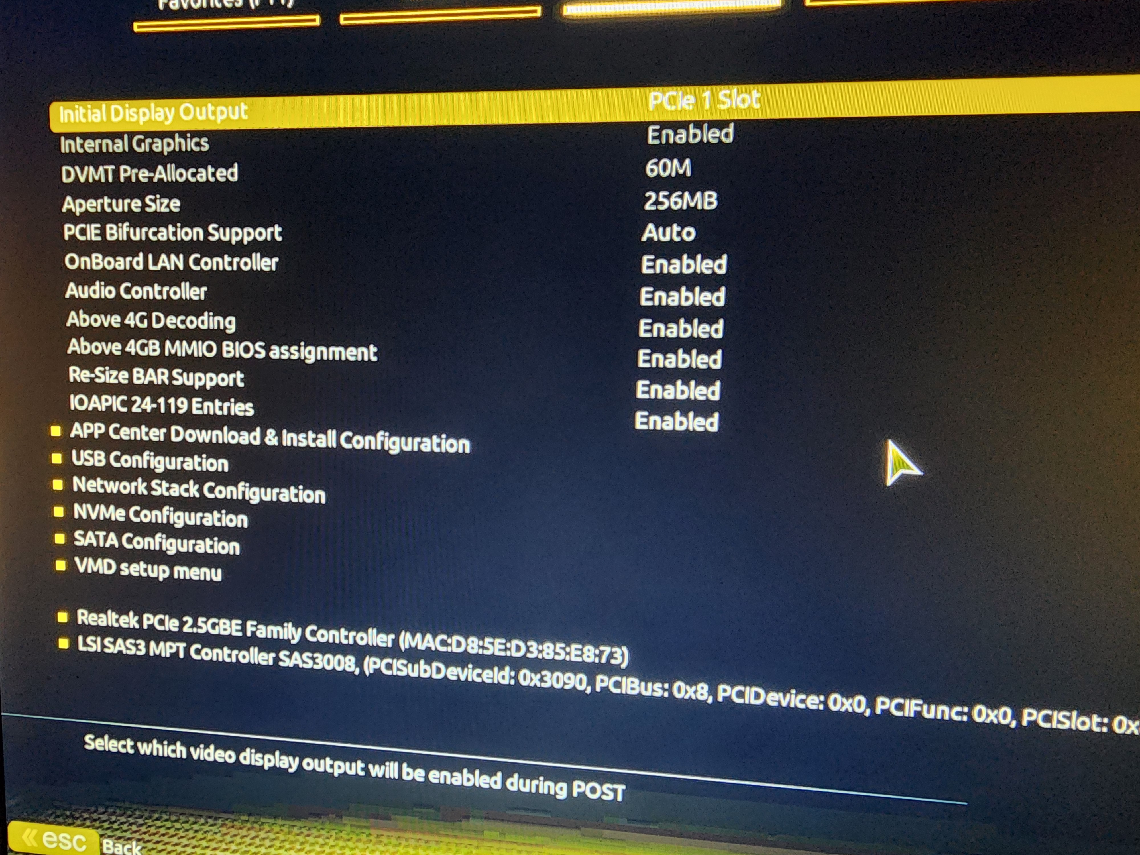

Do you have resizable Bar and above 4G nemory enabled in the bios?
Yes they're both enabled
I had a 3060 installed but I swapped it out for this card
I just double checked to be sure
Edited by IllMethods
Strange, it works now. It took a couple reboots though. So now in my apps, do I need to map to /dev/dri/card0 now instead of /dev/dri/?
