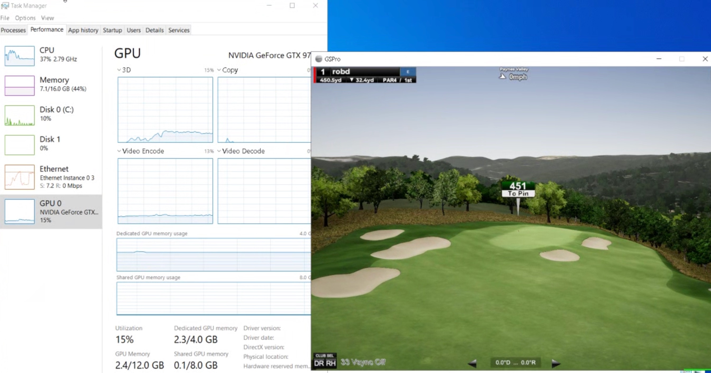

Hi, all out of thoughts as to why this is happening.  Setup a Win10 VM with a GTX970 passthrough to play GSPro, golf simulator software.  GSPro is graphics intense and GTX970 is on the low end of GPU recommendations but figured I'd give it a try.  GSPro has various graphics level settings (Lite, Low, Medium, High, Very High, Ultra).  My projector is low resolution so I'm just trying all this on Lite settings at 1024x768.  When I play, I get around 30fps (28-32) on the test benchmark course and it stutters at times.  GPU usage NEVER goes above 15%.  Nothing looks to be bottleneck'd on the CPU side, and I'm passing 16gb ram to the GPU.  Whatever I do, I can't get GPU usage to go higher on this app unless I increase graphics settings but GPU usage doesn't go up much, and fps just goes down since it's rendering more.  Using MSI Afterburner and it's built in kombustor benchmarking tool, I'm able to max out the GPU usage. I've even OC'd the GPU some, but it makes no difference in the golf sim sw.  OC'ing the GPU, I get a few extra FPS in the Kombustor benchmark tool.  I'm on a HP Z420 unraid setup with a E5-2680 v2 CPU.  I previously had a 2630v2 but upgraded to see if it was a CPU bottleneck, but it made no difference. To add, this is a headless setup and I’m using Moonlight to connect and stream video.
I've done all the usual to max out performance settings in the Windows VM.  I've followed spaceinvaderone's gaming vm setup.  Anyone have any thoughts?  VM XML is attached.  Thanks in advance!

I did set all the usual windows settings to max out performance and such.  I double checked GPU acceleration as you suggested and did make a small discovery where I added the exe for the 'launcher' of the GSPro sim application.  Diving deeper the launcher just seems to perform update checks and eventually launches a different exe for the actual app so I added that exe for max GPU performance.  fingers crossed I launch the app to test, but still the same results.
Someone on the GSPro discord did test on a 1050ti laptop and they get higher FPS than I do as the GPU usage is much higher.  Which is what I would expect, higher GPU usage to get higher FPS, instead of hovering around 15% GPU usage, just to get ~30fps like it's doing for me.
Not sure what else to check.  My limited unraid/VM knowledge, I'm assuming it's a VM config/setting as the hardware should be more than capable.  Just not sure why the GPU is being 'limited' with this app.

Worth noting, HWiNFO app shows GPU Performance Limiters.... Utilization is yes.  So is it the app just not making full use of the GPU?  but if that's the case, on another setup non-VM, laptop setup with a 1050ti, the app makes full use of the GPU.

edit - I used the kombustor benchmark app within MSI afterburner, and it's able to max out the GPU.  So I guess that rules out VM config/setting that is limiting the GPU usage, and it's all pointing at the golf sim app.

EUREKA!  IT WORKS!
PCIe Performance Mode was disabled in Bios.  Enabled it, booted up the original VM.  Golf Sim app 60fps with vsync on Lite graphics mode.  CPU/GPU usage ~26%/~29% respectively!  Disabling vsync, jumps to ~75fps.  This is fantastic!
Thank you so much @ghost82 for all the help!
