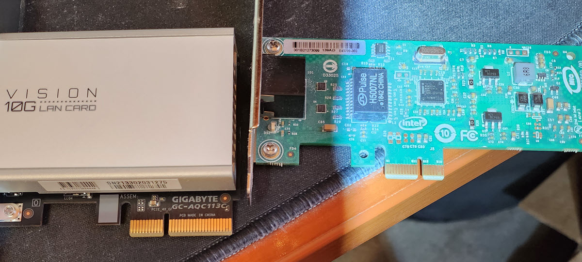

October 2, 20224 yr I'm switching over to 10GbE in my home and started testing a couple RJ45 based 10GbE cards. I got the Gigabyte Vision, but it does not fit in any of my slots! Can someone explain why the Vision is longer and won't fit in my PCIe slots? On my board I have those little tiny PCIe slots which was where I thought this would plug in and I have the longer slots the type you install your video card in. Any suggestions on this craziness? The Vision card is on the left and a normal PCIe is on the right.
October 3, 20224 yr The 10GbE NIC needs a x4 or larger PCIe slot, x1 doesn't have enough bandwidth for a 10GbE NIC.
