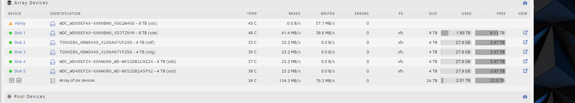

1. My Cache dident work as planned. even on yes it did pick files out of array
2. now i see my array write speed is only like 90-100 mb/s ? is this normal ?`i kinda think its low

1) Enable reconstruct writes in array settings
2) Avoid reading and writing to the array at the same time
3) Write speed to the array is limited by the slowest disk. Might want to do a speed test on each, and potentially upgrade the sloest one(s).
4) Seems your parity isn't valid, is it building now? Obviously that would slow everything else down until it's done (because it's reading and writing multiple things at the same time).
Edited by Kilrah
Wait for the parity sync to finish, turbo write won't work properly until it does.
