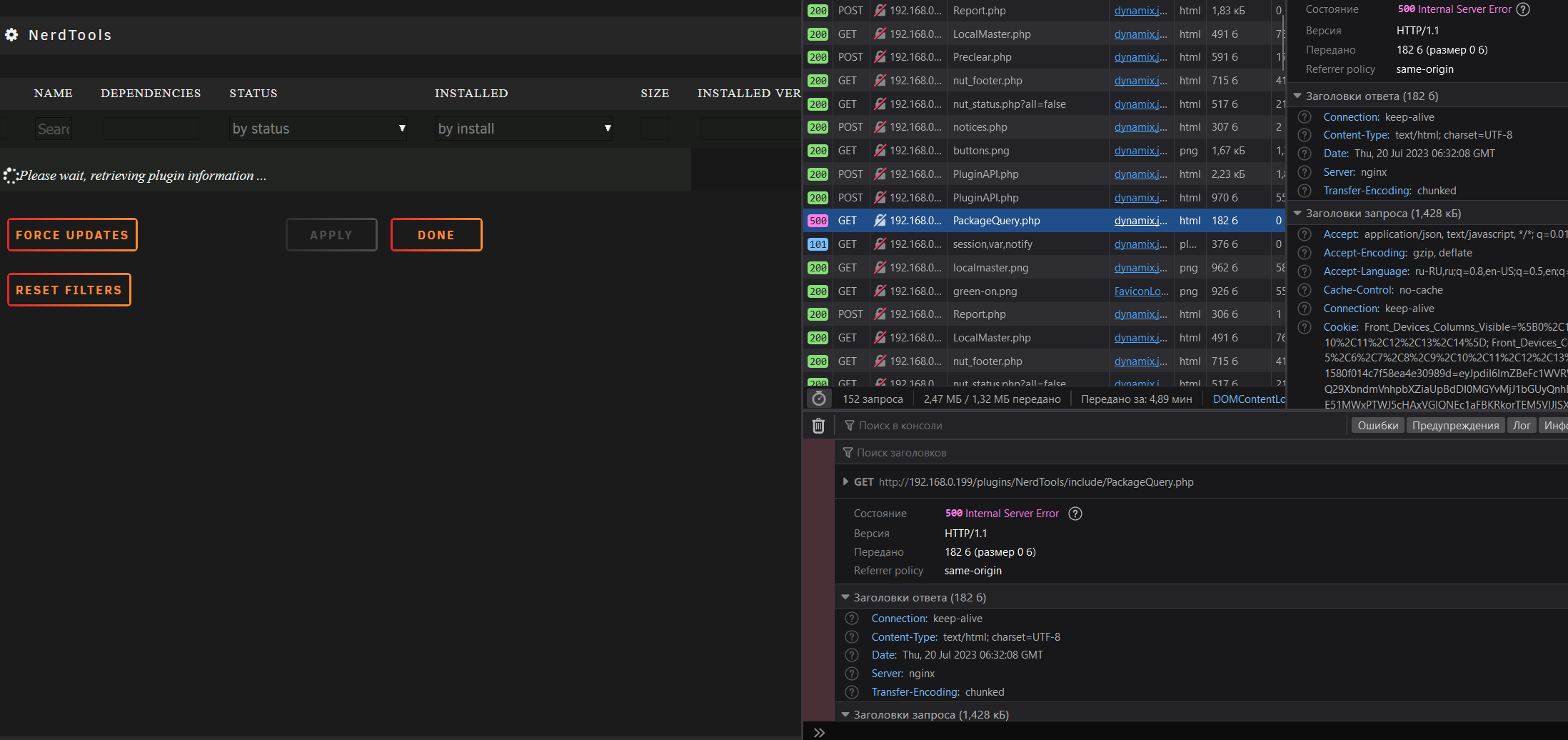

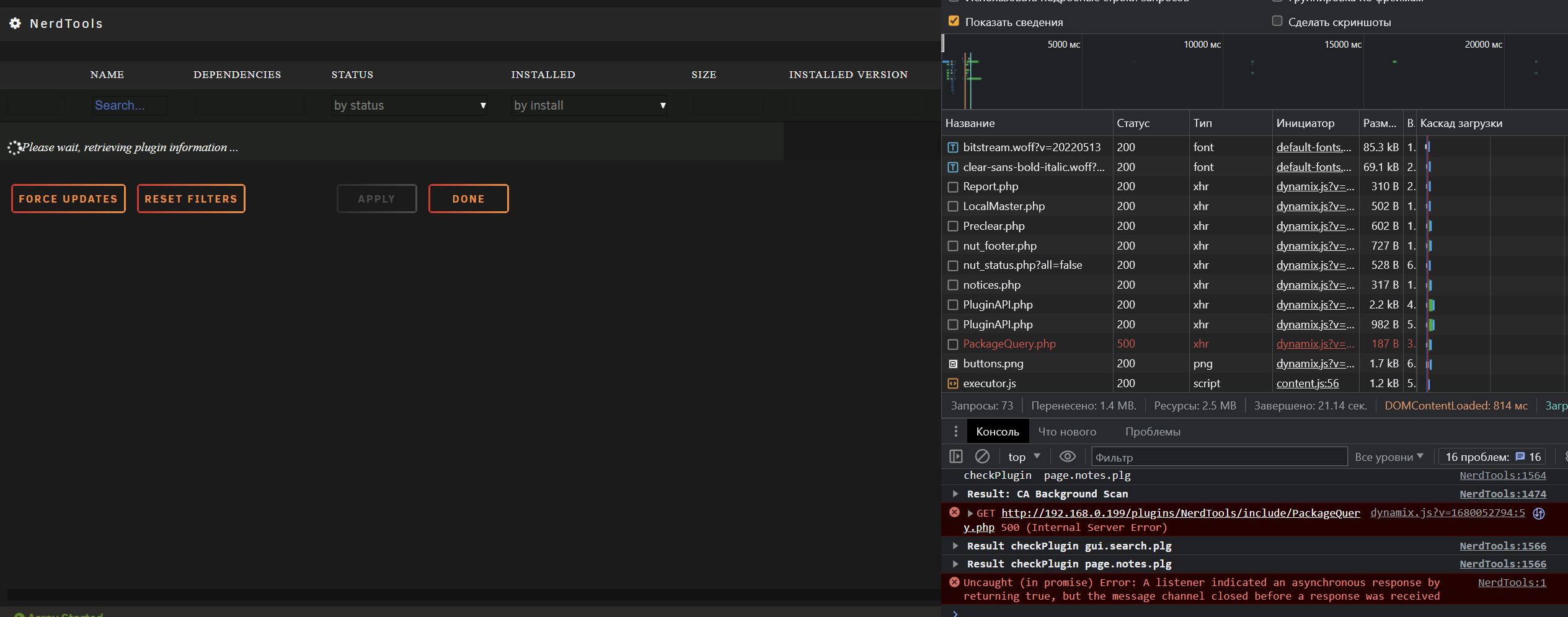

On 6/27/2023 at 6:29 PM, Mamaun said:
I've installed the plugin but now I'm stuck in the settings page with a message:
"Please wait, retrieving plugin information..."
How can I solve this?
Thanks.
Please update nerdtools to the last version and if problem persist then press on Force Updates button.
Best regards.

On 7/15/2023 at 8:42 AM, Masterwishx said:
is someone have error on loading list (when enter to plugin page)?
Update to the last version 2023.07.18 and if not work press on Force Updates button.
Best regards.
Updated ,but still have issue ,checked in chrome and firefox ...
We're working to fix this. Thank you by your report.
Best regards.
