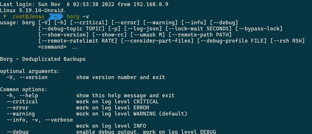

Does Borg backup work for anyone?
root@Tower:~# borg -v
  File "/usr/lib64/python3.9/site-packages/borg/archiver.py", line 41, in <module>
    from .archive import Archive, ArchiveChecker, ArchiveRecreater, Statistics, is_special
  File "/usr/lib64/python3.9/site-packages/borg/archive.py", line 20, in <module>
    from . import xattr
  File "/usr/lib64/python3.9/site-packages/borg/xattr.py", line 9, in <module>
    from ctypes import CDLL, create_string_buffer, c_ssize_t, c_size_t, c_char_p, c_int, c_uint32, get_errno
  File "/usr/lib64/python3.9/ctypes/__init__.py", line 8, in <module>
    from _ctypes import Union, Structure, Array
ImportError: libffi.so.7: cannot open shared object file: No such file or directory
Looks like we need libffi.so.7. unraid  6.11.0 has libffi included but it's libffi.so.8
root@Tower:~# ldconfig -p |  grep ffi
        libffi.so.8 (libc6,x86-64) => /usr/lib64/libffi.so.8
        libffi.so (libc6,x86-64) => /usr/lib64/libffi.so
Edited by ziggie216

1 hour ago, ptirmal said:
I will be following this. I have been putting off updating to 6.11 because I rely on borg backups.
I just installed borgmatic and I have no problems, I'm on 6.11.1
