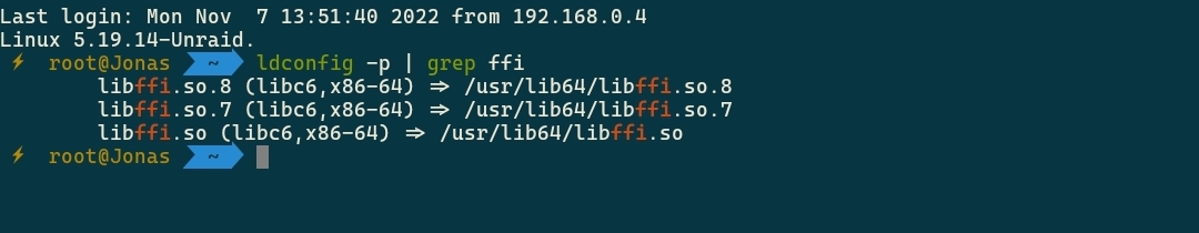

1 hour ago, jsavargas said:
Yes
can you run ldconfig -p |  grep ffi
wondering where libffi.so.7 came from. I'm on 6.11.2

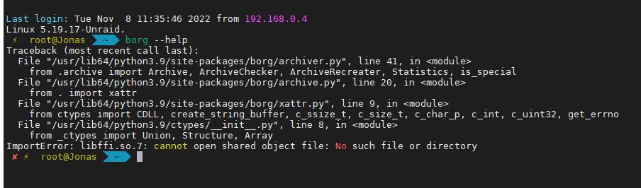

On 11/6/2022 at 4:50 AM, ziggie216 said:
Does Borg backup work for anyone?
root@Tower:~# borg -v
  File "/usr/lib64/python3.9/site-packages/borg/archiver.py", line 41, in <module>
    from .archive import Archive, ArchiveChecker, ArchiveRecreater, Statistics, is_special
  File "/usr/lib64/python3.9/site-packages/borg/archive.py", line 20, in <module>
    from . import xattr
  File "/usr/lib64/python3.9/site-packages/borg/xattr.py", line 9, in <module>
    from ctypes import CDLL, create_string_buffer, c_ssize_t, c_size_t, c_char_p, c_int, c_uint32, get_errno
  File "/usr/lib64/python3.9/ctypes/__init__.py", line 8, in <module>
    from _ctypes import Union, Structure, Array
ImportError: libffi.so.7: cannot open shared object file: No such file or directory
Looks like we need libffi.so.7. unraid  6.11.0 has libffi included but it's libffi.so.8

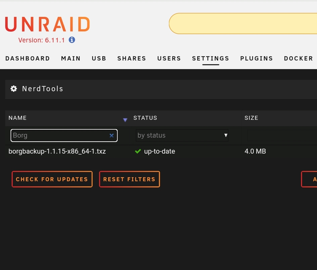

23 hours ago, jsavargas said:
I just installed borgmatic and I have no problems, I'm on 6.11.1
I haven't used borgmatic before. Did you have borg running on previous versions?
I am going to install it in a clean installation, I have done the same procedure as you, but some other plugin may have installed some extra dependency
I have installed this version, and nothing else, do you have updated nerdtools?

I fixed this by doing the following and then borg runs without errors on mine.
Probably not the proper way to do it and have not tested after a reboot.
Download the libffi v3.3 from here on another Linux PC, I used Linux Mint 21: https://github.com/libffi/libffi/releases
Direct link: https://github.com/libffi/libffi/releases/download/v3.3/libffi-3.3.tar.gz
Extract and then open a terminal in the extracted directory then type:
./configure
make
There should then be a libffi.so.7.1.0 in libffi-3.3/x86_64-pc-linux-gnu/.libs directory
Rename this to libffi.so.7
Then copy across to /usr/lib64/libffi.so.7 on unraid and run borg
Hope that helps until it is fixed properly
