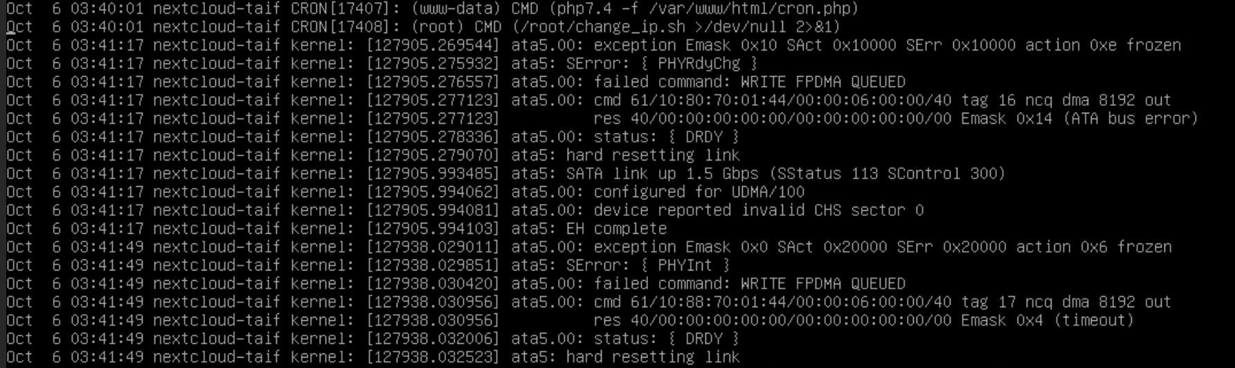

I have this issue where my Proxmox VM Disks (mounted over NFS from my UnRaid NAS) will throw ata errors after some time.
I figured out, that in this case, after the mover run, the issue occured:

Syslog of my VM:
You can see, that just a minute after he mover seemed to run, it started with this errors.
On Oct 4th, the mover also ran at 03:40, but my VM didnt have any errors until 11:44 that day.
In this case, Unraid mentioned a disk spindown at 10:44, but the issues arrived an hour later.
