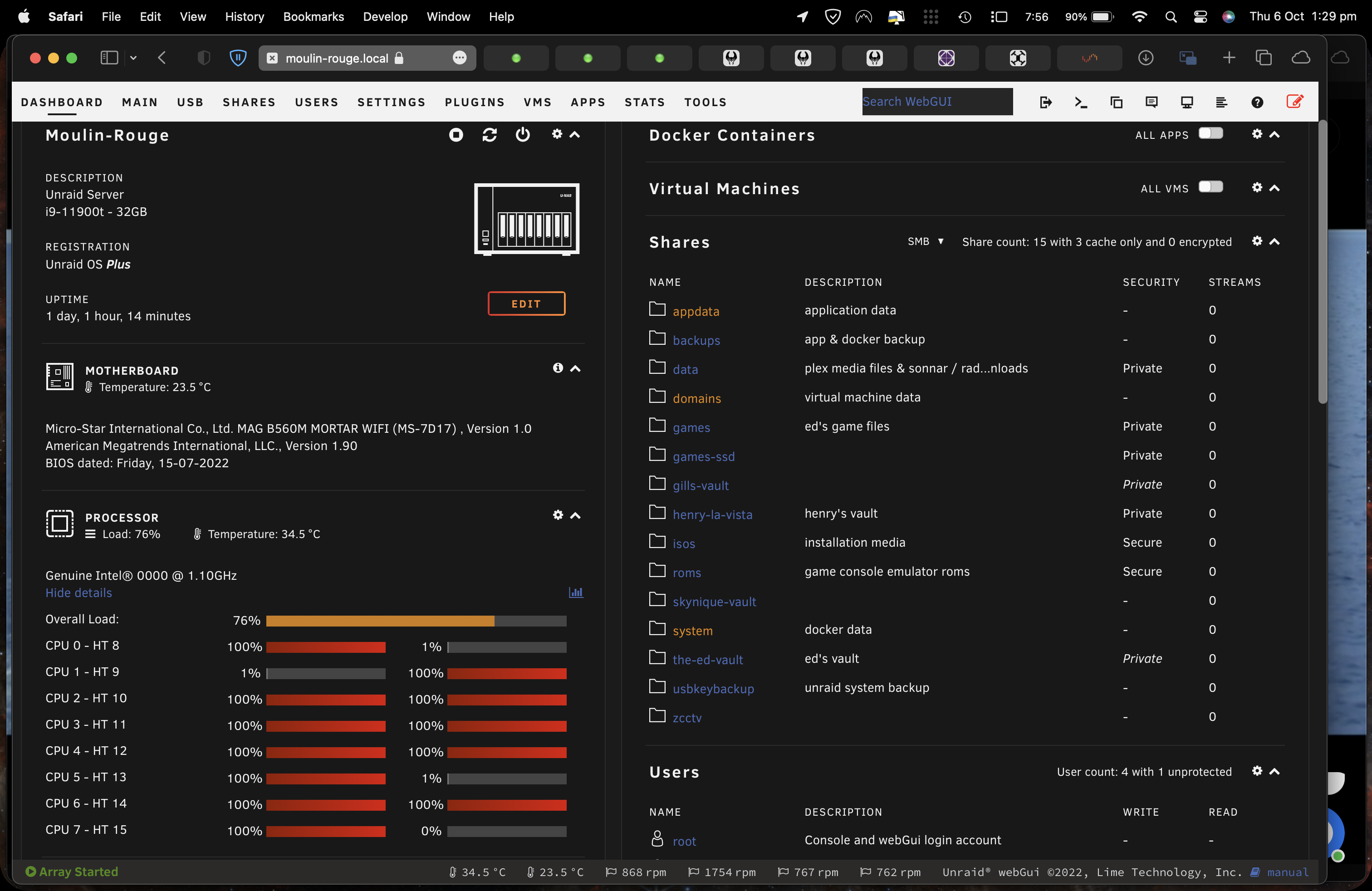

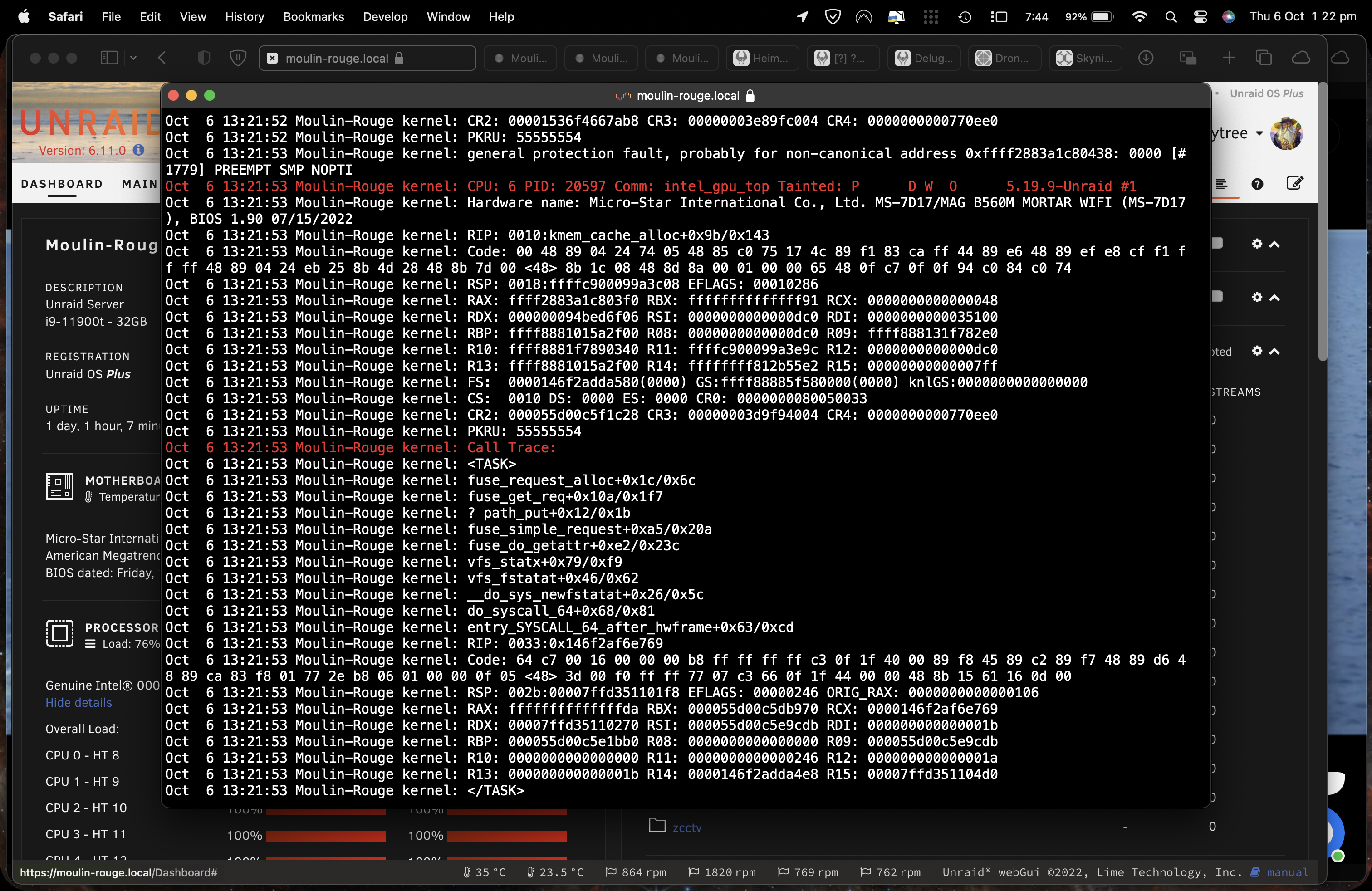

Last 2 days have been waking up to this. The server seems to be locking up overnight.
It causes the dockers tab to become unresponsive.
Can still acccess settings and main page but pressing stop array does nothing.
No commands seem to work like shut down etc.
So I have to manually reboot.
Any help greatly appreciated.

Anyone know what these mean?
Unraid syslog
Oct  8 01:48:11 Moulin-Rouge kernel: CPU: 10 PID: 9627 Comm: emhttpd Tainted: P    B D    O      5.19.14-Unraid #1
Oct  8 01:48:11 Moulin-Rouge kernel: CPU: 3 PID: 9140 Comm: sh Tainted: P    B D    O      5.19.14-Unraid #1
Oct  8 01:48:08 Moulin-Rouge kernel: CPU: 1 PID: 14542 Comm: shfs Tainted: P    B D    O      5.19.14-Unraid #1
