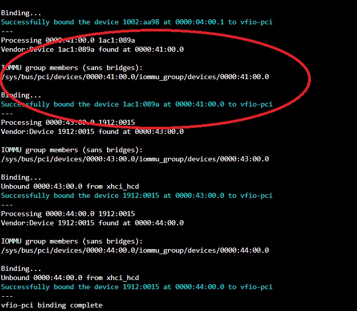

October 7, 20224 yr My successfully bound to vfio pci card after the machine restart does not show up in my Other PCI devices list when building a VM. how can i manually add it to the xml file ?? here is the card please and thank you Edited October 7, 20224 yr by richland007

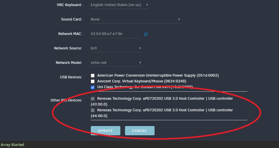

October 7, 20224 yr Community Expert do the two usb controll4rs show in pci options? can you provide a screen print of the template options? Edited October 7, 20224 yr by SimonF
October 8, 20224 yr 14 hours ago, SimonF said: do the two usb controll4rs show in pci options? yes, the 2 show, but for whatever reason 41:00.0 doesn't: https://forums.unraid.net/topic/129157-vfio-bind-of-pcie-device/

October 8, 20224 yr Author 20 hours ago, SimonF said: do the two usb controll4rs show in pci options? can you provide a screen print of the template options? The two USB cards are passed beautifully to the VMs one for the Home Assistant VM and One for a Windows VM ...they are working just fine

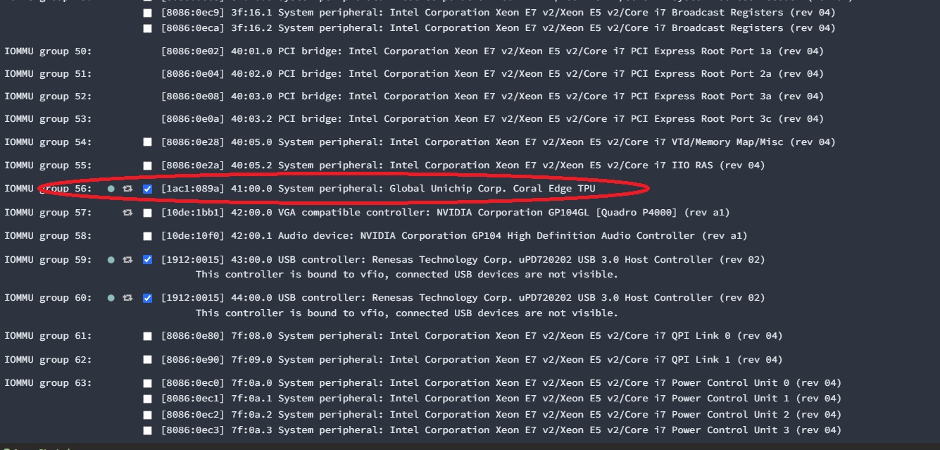

October 8, 20224 yr Community Expert 1 hour ago, richland007 said: here it is i attached as a text file lspci.txt 26.52 kB · 1 download Anything with type starting 08 is blacklisted hence why it doesn't show in pci devs
October 8, 20224 yr Author 15 minutes ago, SimonF said: Anything with type starting 08 is blacklisted hence why it doesn't show in pci devs The server is a Dell R720xd if that matters how do we un-blacklist the type 08??....i dont even know what blacklisted PCI device means
October 8, 20224 yr Community Expert 28 minutes ago, richland007 said: The server is a Dell R720xd if that matters how do we un-blacklist the type 08??....i dont even know what blacklisted PCI device means Its just the way devices are excluded from the list. Any type starting with the number below are not shown. $arrBlacklistClassIDregex = '/^(05|06|08|0a|0b|0c05)/' i.e. 08 is system devices. There is not a simple way to un blacklist but should be able to add via XML. 3f:0f.0 "System peripheral [0880]" "Intel Corporation [8086]" "Xeon E7 v2/Xeon E5 v2/Core i7 Integrated Memory Controller 0 Target Address/Thermal Registers [0ea8]" -r04 -p00 "Intel Corporation [8086]" "Xeon E7 v2/Xeon E5 v2/Core i7 Integrated Memory Controller 0 Target Address/Thermal Registers [0000]" 3f:0f.1 "System peripheral [0880]" "Intel Corporation [8086]" "Xeon E7 v2/Xeon E5 v2/Core i7 Integrated Memory Controller 0 RAS Registers [0e71]" -r04 -p00 "Intel Corporation [8086]" "Xeon E7 v2/Xeon E5 v2/Core i7 Integrated Memory Controller 0 RAS Registers [0000]" 3f:0f.2 "System peripheral [0880]" "Intel Corporation [8086]" "Xeon E7 v2/Xeon E5 v2/Core i7 Integrated Memory Controller 0 Channel Target Address Decoder Registers [0eaa]" -r04 -p00 "Intel Corporation [8086]" "Xeon E7 v2/Xeon E5 v2/Core i7 Integrated Memory Controller 0 Channel Target Address Decoder Registers [0000]" 3f:0f.3 "System peripheral [0880]" "Intel Corporation [8086]" "Xeon E7 v2/Xeon E5 v2/Core i7 Integrated Memory Controller 0 Channel Target Address Decoder Registers [0eab]" -r04 -p00 "Intel Corporation [8086]" "Xeon E7 v2/Xeon E5 v2/Core i7 Integrated Memory Controller 0 Channel Target Address Decoder Registers [0000]" 3f:0f.4 "System peripheral [0880]" "Intel Corporation [8086]" "Xeon E7 v2/Xeon E5 v2/Core i7 Integrated Memory Controller 0 Channel Target Address Decoder Registers [0eac]" -r04 -p00 "Intel Corporation [8086]" "Xeon E7 v2/Xeon E5 v2/Core i7 Integrated Memory Controller 0 Channel Target Address Decoder Registers [0000]" 3f:0f.5 "System peripheral [0880]" "Intel Corporation [8086]" "Xeon E7 v2/Xeon E5 v2/Core i7 Integrated Memory Controller 0 Channel Target Address Decoder Registers [0ead]" -r04 -p00 "Intel Corporation [8086]" "Xeon E7 v2/Xeon E5 v2/Core i7 Integrated Memory Controller 0 Channel Target Address Decoder Registers [0000]" 3f:10.0 "System peripheral [0880]" "Intel Corporation [8086]" "Xeon E7 v2/Xeon E5 v2/Core i7 Integrated Memory Controller 1 Channel 0-3 Thermal Control 0 [0eb0]" -r04 -p00 "Intel Corporation [8086]" "Xeon E7 v2/Xeon E5 v2/Core i7 Integrated Memory Controller 1 Channel 0-3 Thermal Control 0 [0000]" 3f:10.1 "System peripheral [0880]" "Intel Corporation [8086]" "Xeon E7 v2/Xeon E5 v2/Core i7 Integrated Memory Controller 1 Channel 0-3 Thermal Control 1 [0eb1]" -r04 -p00 "Intel Corporation [8086]" "Xeon E7 v2/Xeon E5 v2/Core i7 Integrated Memory Controller 1 Channel 0-3 Thermal Control 1 [0000]" 3f:10.2 "System peripheral [0880]" "Intel Corporation [8086]" "Xeon E7 v2/Xeon E5 v2/Core i7 Integrated Memory Controller 1 Channel 0-3 ERROR Registers 0 [0eb2]" -r04 -p00 "Intel Corporation [8086]" "Xeon E7 v2/Xeon E5 v2/Core i7 Integrated Memory Controller 1 Channel 0-3 ERROR Registers 0 [0000]" 3f:10.3 "System peripheral [0880]" "Intel Corporation [8086]" "Xeon E7 v2/Xeon E5 v2/Core i7 Integrated Memory Controller 1 Channel 0-3 ERROR Registers 1 [0eb3]" -r04 -p00 "Intel Corporation [8086]" "Xeon E7 v2/Xeon E5 v2/Core i7 Integrated Memory Controller 1 Channel 0-3 ERROR Registers 1 [0000]" 3f:10.4 "System peripheral [0880]" "Intel Corporation [8086]" "Xeon E7 v2/Xeon E5 v2/Core i7 Integrated Memory Controller 1 Channel 0-3 Thermal Control 2 [0eb4]" -r04 -p00 "Intel Corporation [8086]" "Xeon E7 v2/Xeon E5 v2/Core i7 Integrated Memory Controller 1 Channel 0-3 Thermal Control 2 [0000]" 3f:10.5 "System peripheral [0880]" "Intel Corporation [8086]" "Xeon E7 v2/Xeon E5 v2/Core i7 Integrated Memory Controller 1 Channel 0-3 Thermal Control 3 [0eb5]" -r04 -p00 "Intel Corporation [8086]" "Xeon E7 v2/Xeon E5 v2/Core i7 Integrated Memory Controller 1 Channel 0-3 Thermal Control 3 [0000]" 3f:10.7 "System peripheral [0880]" "Intel Corporation [8086]" "Xeon E7 v2/Xeon E5 v2/Core i7 Integrated Memory Controller 1 Channel 0-3 ERROR Registers 3 [0eb7]" -r04 -p00 "Intel Corporation [8086]" "Xeon E7 v2/Xeon E5 v2/Core i7 Integrated Memory Controller 1 Channel 0-3 ERROR Registers 3 [0000]" 3f:13.0 "System peripheral [0880]" "Intel Corporation [8086]" "Xeon E7 v2/Xeon E5 v2/Core i7 R2PCIe [0e1d]" -r04 -p00 "Intel Corporation [8086]" "Xeon E7 v2/Xeon E5 v2/Core i7 R2PCIe [0000]" 3f:13.1 "Performance counters [1101]" "Intel Corporation [8086]" "Xeon E7 v2/Xeon E5 v2/Core i7 R2PCIe [0e34]" -r04 -p00 "Dell [1028]" "Xeon E7 v2/Xeon E5 v2/Core i7 R2PCIe [0528]" 3f:13.4 "System peripheral [0880]" "Intel Corporation [8086]" "Xeon E7 v2/Xeon E5 v2/Core i7 QPI Ring Registers [0e81]" -r04 -p00 "Dell [1028]" "Xeon E7 v2/Xeon E5 v2/Core i7 QPI Ring Registers [0528]" 3f:13.5 "Performance counters [1101]" "Intel Corporation [8086]" "Xeon E7 v2/Xeon E5 v2/Core i7 QPI Ring Performance Ring Monitoring [0e36]" -r04 -p00 "Dell [1028]" "Xeon E7 v2/Xeon E5 v2/Core i7 QPI Ring Performance Ring Monitoring [0528]" 3f:16.0 "System peripheral [0880]" "Intel Corporation [8086]" "Xeon E7 v2/Xeon E5 v2/Core i7 System Address Decoder [0ec8]" -r04 -p00 "Intel Corporation [8086]" "Xeon E7 v2/Xeon E5 v2/Core i7 System Address Decoder [0000]" 3f:16.1 "System peripheral [0880]" "Intel Corporation [8086]" "Xeon E7 v2/Xeon E5 v2/Core i7 Broadcast Registers [0ec9]" -r04 -p00 "Intel Corporation [8086]" "Xeon E7 v2/Xeon E5 v2/Core i7 Broadcast Registers [0000]" 3f:16.2 "System peripheral [0880]" "Intel Corporation [8086]" "Xeon E7 v2/Xeon E5 v2/Core i7 Broadcast Registers [0eca]" -r04 -p00 "Intel Corporation [8086]" "Xeon E7 v2/Xeon E5 v2/Core i7 Broadcast Registers [0000]" 40:01.0 "PCI bridge [0604]" "Intel Corporation [8086]" "Xeon E7 v2/Xeon E5 v2/Core i7 PCI Express Root Port 1a [0e02]" -r04 -p00 "Dell [1028]" "Xeon E7 v2/Xeon E5 v2/Core i7 PCI Express Root Port 1a [0528]" 40:02.0 "PCI bridge [0604]" "Intel Corporation [8086]" "Xeon E7 v2/Xeon E5 v2/Core i7 PCI Express Root Port 2a [0e04]" -r04 -p00 "Dell [1028]" "Xeon E7 v2/Xeon E5 v2/Core i7 PCI Express Root Port 2a [0528]" 40:03.0 "PCI bridge [0604]" "Intel Corporation [8086]" "Xeon E7 v2/Xeon E5 v2/Core i7 PCI Express Root Port 3a [0e08]" -r04 -p00 "Dell [1028]" "Xeon E7 v2/Xeon E5 v2/Core i7 PCI Express Root Port 3a [0528]" 40:03.2 "PCI bridge [0604]" "Intel Corporation [8086]" "Xeon E7 v2/Xeon E5 v2/Core i7 PCI Express Root Port 3c [0e0a]" -r04 -p00 "Dell [1028]" "Xeon E7 v2/Xeon E5 v2/Core i7 PCI Express Root Port 3c [0528]" 40:05.0 "System peripheral [0880]" "Intel Corporation [8086]" "Xeon E7 v2/Xeon E5 v2/Core i7 VTd/Memory Map/Misc [0e28]" -r04 -p00 "Dell [1028]" "Xeon E7 v2/Xeon E5 v2/Core i7 VTd/Memory Map/Misc [0528]" 40:05.2 "System peripheral [0880]" "Intel Corporation [8086]" "Xeon E7 v2/Xeon E5 v2/Core i7 IIO RAS [0e2a]" -r04 -p00 "Dell [1028]" "Xeon E7 v2/Xeon E5 v2/Core i7 IIO RAS [0528]" 41:00.0"System peripheral [0880]" "Global Unichip Corp. [1ac1]" "Coral Edge TPU [089a]" -pff "Global Unichip Corp. [1ac1]" "Coral Edge TPU [089a]" 42:00.0 "VGA compatible controller [0300]" "NVIDIA Corporation [10de]" "GP104GL [Quadro P4000] [1bb1]" -ra1 -p00 "Dell [1028]" "GP104GL [Quadro P4000] [11a3]" 42:00.1 "Audio device [0403]" "NVIDIA Corporation [10de]" "GP104 High Definition Audio Controller [10f0]" -ra1 -p00 "Dell [1028]" "GP104 High Definition Audio Controller [11a3]" 43:00.0 "USB controller [0c03]" "Renesas Technology Corp. [1912]" "uPD720202 USB 3.0 Host Controller [0015]" -r02 -p30 "" "" 44:00.0 "USB controller [0c03]" "Renesas Technology Corp. [1912]" "uPD720202 USB 3.0 Host Controller [0015]" -r02 -p30 "" ""
