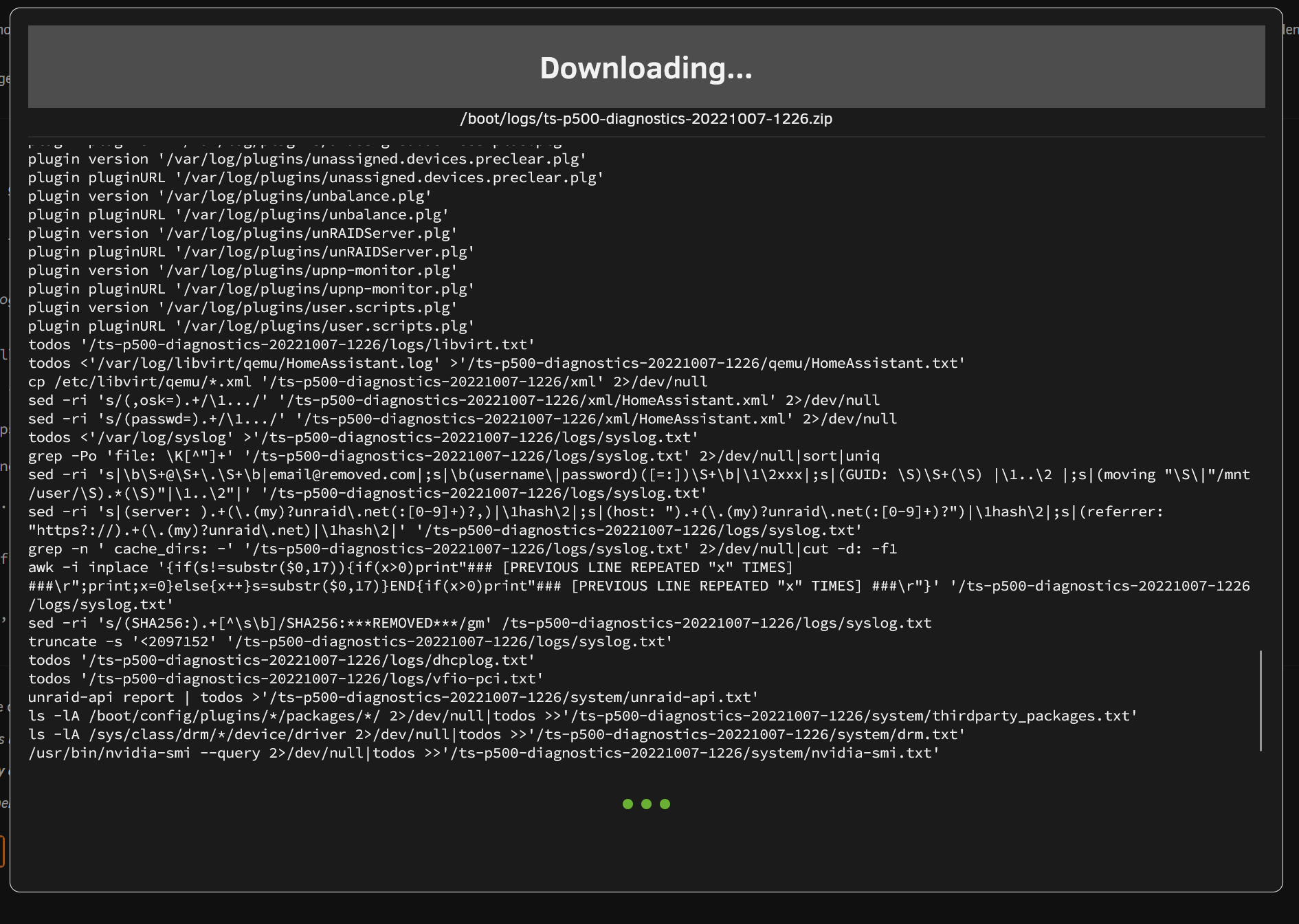

October 7, 20224 yr Few day i've receive read error from one of my HDD and i've replace and rebuild the drive sucessfully. But after that i notice that the array not start after rebuild so i reboot the server and i receive email from snmp prompt there error. The array keep unable to start after that. and i notice that there is and Error at the bottom left status Array Stopped. Stale Configuration. I've notice there is an update from 6.11.0 to 6.11.1 and hope that will fix the issue and after updated the server from 6.11.0 to 6.11.1 and seems the Array start but im still getting snmp error after the server rebooted. This is the 4 email i keep receiving each time after the server rebooted. I try to generate the Diagnostice file but fail to finish generate so i capture the Syslog as attach below. Server Name: TS-P500 IP Address: 10.10.2.10 Date/Time: Oct 7 12:10:42 BUG: unable to handle page fault for address: ffffc90008012200 Server Name: TS-P500 IP Address: 10.10.2.10 Date/Time: Oct 7 12:10:42 #PF: supervisor write access in kernel mode Server Name: TS-P500 IP Address: 10.10.2.10 Date/Time: Oct 7 12:10:42 #PF: error_code(0x0002) - not-present page Server Name: TS-P500 IP Address: 10.10.2.10 Date/Time: Oct 7 12:10:48 BUG: unable to handle page fault for address: ffffc900028cfb48 Server Name: TS-P500 IP Address: 10.10.2.10 Date/Time: Oct 7 12:10:48 #PF: supervisor read access in kernel mode Server Name: TS-P500 IP Address: 10.10.2.10 Date/Time: Oct 7 12:10:48 #PF: error_code(0x0000) - not-present page text error warn system array login Oct 7 12:10:48 TS-P500 kernel: ? uvm_global_init+0x10d/0x770 [nvidia_uvm] Oct 7 12:10:48 TS-P500 kernel: ? uvm_init+0xe/0x2a3 [nvidia_uvm] Oct 7 12:10:48 TS-P500 kernel: ? uvm_init_entry+0x82/0x1000 [nvidia_uvm] Oct 7 12:10:48 TS-P500 kernel: ? slab_post_alloc_hook+0x4d/0x15e Oct 7 12:10:48 TS-P500 kernel: ? 0xffffffffa06b7000 Oct 7 12:10:48 TS-P500 kernel: ? do_one_initcall+0x85/0x196 Oct 7 12:10:48 TS-P500 kernel: ? do_init_module+0x22/0x1d4 Oct 7 12:10:48 TS-P500 kernel: ? kmem_cache_alloc_trace+0x11e/0x149 Oct 7 12:10:48 TS-P500 kernel: ? do_init_module+0x4b/0x1d4 Oct 7 12:10:48 TS-P500 kernel: ? __do_sys_finit_module+0x9e/0xc8 Oct 7 12:10:48 TS-P500 kernel: ? do_syscall_64+0x6b/0x81 Oct 7 12:10:48 TS-P500 kernel: ? entry_SYSCALL_64_after_hwframe+0x63/0xcd Oct 7 12:10:48 TS-P500 kernel: </TASK> Oct 7 12:10:48 TS-P500 kernel: Modules linked in: nvidia_uvm(PO+) xt_CHECKSUM ipt_REJECT nf_reject_ipv4 ip6table_mangle ip6table_nat iptable_mangle vhost_net tun vhost vhost_iotlb tap veth xt_nat xt_tcpudp xt_conntrack xt_MASQUERADE nf_conntrack_netlink nfnetlink xfrm_user xfrm_algo xt_addrtype iptable_nat nf_nat nf_conntrack nf_defrag_ipv6 nf_defrag_ipv4 br_netfilter xfs nfsd auth_rpcgss oid_registry lockd grace sunrpc md_mod iscsi_tcp libiscsi_tcp libiscsi scsi_transport_iscsi lm75 regmap_i2c efivarfs ip6table_filter ip6_tables iptable_filter ip_tables x_tables af_packet 8021q garp mrp bridge stp llc bonding tls ipv6 e1000e nvidia_drm(PO) nvidia_modeset(PO) nvidia(PO) wmi_bmof intel_wmi_thunderbolt drm_kms_helper drm i2c_i801 backlight i2c_smbus x86_pkg_temp_thermal intel_powerclamp coretemp kvm_intel kvm crct10dif_pclmul crc32_pclmul crc32c_intel ghash_clmulni_intel aesni_intel crypto_simd cryptd rapl intel_cstate intel_uncore mpt3sas i2c_core syscopyarea raid_class sysfillrect tpm_tis tpm_tis_core Oct 7 12:10:48 TS-P500 kernel: sysimgblt ahci scsi_transport_sas fb_sys_fops tpm libahci wmi button unix [last unloaded: e1000e] Oct 7 12:10:48 TS-P500 kernel: CR2: ffffc900028cfb48 Oct 7 12:10:48 TS-P500 kernel: ---[ end trace 0000000000000000 ]--- Oct 7 12:10:48 TS-P500 kernel: RIP: 0010:os_mem_copy_custom+0x2c/0x5f [nvidia] Oct 7 12:10:48 TS-P500 kernel: Code: 44 00 00 83 fa 7f 49 89 f8 48 89 f9 76 0b 48 89 f8 48 09 f0 83 e0 03 74 06 89 d2 31 c0 eb 24 89 d1 83 e2 03 c1 e9 02 8b 3c 86 <41> 89 3c 80 48 ff c0 48 39 c8 75 f1 48 c1 e0 02 49 8d 0c 00 48 01 Oct 7 12:10:48 TS-P500 kernel: RSP: 0018:ffffc900028cf760 EFLAGS: 00010206 Oct 7 12:10:48 TS-P500 kernel: RAX: 0000000000000000 RBX: ffff8881d19fa0d8 RCX: 0000000000000200 Oct 7 12:10:48 TS-P500 kernel: RDX: 0000000000000000 RSI: ffff8881d3e2f008 RDI: 000000000000000c Oct 7 12:10:48 TS-P500 kernel: RBP: ffff8881d43f5be0 R08: ffffc90008012200 R09: 0000000000000000 Oct 7 12:10:48 TS-P500 kernel: R10: 0000000000000000 R11: ffff8881d50ce008 R12: 000000000000000c Oct 7 12:10:48 TS-P500 kernel: R13: ffff8881a895c008 R14: ffff8881d1168008 R15: ffff8881d3e2f010 Oct 7 12:10:48 TS-P500 kernel: FS: 000015304acfb740(0000) GS:ffff889fff600000(0000) knlGS:0000000000000000 Oct 7 12:10:48 TS-P500 kernel: CS: 0010 DS: 0000 ES: 0000 CR0: 0000000080050033 Oct 7 12:10:48 TS-P500 kernel: CR2: ffffc900028cfb48 CR3: 00000001d14d2006 CR4: 00000000001706f0 Oct 7 12:10:48 TS-P500 kernel: note: modprobe[10898] exited with preempt_count 1 Oct 7 12:10:48 TS-P500 kernel: br0: port 2(vnet0) entered blocking state Oct 7 12:10:48 TS-P500 kernel: br0: port 2(vnet0) entered disabled state Oct 7 12:10:48 TS-P500 kernel: device vnet0 entered promiscuous mode Oct 7 12:10:48 TS-P500 kernel: br0: port 2(vnet0) entered blocking state Oct 7 12:10:48 TS-P500 kernel: br0: port 2(vnet0) entered forwarding state Oct 7 12:10:48 TS-P500 avahi-daemon[9090]: Joining mDNS multicast group on interface veth774d568.IPv6 with address fe80::1447:d6ff:fe8e:4a92. Oct 7 12:10:48 TS-P500 avahi-daemon[9090]: New relevant interface veth774d568.IPv6 for mDNS. Oct 7 12:10:48 TS-P500 avahi-daemon[9090]: Registering new address record for fe80::1447:d6ff:fe8e:4a92 on veth774d568.*. Oct 7 12:10:49 TS-P500 kernel: bond0: (slave eth0): speed changed to 0 on port 1 Oct 7 12:10:49 TS-P500 kernel: bond0: (slave eth0): link status definitely down, disabling slave Oct 7 12:10:49 TS-P500 avahi-daemon[9090]: Joining mDNS multicast group on interface vnet0.IPv6 with address fe80::fc54:ff:feb3:c2e1. Oct 7 12:10:49 TS-P500 avahi-daemon[9090]: New relevant interface vnet0.IPv6 for mDNS. Oct 7 12:10:49 TS-P500 avahi-daemon[9090]: Registering new address record for fe80::fc54:ff:feb3:c2e1 on vnet0.*. Oct 7 12:10:50 TS-P500 tips.and.tweaks: Tweaks Applied Oct 7 12:10:50 TS-P500 unassigned.devices: Mounting 'Auto Mount' Remote Shares... Oct 7 12:10:50 TS-P500 sudo: root : PWD=/ ; USER=root ; COMMAND=/bin/bash -c /usr/local/emhttp/plugins/unbalance/unbalance -port 6237 Oct 7 12:10:50 TS-P500 sudo: pam_unix(sudo:session): session opened for user root(uid=0) by (uid=0) Oct 7 12:10:52 TS-P500 kernel: e1000e 0000:00:19.0 eth0: NIC Link is Up 1000 Mbps Full Duplex, Flow Control: None Oct 7 12:10:52 TS-P500 kernel: bond0: (slave eth0): link status definitely up, 1000 Mbps full duplex Oct 7 12:11:01 TS-P500 sSMTP[11516]: Creating SSL connection to host Oct 7 12:11:02 TS-P500 sSMTP[11516]: SSL connection using TLS_AES_256_GCM_SHA384 Oct 7 12:11:02 TS-P500 nmbd[9049]: [2022/10/07 12:11:02.468373, 0] ../../source3/nmbd/nmbd_become_lmb.c:398(become_local_master_stage2) Oct 7 12:11:02 TS-P500 nmbd[9049]: ***** Oct 7 12:11:02 TS-P500 nmbd[9049]: Oct 7 12:11:02 TS-P500 nmbd[9049]: Samba name server TS-P500 is now a local master browser for workgroup WORKGROUP on subnet 10.10.2.10 Oct 7 12:11:02 TS-P500 nmbd[9049]: Oct 7 12:11:02 TS-P500 nmbd[9049]: ***** Oct 7 12:11:03 TS-P500 sSMTP[11516]: Authorization failed (535 5.7.8 https://support.google.com/mail/?p=BadCredentials i11-20020a170902cf0b00b00176e8f85147sm441536plg.83 - gsmtp) Oct 7 12:12:41 TS-P500 ntpd[1720]: kernel reports TIME_ERROR: 0x41: Clock Unsynchronized Oct 7 12:12:59 TS-P500 kernel: usb 4-5.1: new SuperSpeed USB device number 3 using xhci_hcd Oct 7 12:12:59 TS-P500 kernel: usb-storage 4-5.1:1.0: USB Mass Storage device detected Oct 7 12:12:59 TS-P500 kernel: scsi host10: usb-storage 4-5.1:1.0 Oct 7 12:13:00 TS-P500 kernel: scsi 10:0:0:0: Direct-Access TO Exter nal USB 3.0 0104 PQ: 0 ANSI: 6 Oct 7 12:13:00 TS-P500 kernel: sd 10:0:0:0: Attached scsi generic sg9 type 0 Oct 7 12:13:00 TS-P500 kernel: sd 10:0:0:0: [sdj] 976773168 512-byte logical blocks: (500 GB/466 GiB) Oct 7 12:13:00 TS-P500 kernel: sd 10:0:0:0: [sdj] Write Protect is off Oct 7 12:13:00 TS-P500 kernel: sd 10:0:0:0: [sdj] Mode Sense: 47 00 00 08 Oct 7 12:13:00 TS-P500 kernel: sd 10:0:0:0: [sdj] Write cache: enabled, read cache: enabled, doesn't support DPO or FUA Oct 7 12:13:00 TS-P500 kernel: sdj: sdj1 Oct 7 12:13:00 TS-P500 kernel: sd 10:0:0:0: [sdj] Attached SCSI disk Oct 7 12:13:01 TS-P500 unassigned.devices: Disk with ID 'TO_Exter_nal_USB_3.0_2015033100081-0:0 (sdj)' is not set to auto mount. Oct 7 12:16:12 TS-P500 nmbd[9049]: [2022/10/07 12:16:12.538742, 0] ../../source3/nmbd/nmbd_become_lmb.c:398(become_local_master_stage2) Oct 7 12:16:12 TS-P500 nmbd[9049]: ***** Oct 7 12:16:12 TS-P500 nmbd[9049]: Oct 7 12:16:12 TS-P500 nmbd[9049]: Samba name server TS-P500 is now a local master browser for workgroup WORKGROUP on subnet 192.168.122.1 Oct 7 12:16:12 TS-P500 nmbd[9049]: Oct 7 12:16:12 TS-P500 nmbd[9049]: ***** Oct 7 12:16:12 TS-P500 nmbd[9049]: [2022/10/07 12:16:12.538884, 0] ../../source3/nmbd/nmbd_become_lmb.c:398(become_local_master_stage2) Oct 7 12:16:12 TS-P500 nmbd[9049]: ***** Oct 7 12:16:12 TS-P500 nmbd[9049]: Oct 7 12:16:12 TS-P500 nmbd[9049]: Samba name server TS-P500 is now a local master browser for workgroup WORKGROUP on subnet 172.17.0.1 Oct 7 12:16:12 TS-P500 nmbd[9049]: Oct 7 12:16:12 TS-P500 nmbd[9049]: ***** Oct 7 12:20:00 TS-P500 root: Fix Common Problems Version 2022.09.26 Oct 7 12:22:23 TS-P500 root: Fix Common Problems: Warning: Complex bonding mode on eth0 ** Ignored Oct 7 12:22:24 TS-P500 root: Fix Common Problems: Warning: Share Download set to use pool cache_download, but files / folders exist on the cache pool Oct 7 12:22:24 TS-P500 sSMTP[32157]: Creating SSL connection to host Oct 7 12:22:25 TS-P500 sSMTP[32157]: SSL connection using TLS_AES_256_GCM_SHA384 Oct 7 12:22:26 TS-P500 sSMTP[32157]: Authorization failed (535 5.7.8 https://support.google.com/mail/?p=BadCredentials x24-20020aa79418000000b00537f16e25d3sm484447pfo.75 - gsmtp) Oct 7 12:32:57 TS-P500 emhttpd: TO_Exter_nal_USB_3.0_2015033100081-0:0 (sdj) 512 976773168 Oct 7 12:32:57 TS-P500 emhttpd: read SMART /dev/sdj Edited October 7, 20224 yr by feins
