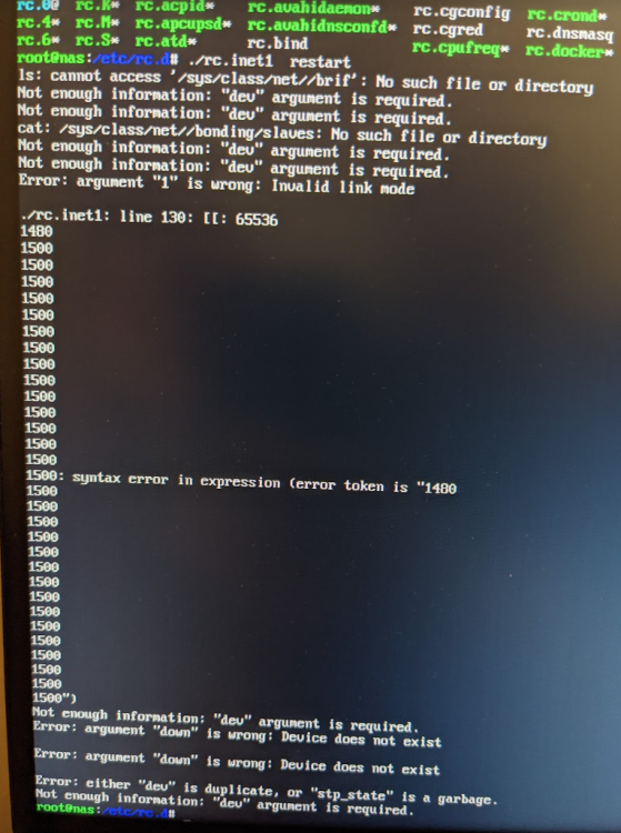

hi @ljm42 I'm a new unraid user, and just setup a new server; I also ran into the same issue as everyone described above.
When I click the "Inactive" toggle switch it fails to stay enabled for `Tunnel wg0`.
Here is my output:
root@nas:/tmp# php testnet.php
Array
    [DHCP_KEEPRESOLV] => yes
    [DNS_SERVER1] => 1.1.1.1
    [DNS_SERVER2] =>
    [DNS_SERVER3] =>
    [DHCP6_KEEPRESOLV] => no
    [BONDING] => yes
    [BONDNAME] =>
    [BONDNICS] => eth0,eth1,eth2,eth3
    [BONDING_MODE] => 1
    [BONDING_MIIMON] => 100
    [BRIDGING] => yes
    [BRNAME] =>
    [BRNICS] => bond0
    [BRSTP] => 0
    [BRFD] => 0
    [DESCRIPTION:0] =>
    [PROTOCOL:0] =>
    [USE_DHCP:0] => no
    [IPADDR:0] => 192.168.0.8
    [NETMASK:0] => 255.255.255.0
    [GATEWAY:0] => 192.168.0.1
    [METRIC:0] =>
    [USE_DHCP6:0] =>
    [IPADDR6:0] =>
    [NETMASK6:0] =>
    [GATEWAY6:0] =>
    [METRIC6:0] =>
    [PRIVACY6:0] =>
    [MTU] =>
    [TYPE] => access
BRIDGING: 'yes'
BRNAME: ''
BONDING: 'yes'
BONDNAME: ''
ethX: 'eth0'
device: ''
HEY dev is empty!
root@nas:/tmp#

On 10/9/2022 at 8:39 AM, erak said:
Thanks for this find. I had the same issue after updating. After removing " dev " from line 12 and 15, and "dev wg0 " from line 11 it's up and running again. These are the exact differences from the old configuration.
This remedy worked; The downside is that you need to repeat the edit anytime you change any tunnel related settings
Here is my output:
Array
    [DNS_SERVER2] =>
    [DNS_SERVER3] =>
    [BONDING] => yes
    [BONDNAME] =>
    [BONDING_MODE] => 1
    [BRIDGING] => yes
    [BRNAME] =>
    [BRNICS] => bond0
    [BRSTP] => 0
    [BRFD] => 0
    [DESCRIPTION:0] =>
    [PROTOCOL:0] =>
    [USE_DHCP:0] => no
    [METRIC:0] =>
    [USE_DHCP6:0] =>
    [IPADDR6:0] =>
    [NETMASK6:0] =>
    [GATEWAY6:0] =>
    [METRIC6:0] =>
    [PRIVACY6:0] =>
    [MTU] =>
    [TYPE] => access
BRIDGING: 'yes'
BRNAME: ''
BONDING: 'yes'
BONDNAME: ''
ethX: 'eth0'
device: ''
HEY dev is empty!
root@nas:/tmp#
Thank you, this is the condition I was looking for. Would you please upload your diagnostics.zip file (from Tools -> Diagnostics). I need to try and replicate this.
